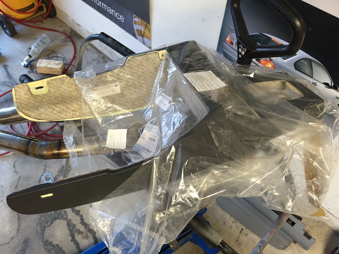

                              This morning I was just minding my own business sitting at the computer nursing a headache and decided to pop on Houston Craigslist and type in "BMW E30" as I often do. Today the first search result was a guy selling a New Old Stock front center console. The same console I've been looking to find for months.
                              Needless to say I sent him an email and we met up in the afternoon to make the exchange. Very happy to have caught it and got it!
                              Brand new still in the dealer bag, order fulfillment from BMW AG in Aug'13. QC Inspection tag on the part indicates an Aug'98 part production.
                              Side by side with the decent condition used one I'd picked up from OMG Motorsports just a few weeks prior.
                              Taking the air saw and utility knife to an NLA console was a little nerve racking.... Switches cut out and shoulder notched to clean the airbag knee bolster bracket:
                              I decided to leave out the window circuit breaker even though its mint/new as honestly I feel its a useless item and it clutters the console. In its absence you just connect the two wires with a 15amp fuse.
