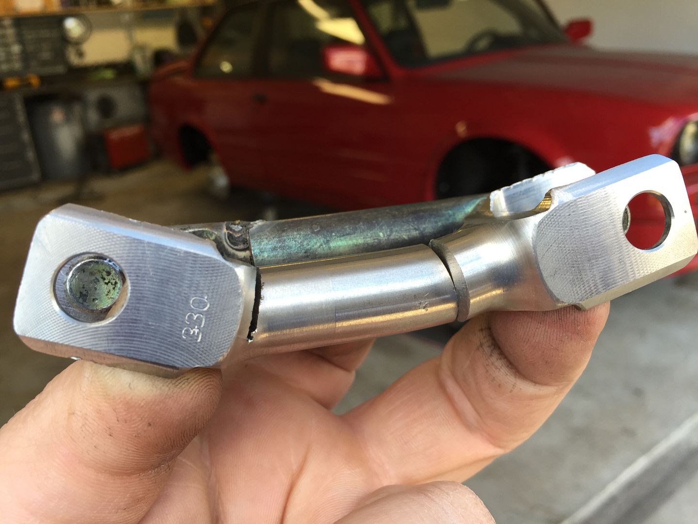

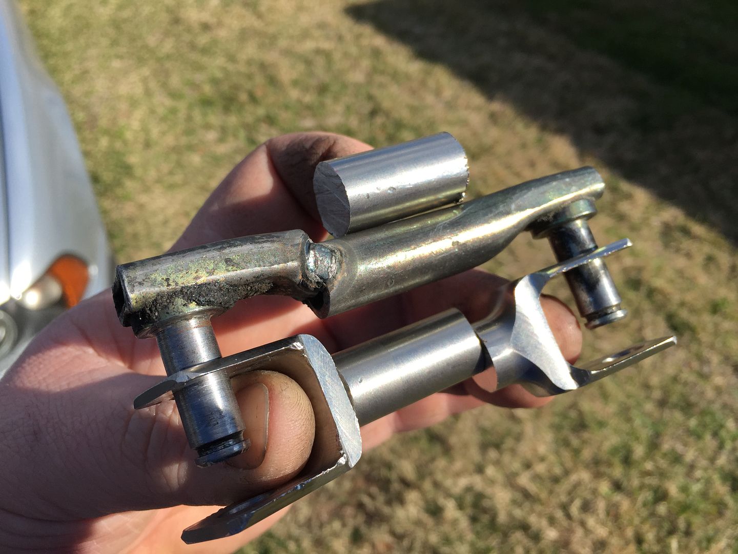

    I took care of the shifter linkage fabrication yesterday, although the shift lever provided works well I knew that even the shortest DSSR UUC offers would be A. Too long. B. Not the right shape.
    I started from a factory selector rod. Cutting it to the correct length and offset via trial and error until I had the lever centered in the opening and the gears where I wanted them.
    After that I cut into the DSSR, notching it for angle and cutting the excess length out of it. It was welded up as pictured above, then ground down until it was nice and clean looking. I forgot to take a finished picture though.

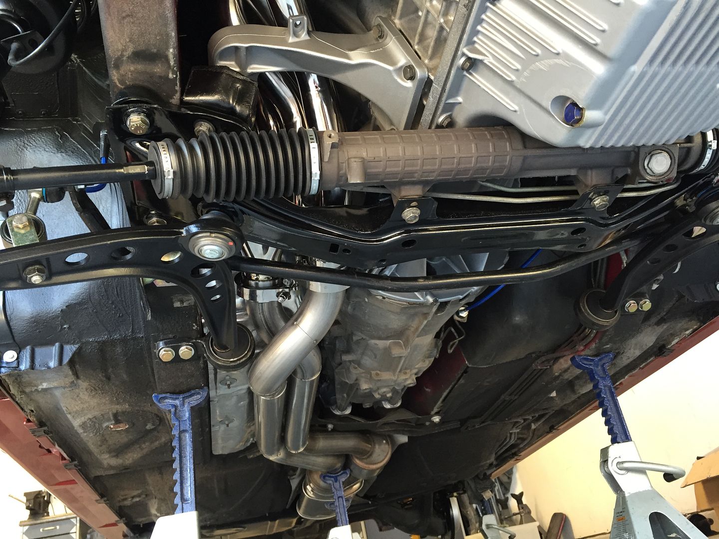

    I spent the rest of the evening and some of today working on the exhaust fabrication and I have the forward section complete now, tacked and waiting to get dropped off to TIG together.

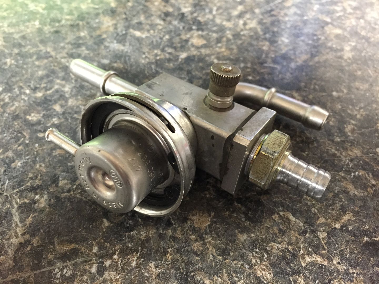

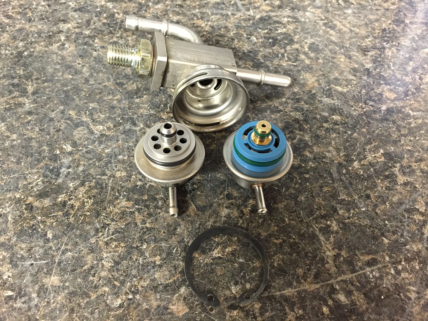

        Next order of business was fooling with an idea I had come up with earlier in the day. For weeks I've been trying to figure out what to do for the fuel filter and fuel pressure regulator. The MS43 cars all have a long fuel filter with intergrated fuel pressure regulator. I had attempted to mock this up in the factory location back by the subframe. While the filter "fit" there simply was not enough clearance at either end for proper connection of fuel lines and they would have been pressing against the body. Cannot have that.
        I looked for awhile to try to find a similar filter that was shorter, again with an integrated 3.5bar FPR but came up empty handed.
        The other obvious option was to do as whatshisdickface did and toss the filter/FPR assembly in the engine bay:
        This of course looks like crap, and it makes servicing the filter a bit of a hassle. Just couldn't have this either.

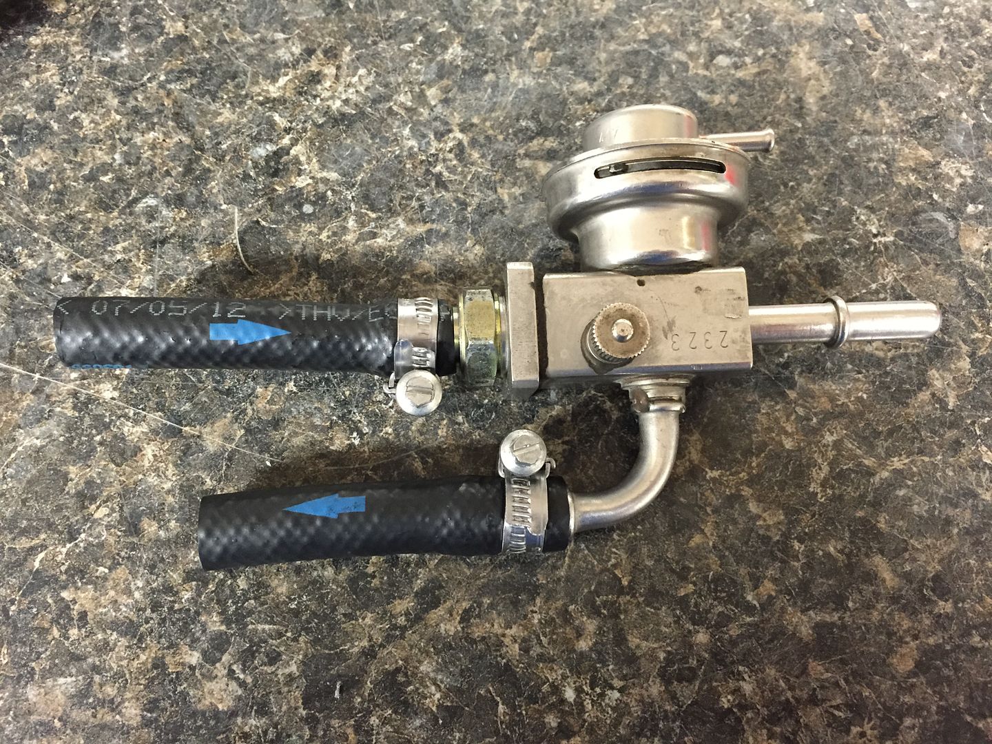

        Today I was thinking and I remembered that the E46 M3 had a similar filter, but the FPR was a stand alone outboard assembly. A quick peak under a junked M3 at work found the FPR housing and I removed it from the car. The only problem I saw was that the S54 runs a 5bar FPR, where as MS43 cars run a 3.5bar.
        I already had a brand new fuel filter for the MS43 cars, and I was betting on the FPR's being compatible in shape/size. I pulled both FPR's and while constructed a little different the critical dimentions are the same!
        The threaded fitting is the fuel inlet, the straight fitting is the fuel outlet, and the 90 degree fitting is fuel return to tank. I can install this little guy on the frame rail where the fuel hard lines come into the engine bay, handling the inlet and return at the frame rail. I then also get to run a double ended quick disconnect fuel line like from newer BMW's. I'll just need to run a vacuum line off the intake boot F connector down to the FBR, again just like it would be in an MS43 car.
        Oh.. one other problem being the threaded inlet fitting. I probably could find a threaded barb to install onto the FPR housing (I believe it is M12x1.5) but I elected to take care of that myself.
        I pulled the threaded fitting and chocked it in my drill. I held the drill in my vice and locked the trigger on. 2 minutes with a small file removed the threads and shaped them into a barb :-)
        This is now ready to install, but I'll come back to that later.

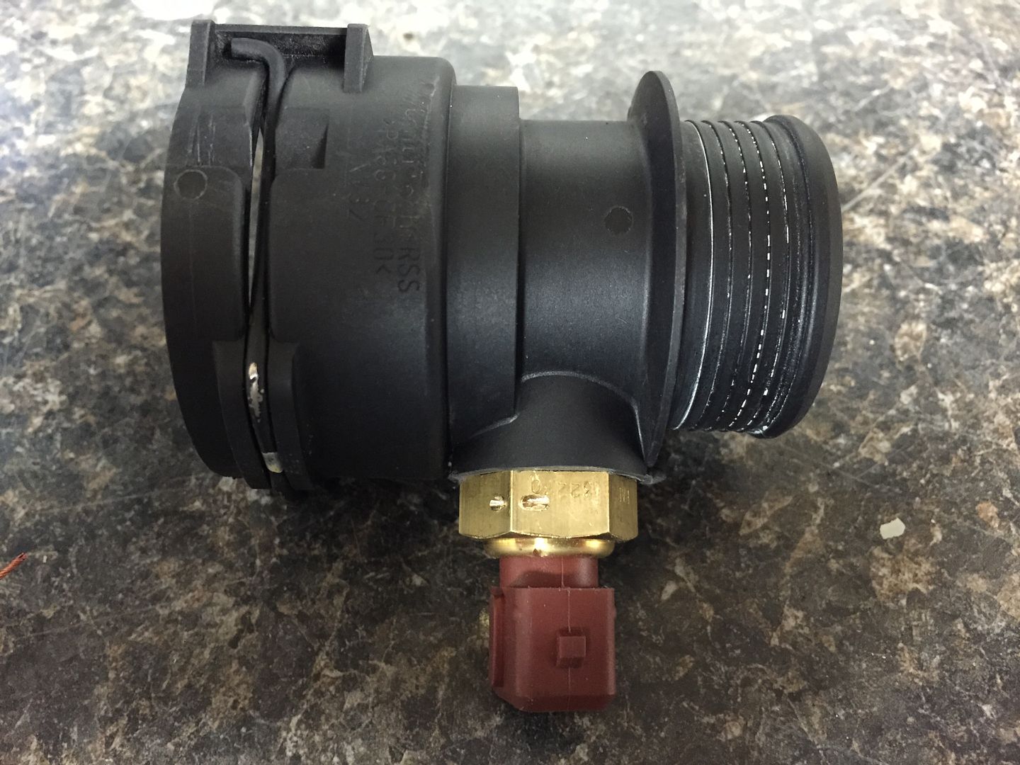

        Next order of business was sorting the temperature sensor for the instrument cluster gauge. Again whatshisdickface had installed this straight into the engine block in the block drain location. While it does thread in the sensor is too long as you are left to use several crush rings to space it out. Another halfass thing I just didn't want to do, and the bottom of the block isn't a good place to be taking an engines coolant temp from anyway.
        I decided it would be better placed on the top of the engine, albeit in sight, but at the thermostat outlet. Coolant temperature at this point should not fluctuate lower than the temperature in the cylinder head considering the volume of coolant flowing. The fitting is from a E46/E39 lower hose with the fan temperature sensor fitting.

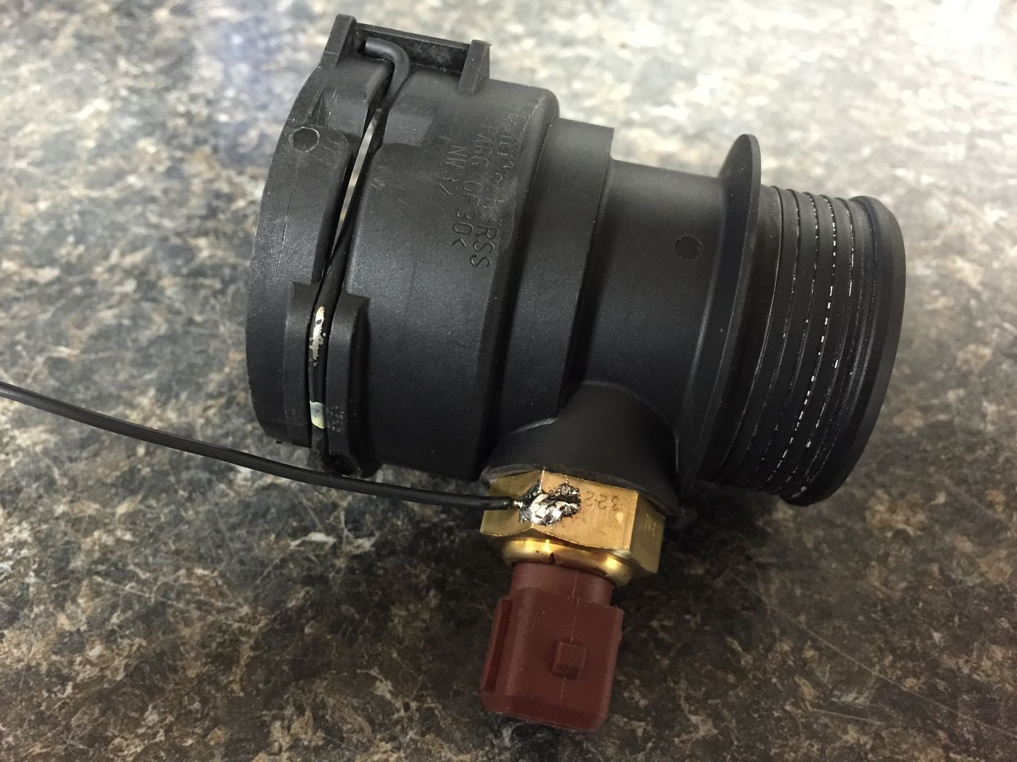

        I cut the fitting down and threaded the plastic to M14x1.5 for the E30 gauge sensor. I coated the threads with epoxy for good measure. This did leave one small issue, being that plastic is a really poor conductor of electricity and this particular sensor grounds through the sensor body. A ground strap would need to be affixed to the sensor in some manner and attached to the engine.
        I drilled a small hole through one of the corners on the sensor to attach a wire to.
        I tinned a wire, then inserted it in that hole. After melting some flux into the area I fed some solder in and now its permanently attached.

          Some good ideas here, I will have to do some similar things. I'll be using the E46 M4 FPR as is, haven't really decided if I want to mount it with the filter or not. I'm thinking maybe just sticking to the stock E30 fuel filter and mounting the FPR separately like you did is a good idea - hackjobtt's installation looks terrible and that's a lot of bulk in the engine bay I don't want to deal with..

                          I didn't do much this evening except mount the FPR with its directionally marked hoses. Figured it might help the next guy figure it out.
