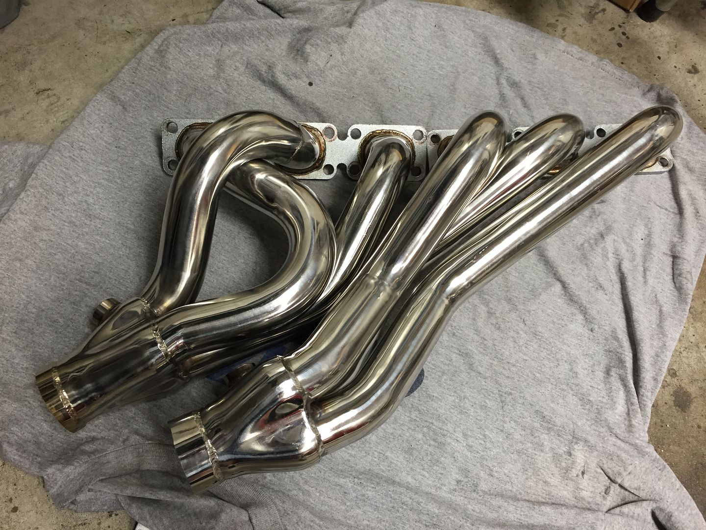

    Where was the headers touching at? Motor mount?
      They touch the firewall mainly, where you foot would go as a passenger. That and the secondaries are just bent like shit, pointing down and into one another rather then level with the body and straight back.

              Here are those eBay headers again, this time lopped off at the collectors. I'll be welding some nice v-bands to them and fabricating the downpipes from there.

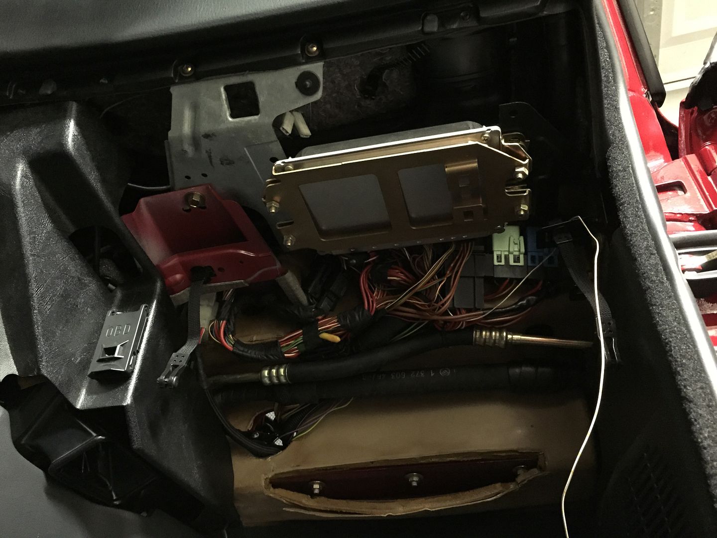

              I spent most of yesterday evening, and much of tonight trying to cram 10 pounds of shit into a 5 pound hole. IE the MS43 DME and the associated wiring that needs to be out of the engine bay. The E46/E39 have a nice plastic ebox with a sealed lid that all of this mess is haphazardly tossed into. I played with a number of configurations until I settled on the way it is now. The challenge wasn't just getting it all to look decent but also to fit in such a way that the wires would not be chaffing on metal brackets and the plastic covers etc that conceal all of this still fit properly.
              Its largely untangled, and everything flows sensibly. The DME bracket is the stock M42 318iS one original to the car that pretty much fits the MS43 Siemens DME, enough to hold it in place anyway.
              I also decided to place the OBDII connector on the left so it is accessible when you open the glove box. The defacto standard in the automotive world seems to be the drivers foot well but that has always annoyed me when you want to drive the car while watching real time data or data logging.... as you end up with a cable running around the drivers legs.

                    Good call on the OBDII plug location.
