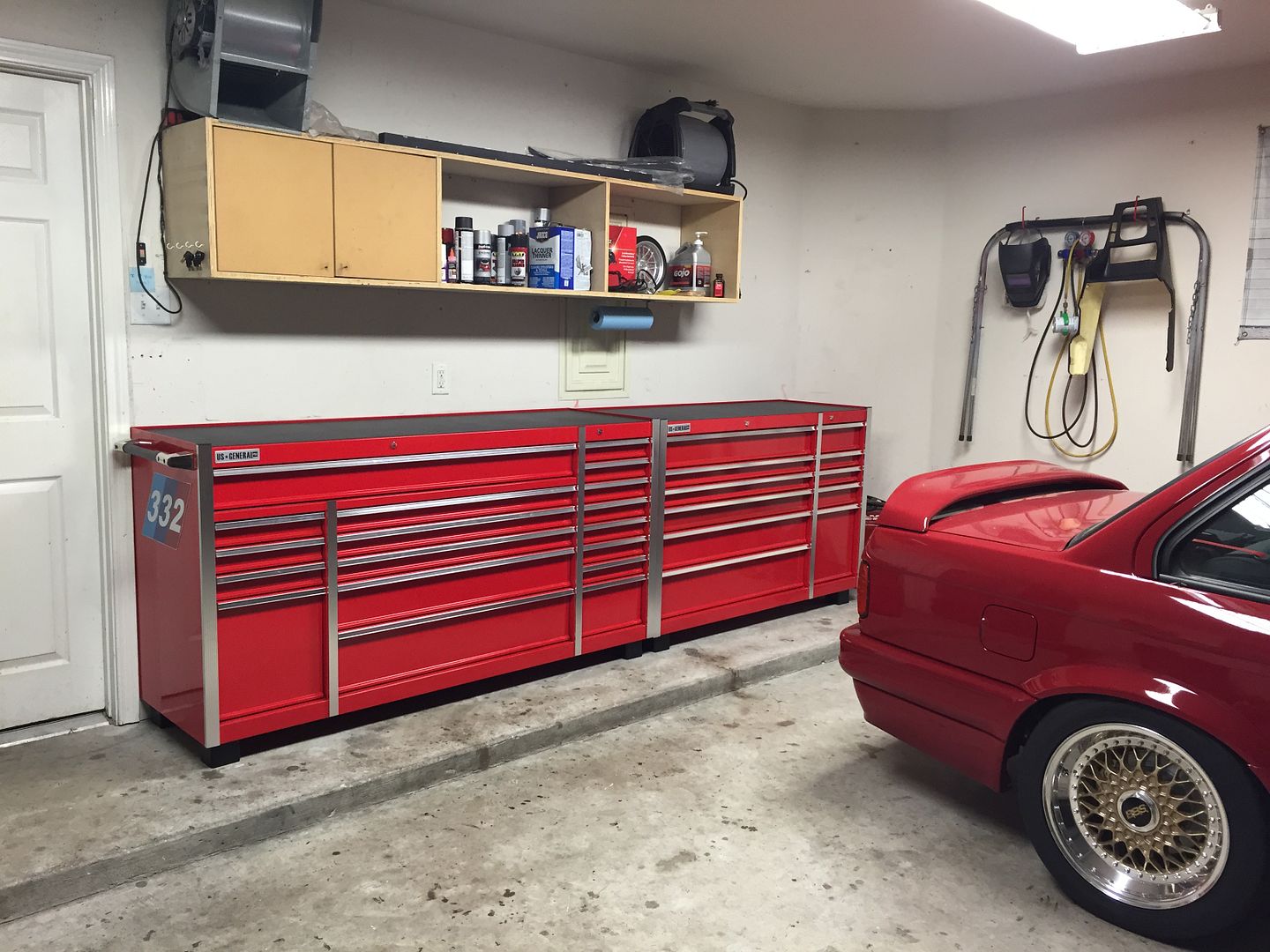

                            Alright well that is just dandy, I'm so glad a truck brand box elitist showed up to shit on my perfectly fine, functional and nice looking HF boxes that are a tremendous upgrade over the Sams/Costco Taiwan box I've used for the last 8+ years without a single problem except having outgrown it.
                            Iiiiiiin other news, I took the casters off today and lowered the boxes down onto their new feet. The feet are cut from 4" x 4" 1/4" wall square steel tubing. This seemed like it would be pretty straight forward but lowering one side at a time without trapping the jack was a bit of a conundrum.
                            I of course wanted the boxes as low as possible, and my AC Hydraulics DK13HLQ has a 3" saddle height.
                            For the 72" box I cut 4 feet 3.5" long.
                            For the 56" box I cut 4 feet 3.75" long, as the caster mounts are offset 1/4" higher up into the box chassis.
                            I shall need to shim the inside feet of the 56" box to get it perfectly level aside the 72". I cut the feet as square as possible but the chop saw did have some walk/deflection as it cut through the 4" square tube leaving me with a 1/8" step between the 2 boxes.
                            It looks worlds better now set up side by side and lower down to the floor. With that step on the floor as is typical of residential garages the boxes were just too tall for my liking.
                            The upper cabinet is going to get lifted up about 6" higher, and moved to the left until it butts against the entry door molding. Each of those 3 sections is 31", so after its in position I will add one more section to it bringing its overall length very close to the length of the boxes/workbench. When that is done I'll go ahead and make another pair of doors so both out side compartments have doors and the middle two remain open.
                            I think I'll paint match the upper cabinets to the boxes and then call it a day at that.
                            Oh, and this box siamesing nets me a 128" tool box work surface.
                            SnapOn also offers a 120" EPIQ tool box. It's a cool $21,000.
                            I paid $1099 for the 72"
                            I paid $699 for the 56"
                            That is $1798 (11.6 of these setups for the one 120" SnapOn box)
                            I collected $420 for my 8+ year old stainless 44" box.
                            Leaving me out of pocket $1378
                            Total number of complaints: Zero.
                              I am not as you describe or assume, all my boxes are 20+ year old Sears units with 2 of them seeing daily professional use for 15+ years.
                              Your setup looks nice with the heights evened out.

                                Well fine then.
                                Thank you.
                                I'm very happy with the setup now. As I said above the drawer slides feel sooo much nicer, smoother with even just a little weight in them. They feel.... kinda eh empty in the store, but firm/smooth up once loaded.
