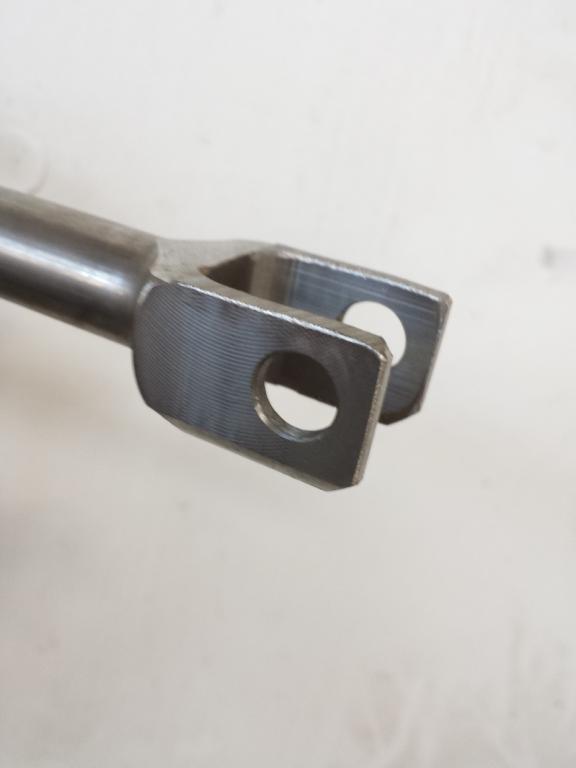

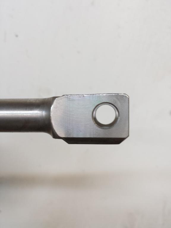

            Very little grinding required. Here's a side pic of the end before grinding:
            And here's a side pic after grinding:

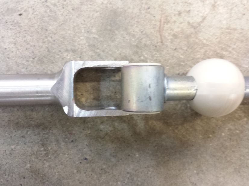

            Other than that, the only little wrinkle is that the plastic bushing built into the z3 shift lever is too wide to fit into the DSSR. You can kind of see in this pic how the lever won't fit into the DSSR.
            A flat file and a few minutes is all it took to remove enough of the plastic so that the bushing was flush with the metal. It fits very tight, but without binding. I also took a file to the selector rod coupling and removed a very very small amount of material so that the coupling fit very tightly into the DSSR but without binding.

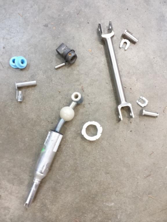

              After the grinding/filing, it was pretty much just putting everything back together. Here's a pic of all the old parts:
              And all the new stuff before it went in:

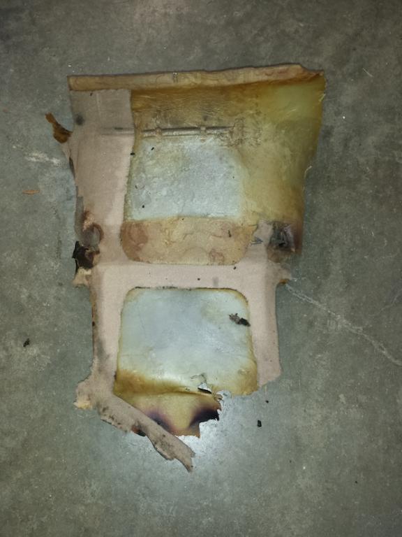

                              Found some moisture under the front driver side carpet - guess it must be coolant. The foam under there was pretty wet and I couldn't let that go. Carpet was OK but not great, so... got a new OEM carpet.
                              After the carpet showed up I wanted to replace it "the right way" and not cut around the heater core. So, started ripping things out. Here's where it sits right now:

                              All to get out this little piece of carpet:
