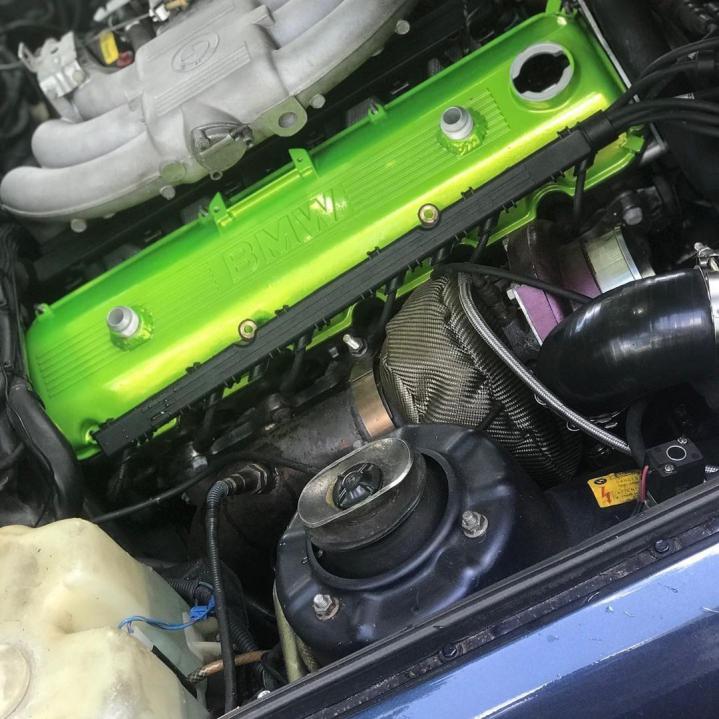

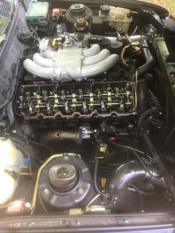

                    Enjoy some updates on this vehicle
                    You can see the build here:
                    Instagram: Peepshit_Studios
                    It's receiving some welding for turbo lines on the valve cover and powder coated acid yellow
                    Will be going through all the hoses, fittings and bolts to sort out some leaks. Going to get extended studs for some of the bolts that have been backing out

                      New Owner/ Build looks like it will be a fun trial and error of turbocharging an IX. Theres a few guys who are a few steps ahead, Id look at what they have going on before going too far down this path! Keep the thread updated!
