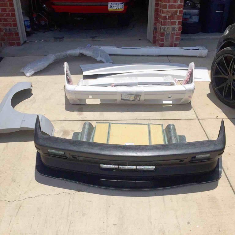

                    So small update
                    Yesterday I bought the full M3 Kit from vivid racing they had posted in the for sale area hopefully have it here next week I'll throw up some pictures when everything comes in. I was going to just do flares but couldn't pass up the deal

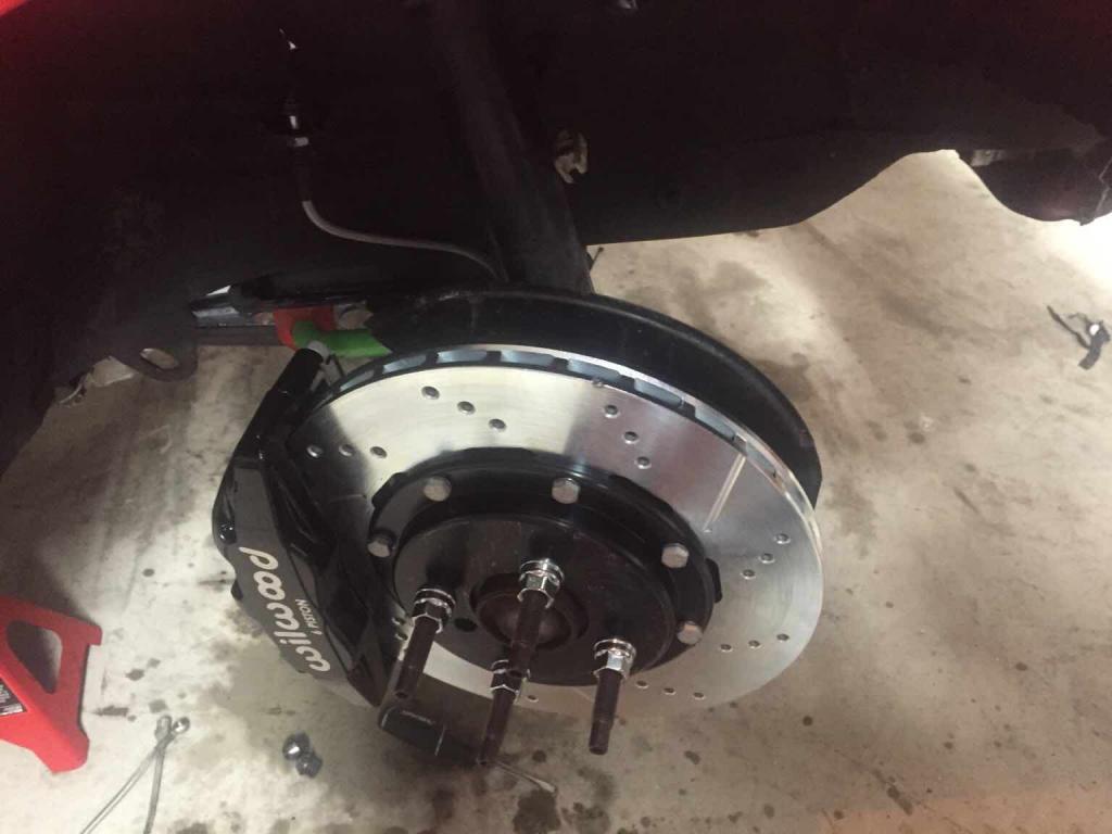

                      Brake showed up

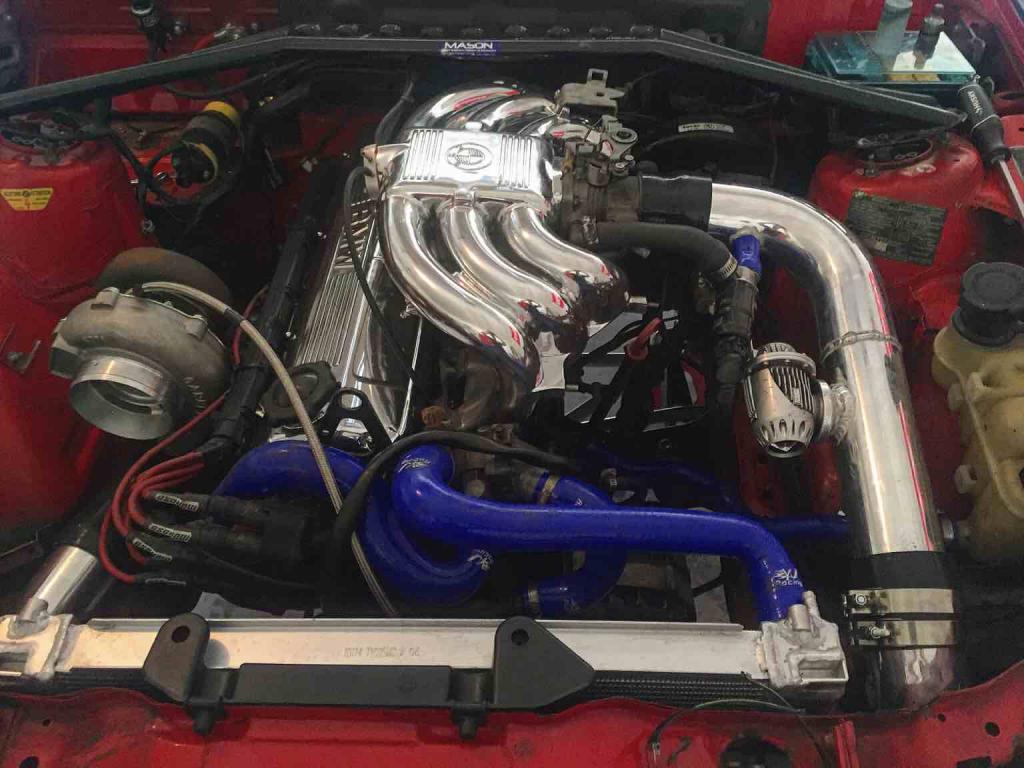

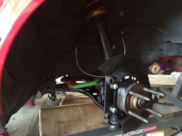

                        Everything's back together waiting on the oil feed line to be made and then I can start it. The shop that will be making the exhaust can't get to it till the 12th. So gonna have some free time. Debating on dropping the rear and doing all the bushings or waiting till it gets back. Also small note on the IE Wilwood big brake kit.
                        Now for guys not running studs I don't think you will have this problem.
                        The lip on the wheel stud that prevents the stud from treading threw. Doesn't allow the rotor to sit flush. Took me some head scratching to catch it at first but then I just used a step bit and made the holes larger to fit. Kinda one of them moments where your like wtf but all good.
                        Also started ordering everything needed to start installing the Flossman M3 front clip. If anyone actually reading or following this has done a actual M3 body panel swap. Please be my new best friend and allow me to be a pain in your ass lol

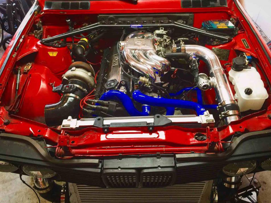

                            #43
                            Yeah buddy

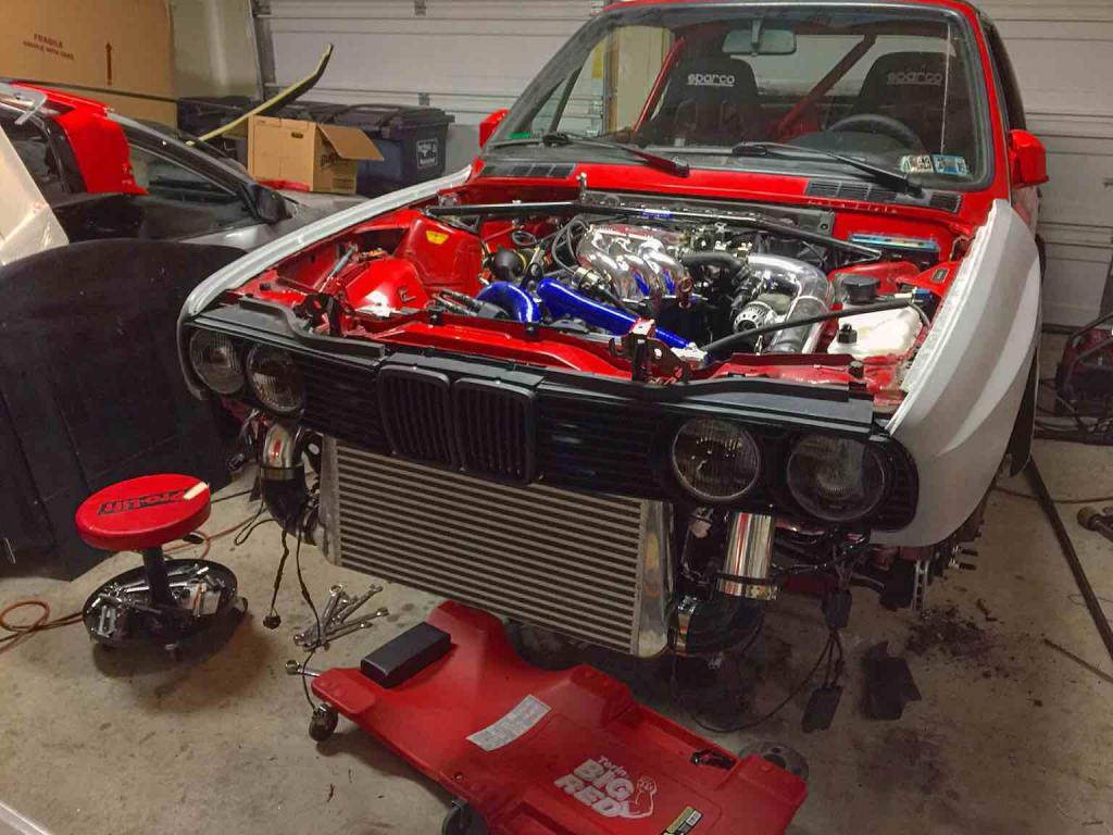

                                #45
                                So just sat the fenders on there. They are gonna have to be cut around the side skirt area. I'm not handling any of this just wanted to see a idea of how it would look. Can't wait till it goes to the body shop
