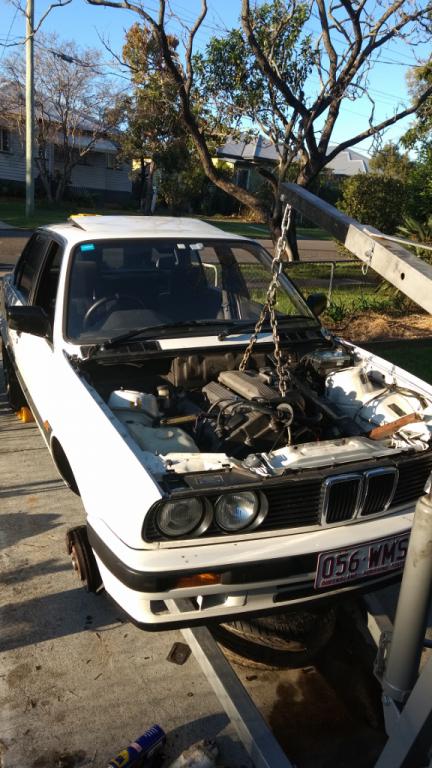

    The plan was always to swap an engine into the car and after my ownership of a 318is I couldn't get the thought of having another m42 powered e30 out of my head so decided that was the route to go. Also happens to be a fair bit cheaper than most other swaps. I kept my eye out for something and ended up buying a complete package (motor, box, loom, ecu, driveshaft and exhaust) out from a rusty car for 1400.
    Cleared my schedule for a weekend and me and a mate got to work.
Name:	IMG_20160924_164426713 (576x1024).jpg
    Managed to pull the old motor out and get the new one in with 90% of the work done in one day. Next morning we got up and worked on getting the ignition stuff in, the rear section of exhaust on and generally doing the little things we forgot.

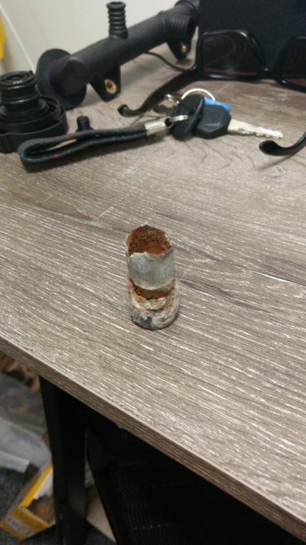

    To cut a long story short, I drove the car for 2 days without a problem. I then turned the heater on and 5 minutes later noticed the motor getting a little bit hot. nothing was making it cooler so I pulled over and looked into an empty overflow tank. tried filling it and found a large stream of water coming from the rear of the head. Limped it to my mates house, pulled the intake off and found this.
Name:	IMG_20161001_175209461 (576x1024).jpg
    motor must have sat long enough for the coolant to do some damage. I've managed to do some dodgy repairs by shoving a tight rubber hose into it and that seems to hold. I'll try and find a better permanent solution soon.

    Anyway thanks for looking and does anyone have any idea what to replace this with?

    The last couple of weeks I've been slowly getting stuff done. Tapped threads into the head so I could use a plug to solve the corroded head issue. Blocked the throttle body heater on the head and plastic coolant pipe and also the heater inlet on the pipe. Its pretty ghetto at the moment but I'll work out a better solution.

      Nice upgrade from a worn M40 I'd imagine. Really your only option for replacing that corroded nipple without sending the head off to be machined and have something brazed in is screwing in a pipe fitting that's the right size. Are you driving it without the proper fan shroud? The M42's fan is too far from the radiator to do much good without it.

        Yeah I considered that but i live in a hot climate so decided that blocking off the heater is just as easy. There are fittings at the local parts store that are the same size with an outlet so I always have the option.
