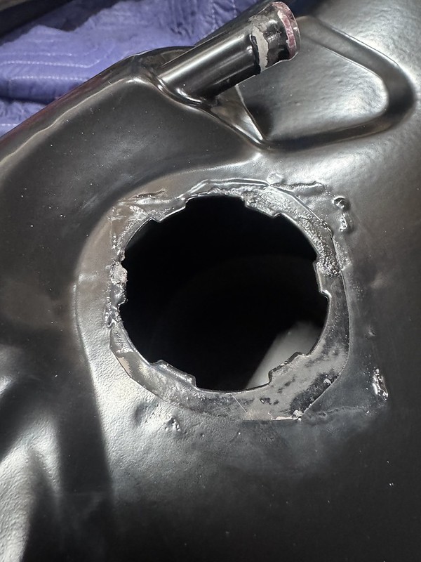

                      Coming along! Assembling all of this stuff on the ground is pretty funny. I have nice fill/drain plugs I forgot to install before you yell at me for painting over them
                      Untitled by bimmertown, on Flickr
                      Powder guy really finessed the tape work. I had to redo this and every other taped area in a fuel resistant paint, should've just painted the tank myself.
                      Bought a new Genuine supply hose, used Gates Barricade 27348 for the tank line to pump, and Cohline 2134.0400 for small plastic Evap connections. I have new evap hoses as well for when it goes back together. I unfortunately found rust that needs to be repaired in the passenger rear wheel well so I'm going to have to take the car up to Jake's over winter to get it right.
