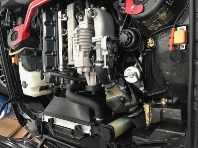

      Great use of z3 parts! My e30 has also made use of my z3 parts bin, but you’ve taken it to another level.
      I’d been trying to confirm whether the Kamotors CAI canister would fit between the m42 expansion tank and the ABS unit. Looks like it does?
        Thanks!
        The CAI is sitting above the ABS unit. Kind of resting on the expansion tank and one of the brake lines if I remember right. I used the included bracket and bolted it to the ABS mount on the chassis.

          Originally posted by Codym42
          Thanks!
          Ok thanks, I didn’t realize your canister is above the ABS unit. It looks so clean, I wish I could fit the Kamotors cai with my set-up. Maybe I’ll try to change the angle of my afm.
            Oh, I see your problem now! I don't think it will fit...looks a little tight in there.
