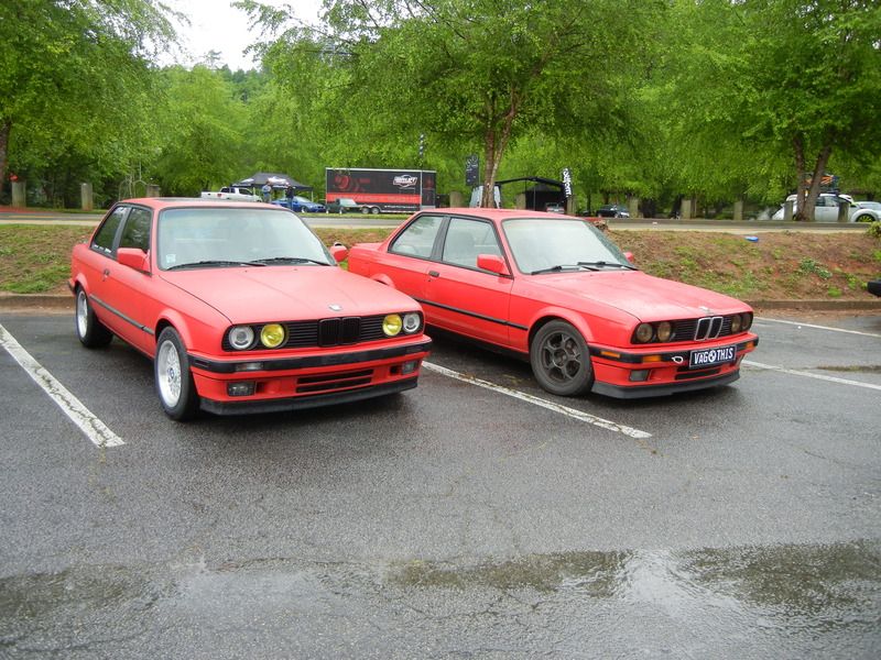

    Just to get this thread going, I'm posting the pictures of Spring 2011 before I did anything. I took it to the Mitty at Road Atlanta and parked it next to a beautiful E30 M3. There were quite a few e30s there that year, including Ryan Sermonet's gorgeous Calypsorot car (still one of my favorites). The only things done to it in 2011 was a cooling system overhaul, window tint, and I had the A/C recharged. In 2012, I got started in Autocross.
