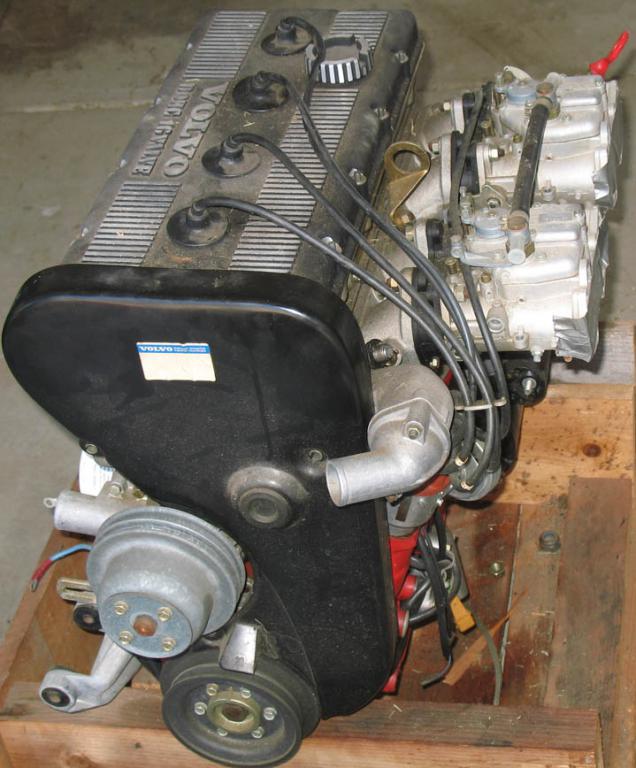

        Originally posted by adam.nonis
        More fun might be putting carbs on a DOHC redblock instead of converting to EFI.
        Like so...?
        Sorry for the distraction - Back to the build!
        • adam.nonis
          • Apr 2017
          • 755
          #274
          Yup! Just like that in an Amazon. Bad ass.

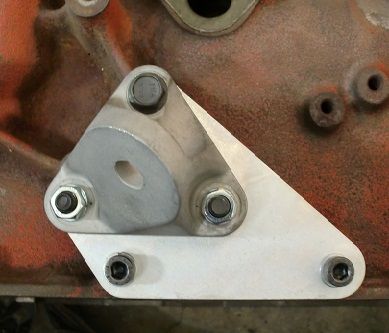

                I see. Found these mounts at yoshifab....
                "This kit allows you to bolt any engine mount that would bolt to a pushrod (b18/b20) to a OHC (b21/23/b230) redblock. They are laser cut steel and cad plated. Kit includes all necessary hardware.
                These adapters adapt the early mount brackets to the late model block. The motor sits in the same upright position as the early motors, the bell housing bolts on as the stock early car would. It is suggested that you run the early oil pan and modify the oil pickup to suit. There is a slight difference in the block width that we deal with by running the 240 offset stud motor mounts."

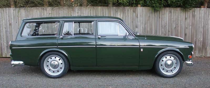

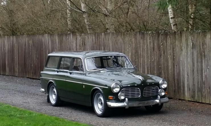

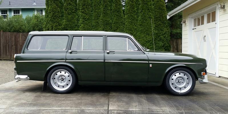

                      Just an idea for wheels....
                      These are 17" Charger wheels. Kind of a cool OEM steelie look, but BIG. I think this is a NW car.
                      I sort of like these old school hot rod grey spokes (but not the headlight rings)..
Name:	122 wagon mods.jpg
                      ..or you could go old OLD skool.....!
Name:	low Olav-kjetil-kvipt-1967-amazon.jpg
                      <EDIT>....doh, you have E30 hubs now, not Volvo hubs!

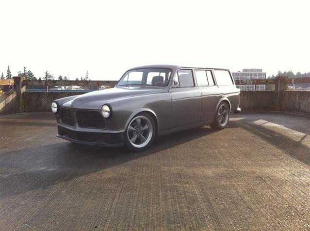

                        I always wanted to put American Racing Salt Flats on it. I like the old school style, but I’m waiting until I convert it to five lug and have the suspension dialed
                        The wheels:
                        The original rendering I had a buddy do before I started this YEARS ago:
                        The original picture he used to make the rendering from:
