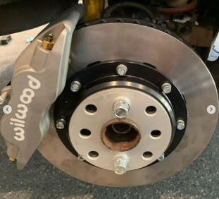

ID:	10033229 Click image for larger version
ID:	10033230 Finally Massive Brakes 300x32 kit has been installed front and rear. I can now confirm these clear both, the Sparco FF-1 15x8s and Jongbloed 15x9 wheels (I imagine the 15x10 will clear as well, if it's same barrel).
                      Currently dealing with issues bleeding the wilwood dual master setup, I can't get a solid pedal bleeding the system using the old school pump pump pump hold bleed method starting from RR going to LR to FR to FL calipers. I also tried using vacuum method, didn't work any better. Combination of pump/hold/bleed AND pressure bleeder worked somewhat but pedal is still not solid .
                      Going to try and bleed one side of the car at the same time (AKA 3 man bleed) how Tilton suggests it's to be done. If this doesn't work I guess I'll have to remove the stupid pedalbox, adjust the balance bar all the way to the front, bleed the front, then adjust the balance bar to the rear and bleed the rear. Absolute nightmare of the setup.

                        She is back on the road , installed my Sparco FF1 wheels , these are freaking light ! With Toyo Proxes r888r 225/50 tires these are lighter than my previous TRM wheels .
                        Jongbloed 15x9 with 245/40 are off the car for now .
                        Both sets clear these brakes, so that’s good 😊

                          Re: Bleeding the Massive delete:
                          I remember bleeding the Tilton dual master brake system from dry/near dry was always a massive pain on my FSAE car, usually required multiple attempts to do it over the course of a few days. A pressure bleeder probably would've helped.
                          Hell, even when I rebuilt the master cylinder and replaced the front lines on my motorcycle, it took me a few hours until I gave up and back-fed the system from the caliper with a giant syringe.
                          I think it's just how it goes.
