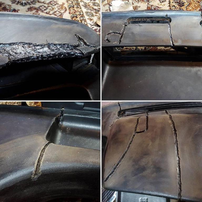

    found a kinda better dash
    Im gonna practice on the old dash and try my hand at repairing these cracks

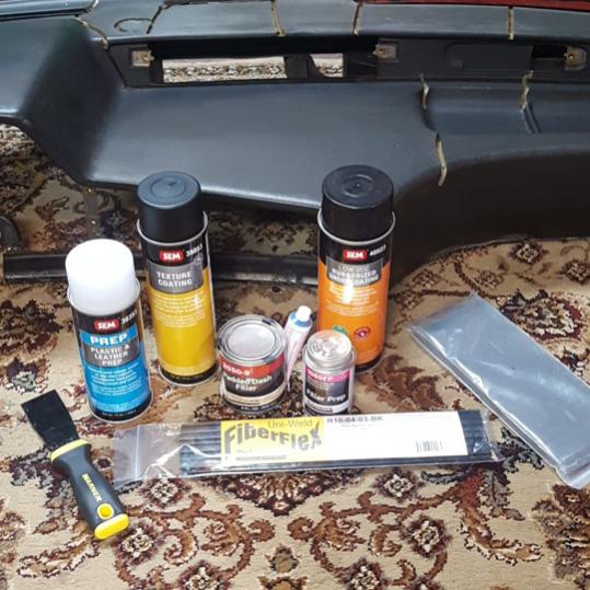

            Got all the goodies in today. Should start workin the dash tonight!

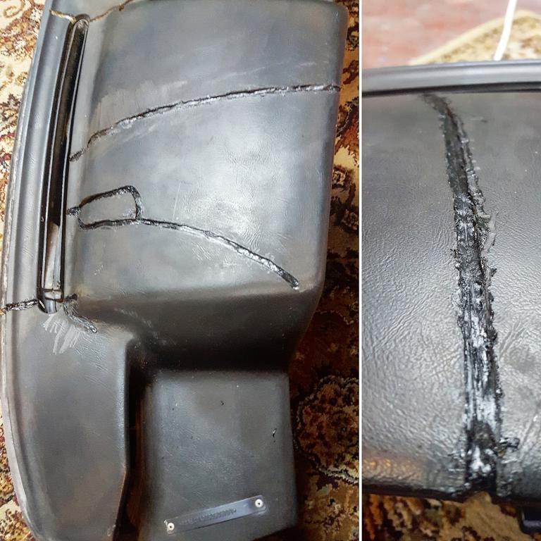

                Almost done with these cracks.

                    surface prepping

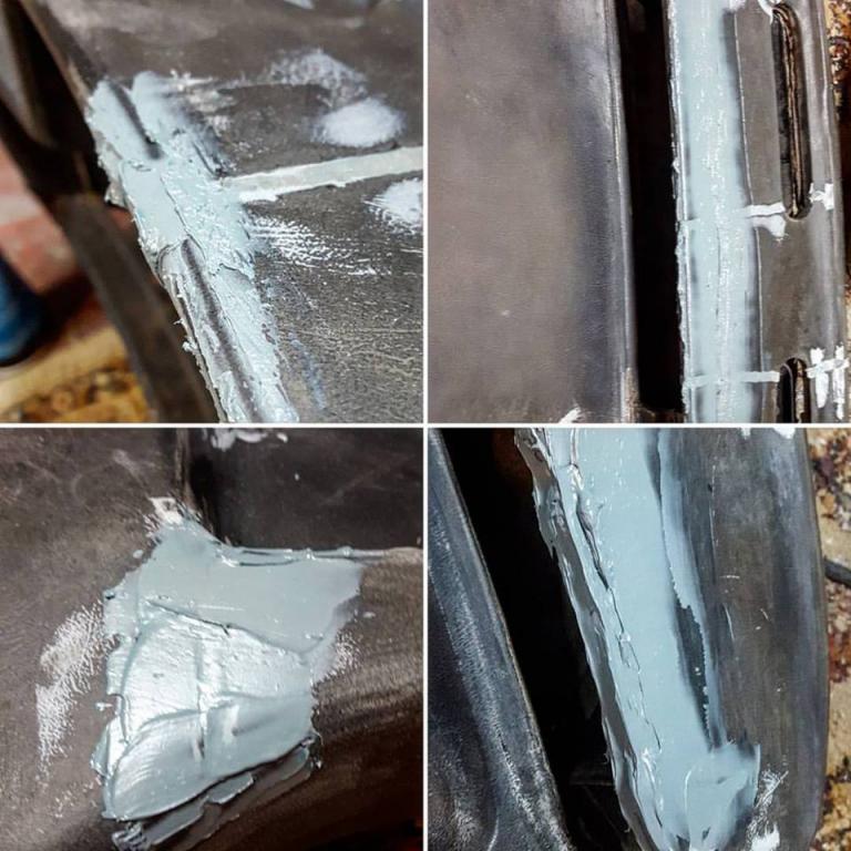

                      filled

                            Can you give more details on the dash repair?
                            Simon
                            Current Cars:
                            -1966 Blue Boat
                            -1969 Red VW
                            -1986 White BMW
                            -2006 Green Thing
                            Make R3V Great Again -2020
                            • evoDRichie
                              • Jan 2010
                              • 1743
                              coated the gauge surround in a textured finish.
                              fist layer of rubberized coating to seal it up. next is high build primer then texture coat.
