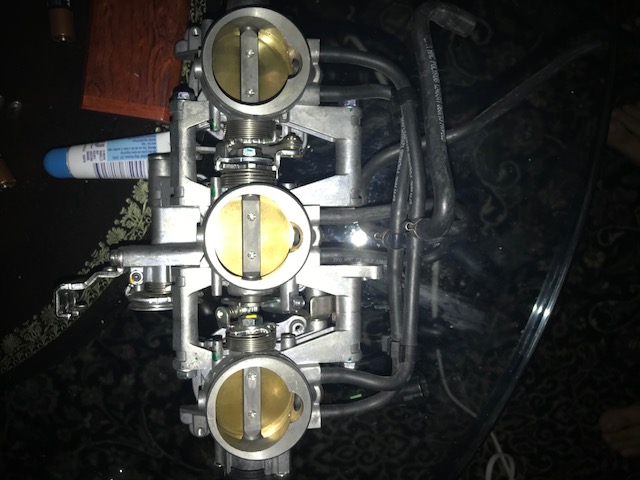

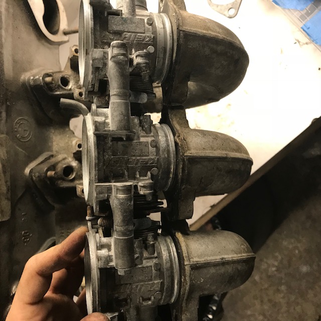

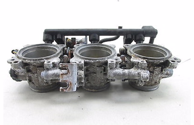

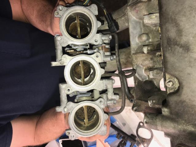

    So First thing i did was hop on ebay and start looking at throttle bodies, i first purchased an set 05 throttles that were in rough shape for 22$

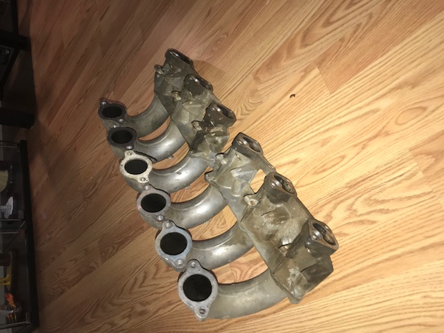

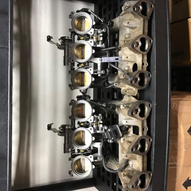

    In order to mount them originally i was going to cut some flanges off an intake manifold to retain the injector bosses. then the idea of using the older manifold came to thought and by sheer dumb luck the bore spacing of the tubes and throttle bodies is a near dead on match.

    this got me very excited and thats when i decided to go ahead further with this and went Back onto ebay. I purchased two more sets, this time specifcally from the 2013-2015 675 R* the r came out in 13 and was a sportier version of the existing daytona. There was clear difference in machining quality and overall appearance of the newer throttle bodies over the 05 ones I originally had. The first set of R throttles ran 55$ shipped and came with velocity stacks. the second set was 72$ shipped and didnt have stacks so i ordered some online and that ended up being 25$

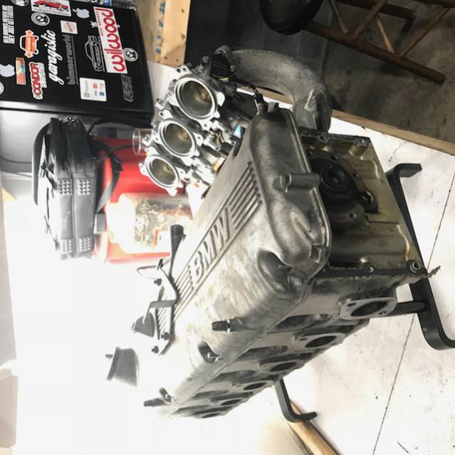

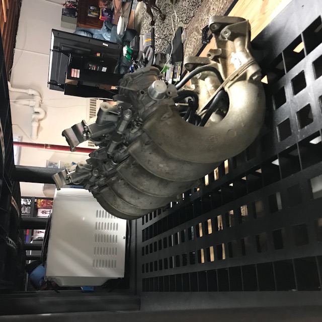

    here is a few more mockup pictures now that i have all 6. it looks pretty rad:devil:

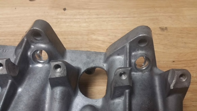

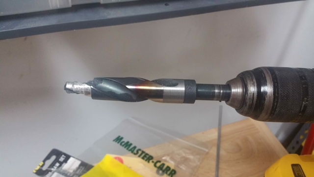

      a few more things to address, the injectors on the early manifold are smaller and must be bored out to allow the use of modern injectors and the current fuel rail etc. I was reached out to by mooseheadm5 as he machined a tool to that will allow the correct bore size and depth.

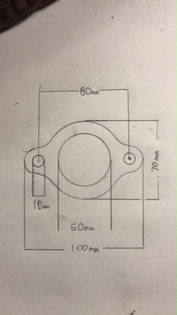

      the next issue to address is adapting the throttle bodes to the runners themselves. To do so Im having my buddy Matt at Lown Performance (mattdk318i) machine me some flanges. so i went ahead and made a little drawing for him to import to cad and plasma CNC them from 1/4 aluminium

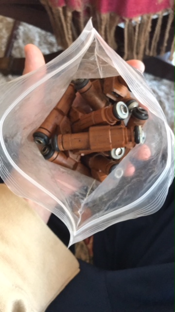

      once those are finished the plan is to have a small tube welded to them so that i can clamp the throttles to that and still have it all removable. I think that about covers everything I have been able to do so far with what I have. i am currently focusing on getting the car running and driving on megasquirt and learn the program a little before i dive head on into this. I picked up (12) 4 pintle 30 lb volvo injectors for 50 from a friend so that should take care of fueling.
