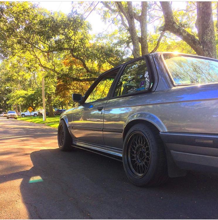

            Any rubbing issues? Would really like to see the ride height. I’m in the market for suspension stuff and was wondering how your current DD setup is. Excited to see the build.

              No rubbing issues- I barely rolled my fenders for peace of mine (New York roads are scary) I had the front wheel contact the lip once or twice on really hard hits. I’d say race springs are the perfect DD low- my brothers is half inch lower and it has a lot more problems getting around. I drive this like a truck sometimes lol

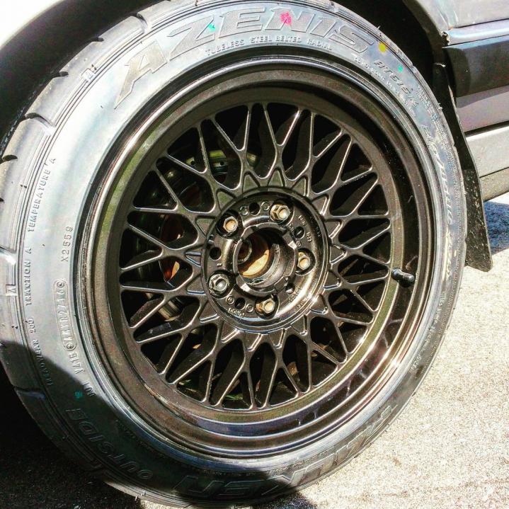

                    Are those 225/45s on E38 style 5s with 18mm adapters?
                      Tires are 215/45 falken 615’s they were nearly as wide as my buddy’s random 235/17 he had laying around. The tires have a lip guard in them and stuff sidewall that appears to make them larger. But for sure large for a 215

                        Oh cool, this is actually news to me. I didn't know there was a size available anymore between 205 and 225. I have filled/drilled E38 style 5s running a 10mm spacer up front. Due to seeing this setup, I think i'll be able to fit a 215/45 in there. Your offset is essentially et5 right?
                          I answered all these in a post on the first page ;) but yes that is correct. Final et + 5 everywhere

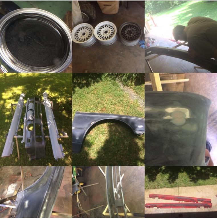

                              Here’s a few random photos from right after graduating, the car got pretty beat up at school needed a refresher. So it got a Hood, Fender, is side skirts, wheels, and a fresh coat of paint for all of them. I did all the work with my friend Jordan in his back yard, sanded prepped primed cleared all in a day and a half.
