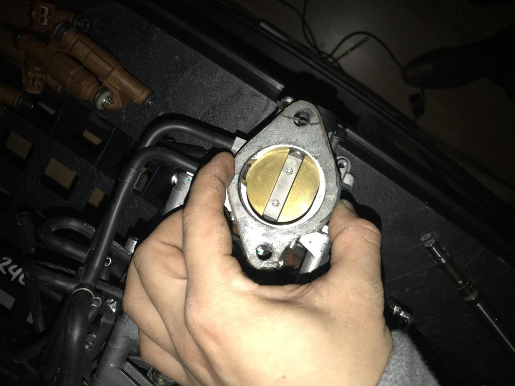

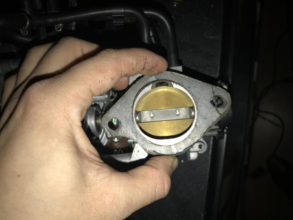

        Just some ideas of how close the port is to the throttle body itself there is room to extrude here- although the machining is so clean I don’t even want to try- if I do I’ll probably just try to round the bottom flat edge a bit deeper.
        And yes I’m going to make a plug for the old injector bosses. I will have access to a 3D printer so I’ll probably design a plug that will fill the hole flush to the bore.

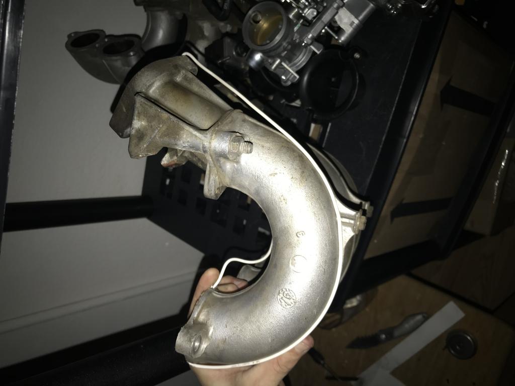

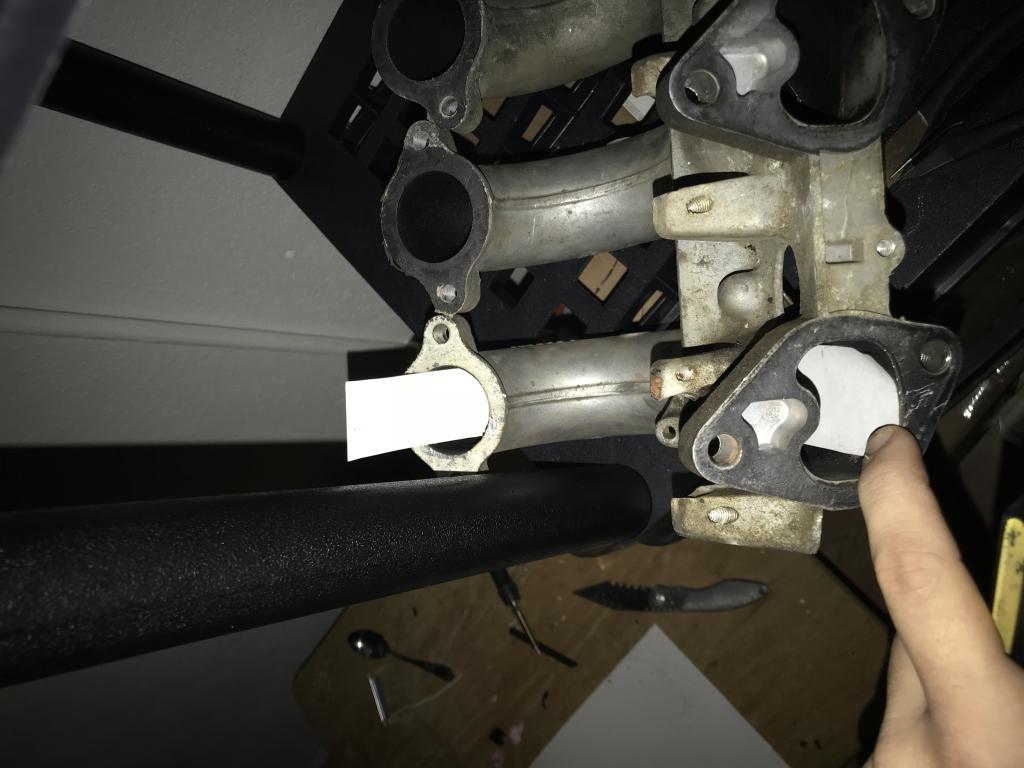

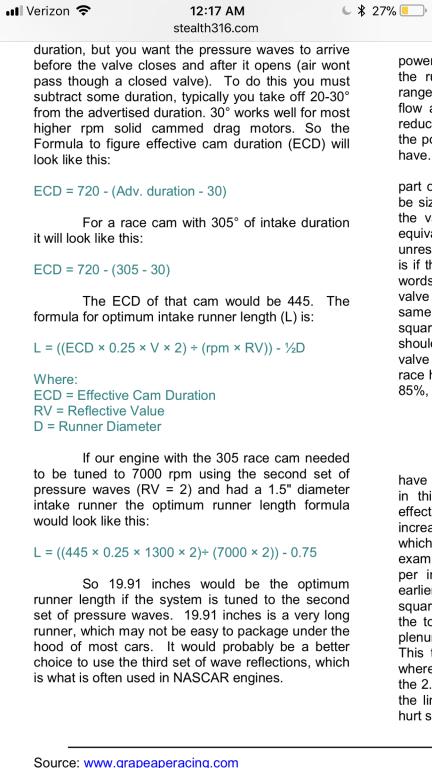

          Another extremely crude measurement- I wanted to get an idea of the runner length, and yes supposed to measure valve stem to end of runner but I don’t have a head to look at for the moment so take this with a grain of salt. Or 5.
          Around the outside I get 14 inches, through the center I get about 12, and around the inside I get about 10. So given that let’s call it 12 to the head. Without a velocity stack, not factoring the inch behind the butterfly and the inch or so in the head. Plugging in cam numbers and other little bits into some calculators tuning for the 4 resonance pulse around 5-6000 rpm (I tried it a few times) come up with similar dimensions- so I might not be too far off the ball here.

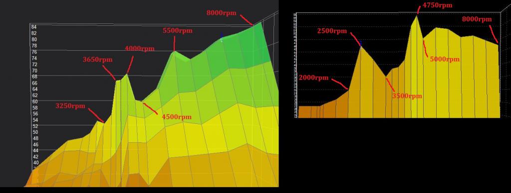

          I’ll be able to actually figure this once it’s running after the AFRS are dialed in and it runs smoothly. The fuel table In 3D should show some destive peaks that should* give me an idea of where and when these pulses are having an affect.
          Here is a 3GSE fuel table for example

          I’m pretty clueless on the subject- but have been reading some chapters of some books and various threads trying to gather information. Would love to
          Hear input from someone that knows what they are talking about

                id have the length adjustable using different bell mouths that bolt on. 11" (length from head mounting face to radius of entry) is absolute shortest you'd probably want on an m30 with ported head and decent cam and the m30 might like 3" more than that for the better midrange. short runners is absolute worst thing you can do but you seem to be on the right track. i thought about trying to use those runner sections on an m20 once to try and get something that was as long as OE but using the RHD throttles

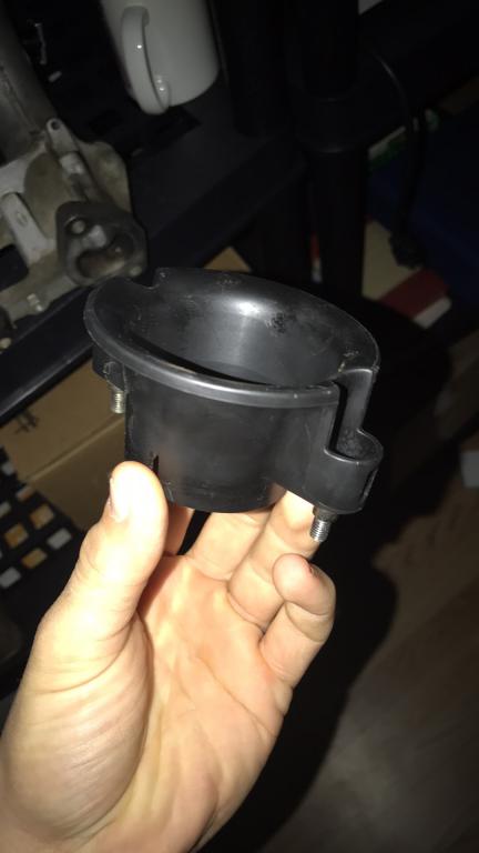

                  Thanks for the input! So there’s gonna be another 2-3 inch worth of velocity stack that will be on top of the throttles and once I have access to that printer I may be able to print some out to test, also I’ve gathered some info on e21 intake tubes and they appear to be the same diameter but slightly longer with the same bolt pattern- so I’d like to grab a set of those for comparison. Was digging through some old e9 forums and stumbled across it

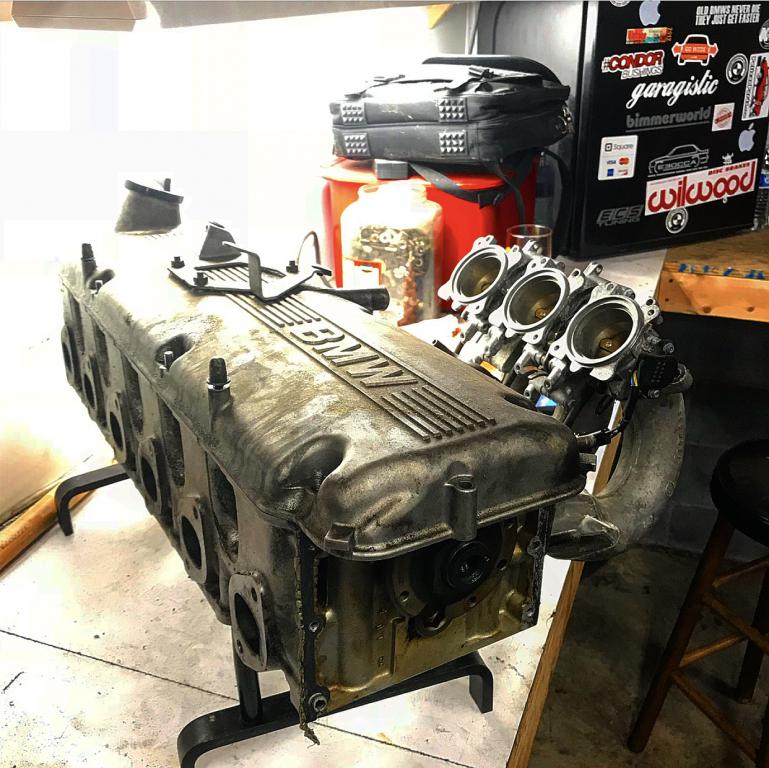

                      I had forgot to add this in the first post- but an idea of how it’s gonna look, I wish I had the stacks at this point
