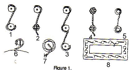

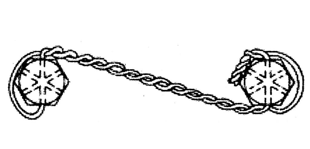

                        You should pull the oil pump bolt to the left, IE #7 Click image for larger version
Name:
ID:	9876039 opposite of this picture for left hand thread.
                        @Zakspeed_US
                        • jinoguy
                          • 183
                          #72
