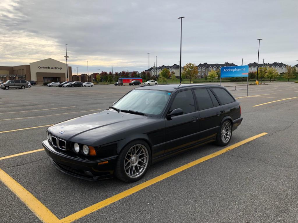

                      ......pic of my buddies complete M5 conversion
                      • KIRIEIW
                        • Dec 2012
                        • 3385
                        #41
                        Originally posted by 411
                        Super nice car & great work! Love the color!
                        S38 swap? Looks great!
