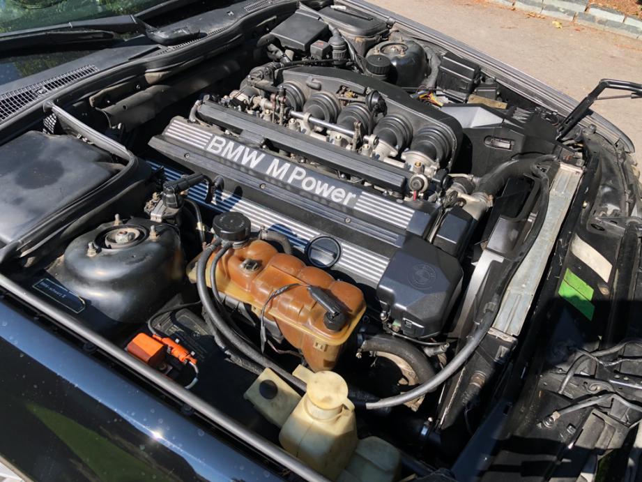

                              Originally posted by KIRIEIW
                              S38 swap? Looks great!
                              Yes

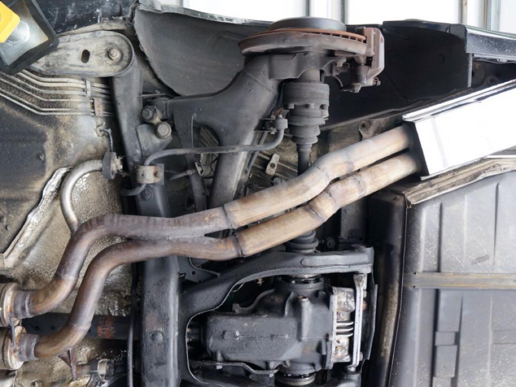

                                Exhaust set-up on same car
