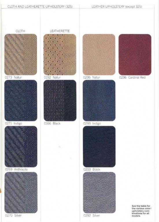

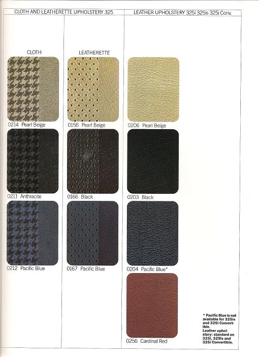

                Originally posted by e30austin
                That is 100% Cardinal red. It was the only interior offered in 1988, in red.
                For reference...
                0162 "Cherry" red (1984 spec)
                0208 "Taurus" red (1985-1987)
                0256 "Cardinal" red (1987-1989)
                0324 "Crimson" red (1990+)
                Could be 0296 Cardinal as well. Not sure why they changed the code number from 87 to 88.
