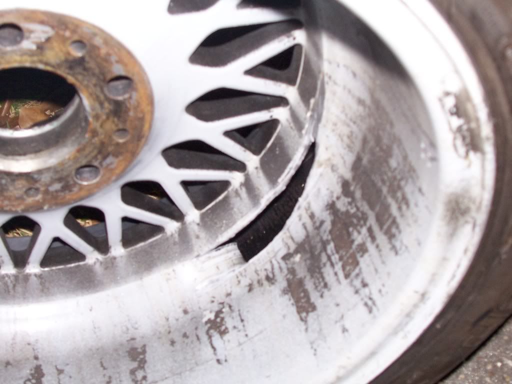

    Ok, had a little FUCKING incident tonight. I was out doing some data logging and road tuning. I was driving all over Denham and went down FUCKING Eden Church Rd. to hit Florida and go back to the house. I come up to the red light and start slowing down (from a whopping 30) I see a pot hole and go start to go around it. BOOM! Steering is pulling to the right hard (no power steering). Pull into the library and get out. Walk over to the passenger side and see a FUCKING flat. So I'm like shit. No spare FTL. Call my dad and he brings me my air compressor. I hook it up to my inverter (for the laptop) and let it pump up some. Put the chuch on the stem and air is just gushing out. I looked around the tire and don't see any bends, nothing on the inside either. So I'm like WTF? Look the the spokes of the rim and BAM! The god damn pot hole put a HUGE fucking gash in the rim (right behind the spokes where it should be the strongest) about 6 inches long and about an inch wide. The damn metal pulled back into the rim towards the tire. Brand new fucking tire too. I MIGHT have had 95 miles on the damn thing. Fucking BFG KDW. Now I get to order a new tire, go get a bunch of fucking air craft stripper, some paint, and some sand paper to refinish another fucking rim. It took me over 2 weeks to refinish all 4 rims. This sucks. I'll get pictures of this shit up later.
    If it was a public road the county/state might be liable? I would check that out

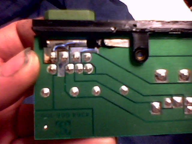

                  Figured it out. Stupid shit. Well, since I wasn't getting power to the ECU at the C101 connector, I figured it had to be something body side. So I started poking around and my thoughts kept going back to the OBC Code function. Well, I have never entered a code and figured something with that system had to be the culprit. So I unplugged the OBC itself and still nothing. Started looking at wiring diagrams and found that the code function is triggered by a relay in a little black box behind the ABS computer. I pulled one of the plugs that went into and controlled the ecu power. I jumpered the wires that supplied power to the relay box and the wire that fed power through the C101 to the ECU. Blam-o. I get power. So I went to work and grabbed another relay box from a junk car and put it in. Works perfectly. I pulled the box apart, the one that had failed, and I found a broken/burned trace on the PCB board. There's the problem!
                  So, I missed the Auto-X today, spent most of the day running between work and home for parts, and got the car running, again. It's always the little things that you don't think of.

                    Here's a picture of the broken solder joint inside the OBC relay box:
