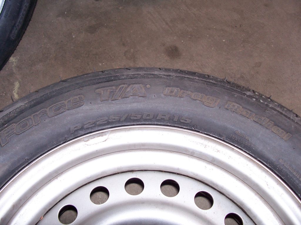

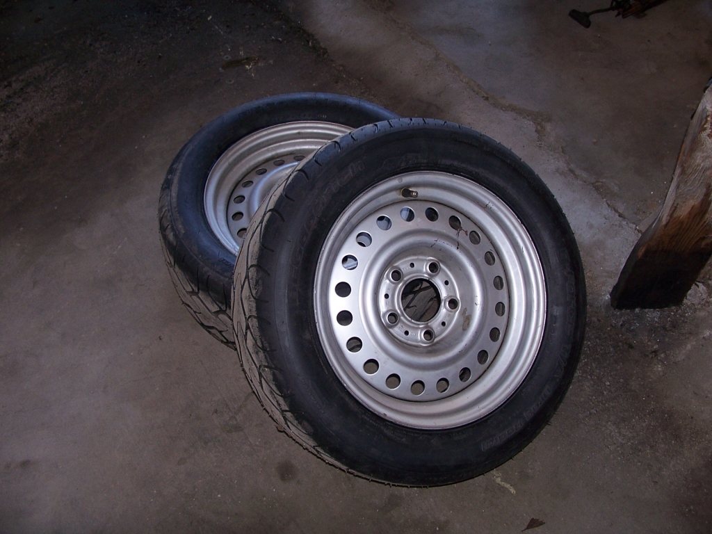

          So, I got to run a buddy of mine in his C6 'Vette. He runs 12.80's consistently and is trapping like 118/117. Well, I just (Thursday) got my 225/50/15 BFG DR's mounted on a set of 5 series steelies (15x6.5 et20). I dropped the tire pressure down to 25 psi (then later dropped them to 23 psi and could feel a difference) even though I should have gone down to 20 psi. Did my burnout, then lined up. Turned on the launch control, brought it up to 4000 and then went. I spun in first up until about 6500-6700. I 60 footed the shit out of him and had him all the way through the 1/8. After that, he pulled around me pretty good and at the end of the 1/4, he had me by like 2-3 car lengths. When I crossed the 1/4 mark my MPH was between 105 and 110, wasn't paying that much attention to the speedo.
          I look at it this way, once I get my tire pressure in the sweet spot and get the launch control at the correct RPM, then I should be able to pull sub 1.8 60 foot times, as long as I don't snap any axles. There is a test and tune all day next Sunday that I am going to hit up after the AutoX gets over with. That will allow me to figure out tire pressure, launch control, maybe play around with the flat shift feature, and I should be able to find the sweet spot. I'll post it up Sunday evening when I get back.

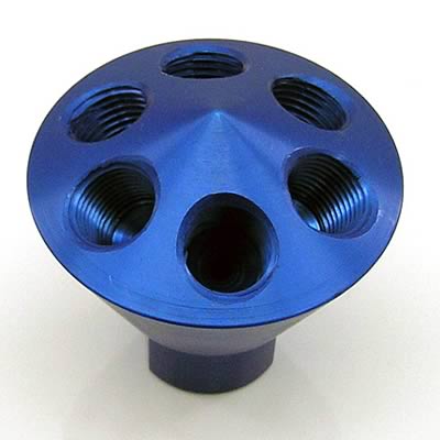

                    Well, I'm getting some stuff to help get my nitrous system closer to being done. One of the guys that I know on BimmerForums.com is selling part of his nitrous kit because he didn't like the distribution blocks that it came with. So I am picking up both of the ones he didn't want for 95 bucks.
                    Here's a picture of what they look like:
                    Should make for some fun.

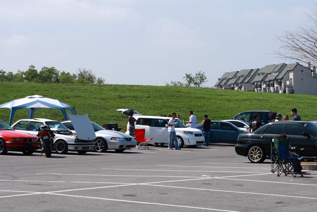

                          And on to today. I took the longest trip that my car has had done to date. I drove to New Orleans for the big Lake Front Meet. There was the better part of 500 people/cars there. I drove down with about 10 cars from Baton Rouge. We got there at about 10 or so and left like around 5. I literally look like a boiled crawfish/lobster. People are still out at one of the many Sunday night meets so I will be trying to find some pictures of my car and some of the other cars that were there and will be posting them up as I seem them.

                            Here's a link to the local forum thread with the pictures for the meet.

                              Ok, I found some pictures. Sorry they are enormous.
