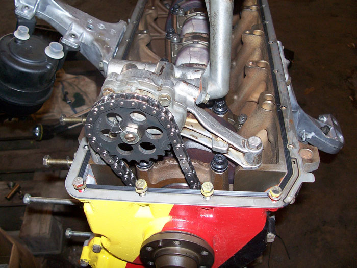

        Was enjoying all the work till I saw the safety wire on the nut. You should have used a proper safety wire tool and drill out the sprocket. You might loose that wire into the pan.
        Very nice project.
        • PiercedE30
          • Apr 2005
          • 4220
          #49
          I drilled through the sprocket. I managed to line up the hole on the nut and the hole in the sprocket and ran a wire through there.

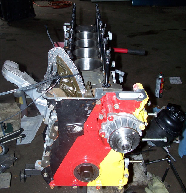

                  Who likes updates? I know I do.
                  First, rod bearing clearances:
                  1 - 0.025 mm
                  2 - 0.025 mm
                  3 - 0.028 mm
                  4 - 0.028 mm
                  5 - 0.025 mm
                  6 - 0.022 mm
                  Ok, had to order new piston rings and rod bolts, got the wrong ones from WorldPac, so I had to get them from the dealer. Ouch. Rings - 198 bucks, Bolts - 50 bucks (or so). Didn't make me too happy, until I put them in.
                  Here are some crappy pictures, I will take some with a camera tomorrow.
                  Pistons IN!!!:
                  Deck Clearance (-0.031"):
                  Front timing cover and water pump bolted on:
                  Here is some useful information for everyone (excerpt from my post on BF.c):
                  Here is some info on the motor:
                  Combustion chamber VOL: 32 CC's
                  Deck Clearance: -0.031" (piston sticks out of the deck for a negative value)
                  Single Cylinder VOL: 475.5 CC's
                  Ok, if my calculations are correct these should be my options on HG's and what those HG's would make my CR:
                  0.098" HG = 12.5:1 CR
                  0.120" HG = 11.7:1 CR
                  0.140" HG = 11.1:1 CR
                  Who thinks they know what HG I will be choosing? ;-)
