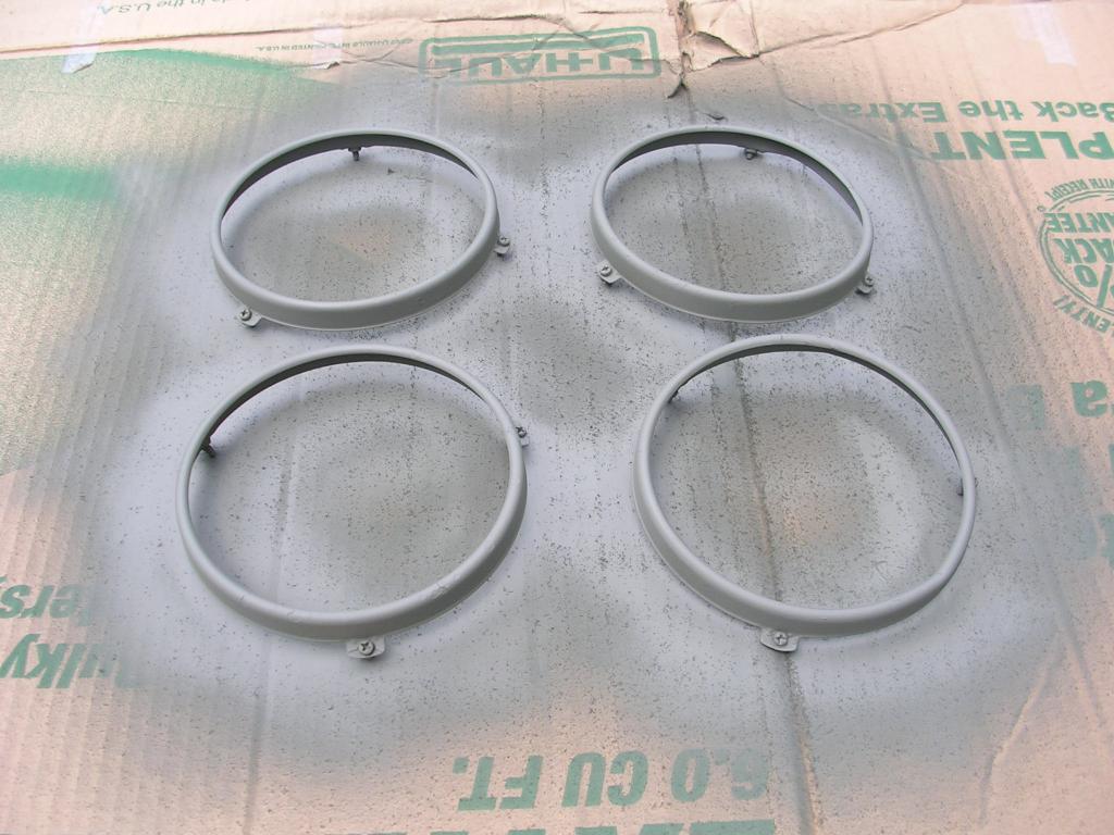

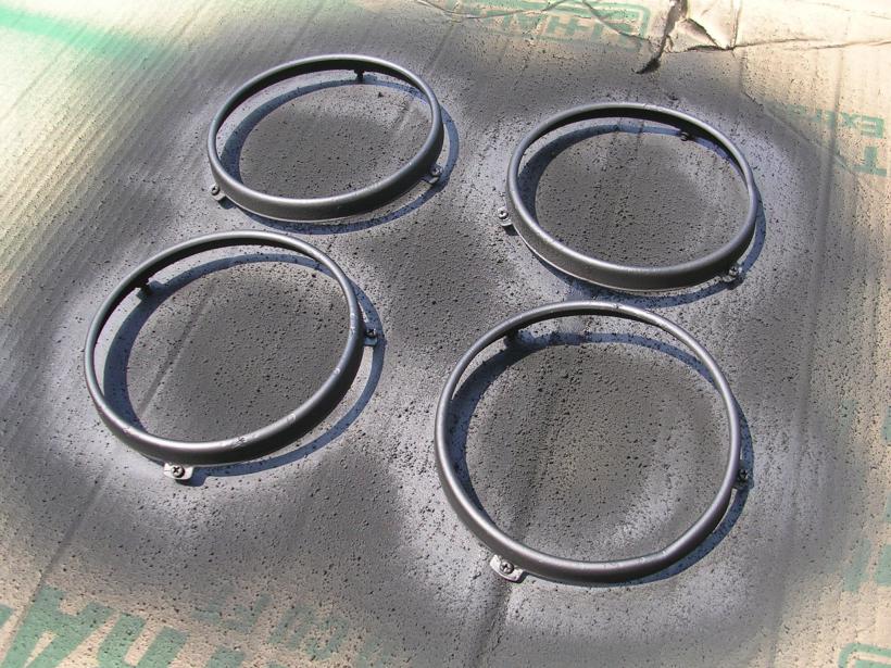

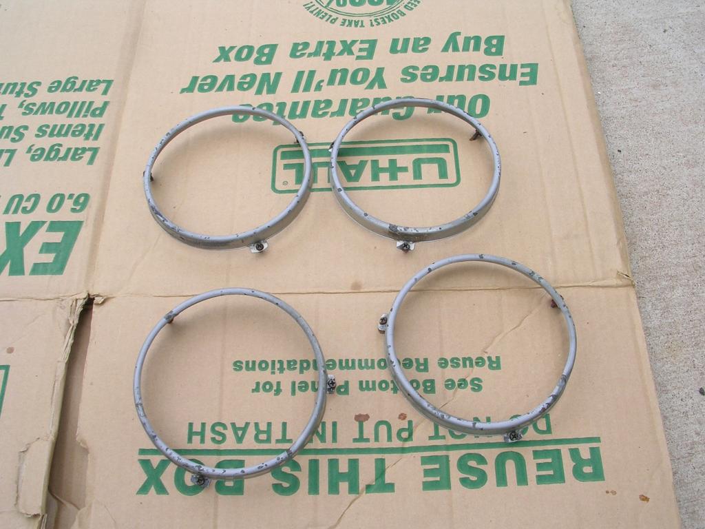

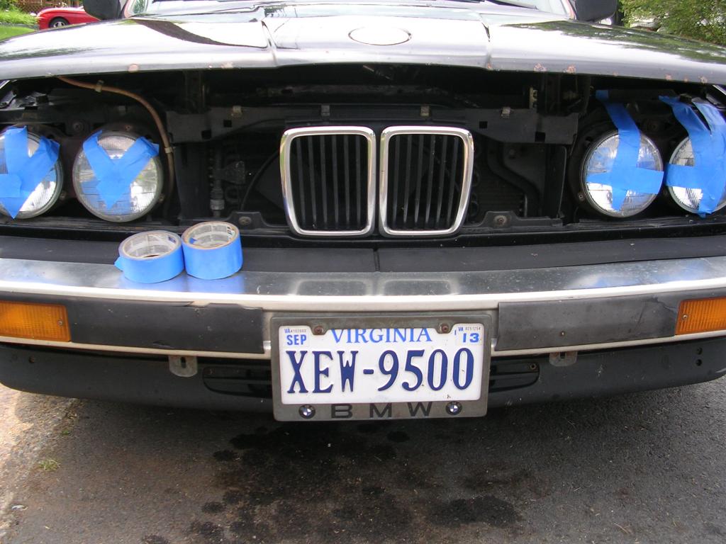

      such a simple job, can't believe i've waited this long to do it...
      Black headlight rings!
      Step 1: remove swanky euro grilles, unscrew headlight rings, support headlights with generous amount of tape
      Step 2: clean/scuff rings, used a blue scotch-brite pad and warm water + dish soap
      Step 3: 2 coats of self-etching primer, relax for 30 minutes
      Step 4: top coat, 3 coats and some of time to cure before reinstallation, I'm gonna give them 3-4 hours. 90 degrees, 44%RH I think that should be more than enough
      Busted to shit, I wish I had access to a media blaster and fresh headlight rings

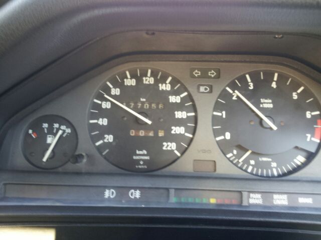

            I now have a working Speedo for the first time in 2 years :)
            feelsgoodbro.
