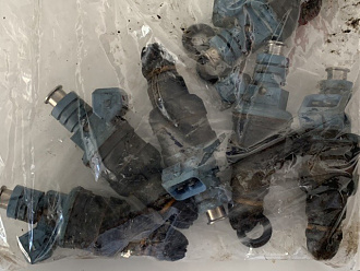

    Installed rebuilt injectors from CA Tuned on my 92 cabrio today! I got a lot of help from two friends which made the job a lot faster and easier. Learnings:
    1. No need to remove valve cover or intake manifold but the intake manifold brace must come off
    2. Car sat for a week, hardly any fuel spilled. Still, it was good to have a fire extinguisher ready.
    3. Electrical connectors popped off easily, no need to remove the electrical conduit, just push it out of the way
    4. Steel retainer clips came off with a hook tool. Keep a magnetic probe handy to catch them.
    5. Clean out the holes with carb cleaner and compressed air. Mine were filthy with grit and oil.
    6. New injectors don’t have to go in tightly, they feel wobbly even when fully inserted
    7. Use a magnetic probe to hold, align, and push on the steel retaining clips
    8. Don't forget to reinstall the intake manifold brace or you’ll have a vacuum leak. Ask me how I know...
    9. My car ran like crap and had a miss after we were done, but a short drive with heavy acceleration cleared it all up. Don’t be afraid to drive it if it runs roughly at first.
    10. I would rate this job as tricky but not difficult. Tools required included 8mm and 10mm sockets, hook tool, large screwdriver for prying off the electrical and fuel bars. Carb cleaner and compressed air were also needed.
    Many thanks to my friends Johnny and Sean for their help!
    Click image for larger version  Name:	image_144514.jpg Views:	24 Size:	108.0 KB ID:	9874200
    Click image for larger version  Name:	image_144513.jpg Views:	23 Size:	76.4 KB ID:	9874199
    Click image for larger version  Name:	image_144512.jpg Views:	27 Size:	75.1 KB ID:	9874198
