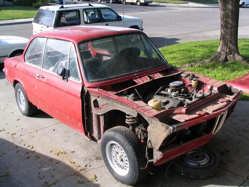

Well, here's a few quickie pics of what the 02 looks like now, or at least close to. It currently doesnt have the trunk lid on it anymore (it is covered with plastic sheet taped tight and a junky car cover, so it's not getting wet), rear side windows are out, but the hood actually IS sat on top where it would be. Once I can get it in the garage I'm building a dolly for it ASAP, tearing off all the original suspension and probably selling it off cheap, and going at the body work, including removing all the road grime and crap from the bottom to bare metal to paint it again and put down some WURTH undercoating, then paint it black. The M10 and tranny need to go still, that's one thing I've been seriously slacking on, that is getting rid of all my spare M10 stuff. Anybody locally need a cheap running M10? I also have lots of other stuff that could be used as cores to rebuild :)
The trim holes are currently plugged up with some bondo junk, but they'll be either welded or leaded shut.
The rear panel is a little worse for wear so I may have to swap it out for a better one I have, or new if I don't get it close enough for a really light skim coat of filler to block down.
Also down a few pics will be a few of the bondo frenzy I found on my quarter panels. I'm not too particularly excited about this archaeological dig I've found, who knows how long its been there, and how deep it is. I get to find that out when I can strip it to metal in the dry garage too! Too bad its not a climate controlled garage, but at least it cant get rained on...Besides that, when it got smacked in the rear to put some waves in my rear panel, it put the slightest dimple in the quarters, I could have sworn I saw something on the pass side but certainly on the driver side I'll have to shrink some metal in order to get it perfectly straight.
One more thing, my nose piece has been thwacked once or twice, so the drivers side headlight bucket bracket is pushed in a little bit, so I get to figure out how to straighten it out and tack it back in place where it should be. A small tear at the bottom, which I'll just goober up with weld and grind down. It wont be seen anyway behind the air dam. I'm sure some tweaking and pulling here and there will be required to help it line up just right with the new fenders, but it's all about the adventure................right? =/
Sentimental value sucks, but I love this car!
So here it is, in all its not so good lookin' glory. Soon to change! -
The rear, its not so bad, but plenty of tedious work to get straight. If I can save it myself, I'll do it. Ive spent enough as it is-
Some rust that came through, I've cut it out and have a patch for it. It originally came from the trunk floor so I need to build that out some to match the quarter, then weld the patch for the quarter on and I'll be good. Not much work, just once again, tedious.
There are a couple pin holes I can weld up, otherwise screw it, cover the rest of it in POR15!
Somewhat screwed up, but I think I can save it-
Little bit of a tear like I mentioned, it's nothing at all-
Driver side bondo, probably a quarter inch thick in places. ugh.-
Passenger side-
Depth, at least in that small area. Quarter inch or so. Just more banging away to be done-
Now all of you can see why I really want this thing somewhere dry and lit. Then I can work on it whenever I feel like it, hopefully all the damn time. Its certainly rough but it's got awesome parts, it'll just take time and effort, and probably plenty more of that money stuff! I could probably get a cleaner shell but all the work I've done to it already would go to waste, and I have an extreme attachment and loyalty to this car. Kthx!
I hope you'll all enjoy the progress I'll post along the way here, and thanks for all the encouragement. Doesn't look so hot now, does it? But it will! That's the whole idea behind a "proooojjeeecct".Last edited by Justin B; 10-29-2007, 06:45 PM.Comment

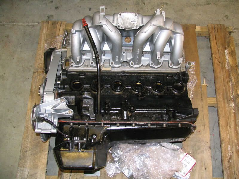

Here's the only real picture of the M20 I have.
It's an M20! How exciting. lol
