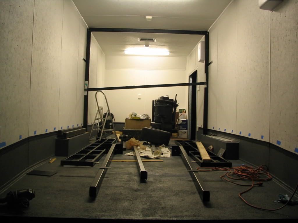

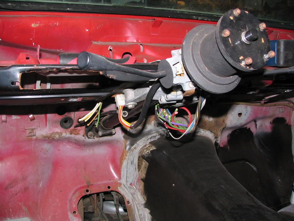

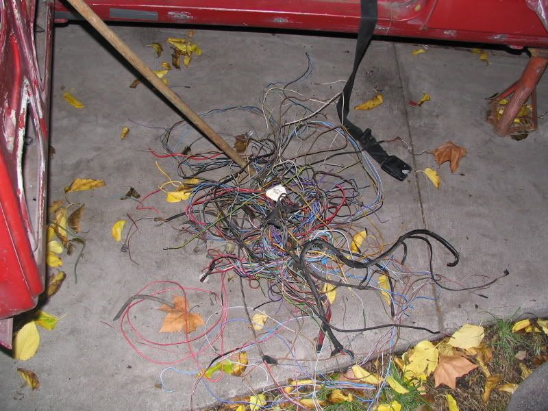

      Decided to tear out all the wiring out today, it went a lot faster than I thought it would. Could be because there was barely more wires in the whole car than what I took out of my e30 when I removed the premium sound to redo it.
      Not much left, just a little left on a couple of switches-

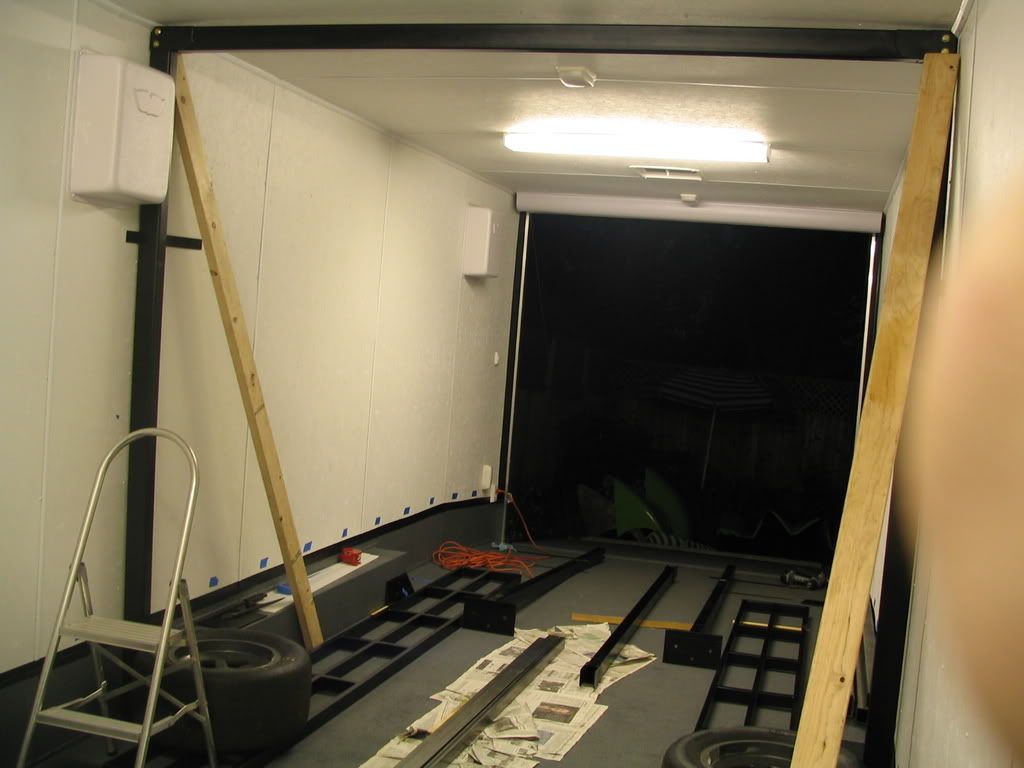

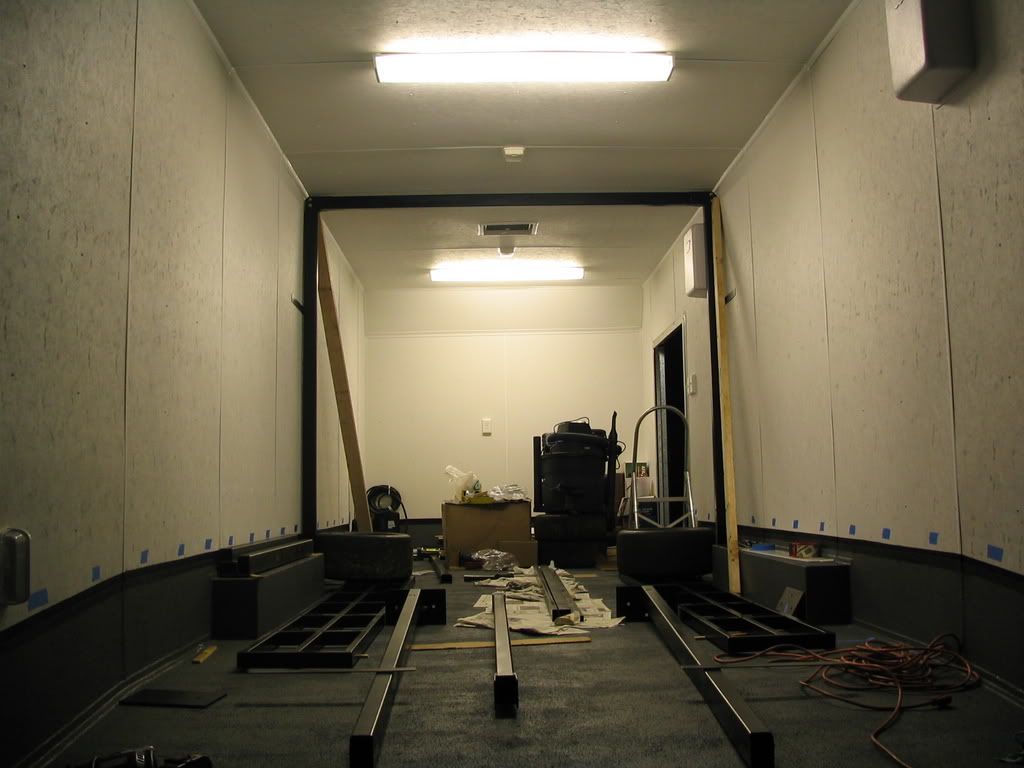

      The trailer-
      You can see the ramps, they'll be covered in aluminum tread plate. One side is put up entirely and square, but the sliding piece needs the ears spread out a little though so it can slide. We have eight 8' pieces of plastic for the ears to slide on, and need to bolt on the winches and figure how we're going to route the cable.

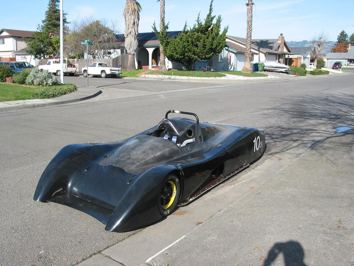

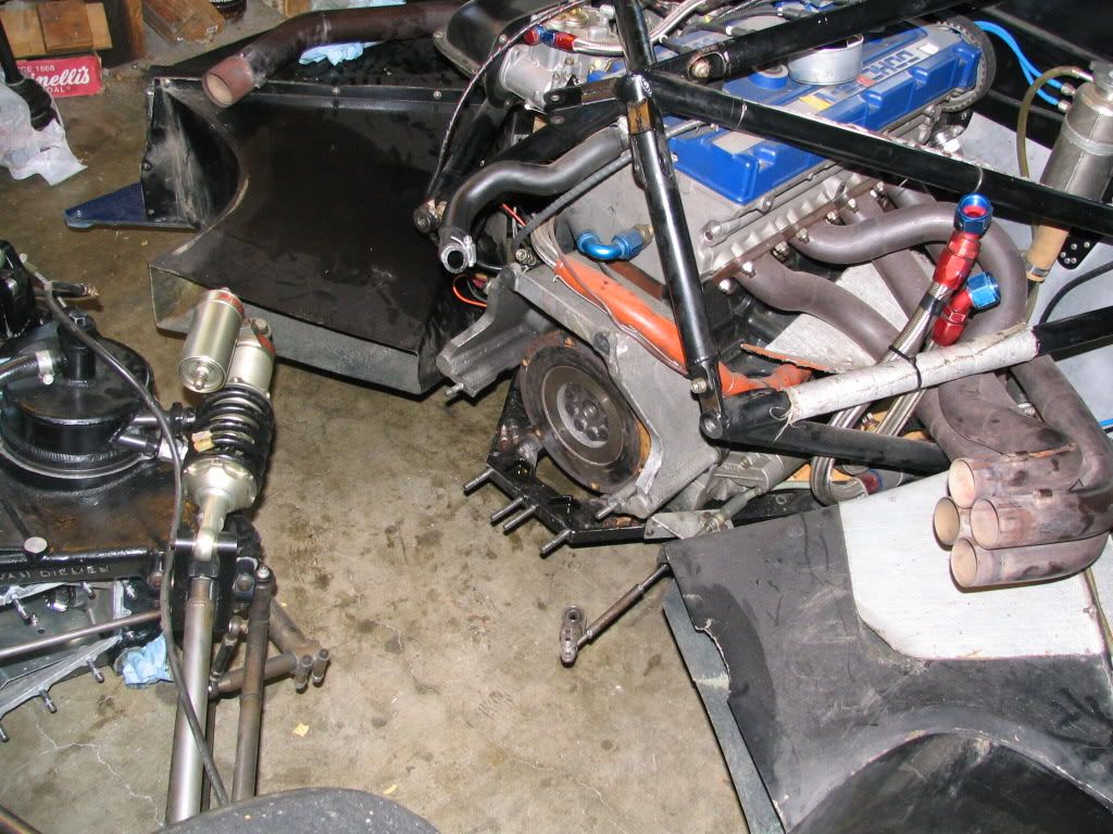

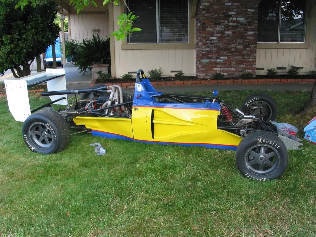

            The car is my dad's VanDiemen, his car, his trailer, the formula car that will be going up top we went in together to buy.
            Anyway, regardless-

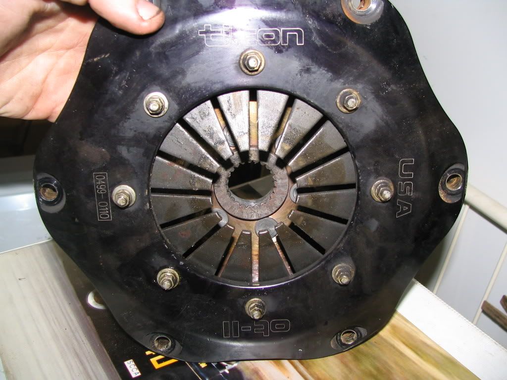

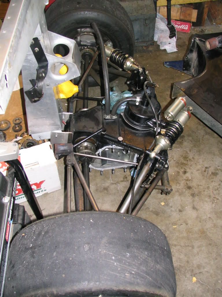

            Here's at least one pic for now of it when we first got the car a while ago, its been a PITA to get running. First the sequential tranny overheated and one of the shafts and welded itself to a fork sticking it in 1st gear. Unfortunately its one of the only transmission of its kind in the world, so no parts. It was built by VanDiemen to get homologated by SCCA, but basically got rejected and there were only a couple of them. When it was finally back together it got one lap till the friction plate of the clutch was stripped out via the input shaft to the tranny. Just got that back together. Powered by a ford cosworth engine.
            The back end torn apart and stripped clutch-
            Heres the formula continental. A '88 Swift SE-3 with newer bodywork-

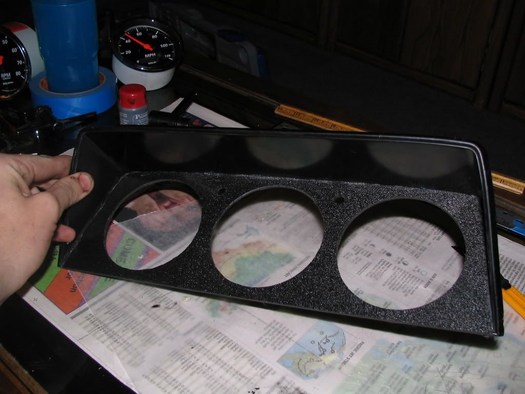

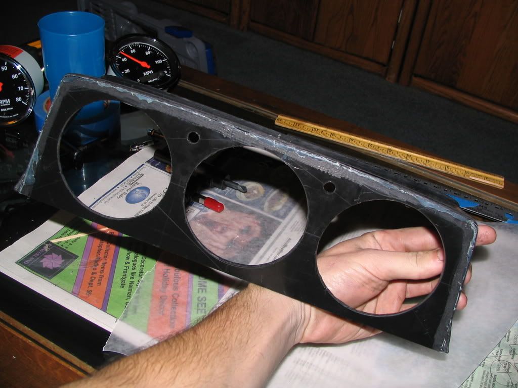

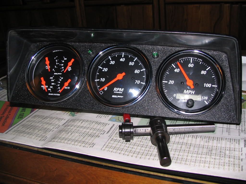

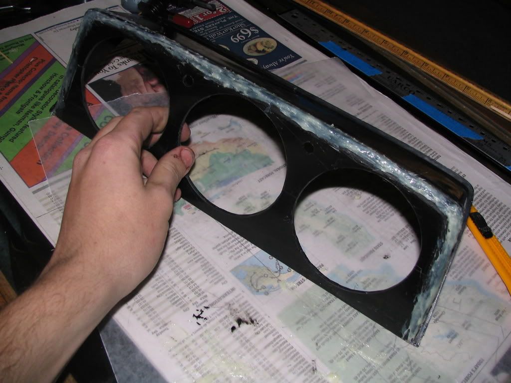

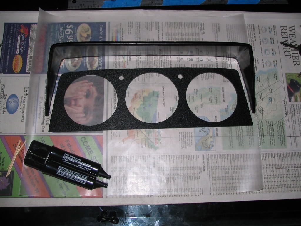

                          Yesterday I got a 2x2' piece of 1/8" thick ABS plastic with some texture on one side good to be a gauge face. I found my scrap gauge cluster housing and removed everything but the three sided hood and transfered it to a small piece of the ABS. It's close, some gaps but that will fill with the epoxy. I'm going to mount it to the stock locations, so I'll have to measure the mounting studs on the good gauge set I have for now.
                          The two green LED's (panel mount and already ready for 12v) in the middle will be turn signal indicators, and I'll put a dummy light somewhere for either oil level or just a generic one for several problems. I haven't drilled for that one yet because I'm not 100% sure on it yet.
                          Yeah, 120mph speedo is "low" :P I can always replace it with a sport-comp 160mph one if I find one for a good deal, or feel a need.

                              Fucking subscribed. I'm really diggin' the gauge cluster. Mind if I copy yours for my 2002?
                              Ben
                              Originally posted by BillBrasky
                              E36's are the Stephen Baldwin of the 3 series family. They barely hold everything together and they only sold a lot because of the popularity of their older sibling.
                              1991 318i Alpine II - S50/5-lug swapped - track car
                              1989 325i Cirrusblau - Daily
                              1970 2500 - Malaga over Grey Cloth
                              2012 F350 6.7PSD
                              • Justin B
                                Sikky Nar Nar
                                • Mar 2005
                                • 4273
                                #75
                                Since you asked, sure, I dont mind. It's pretty expensive to build though (that is if you already have a cluster that works fine). If you want specifics, PM me.
