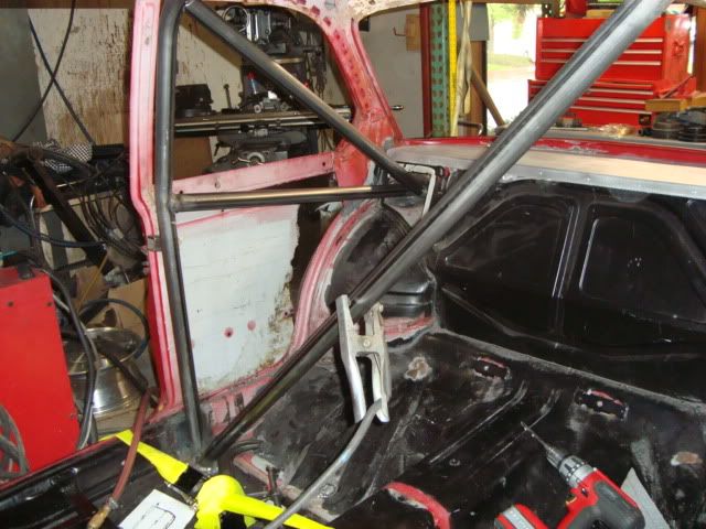

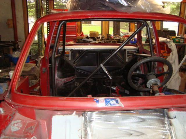

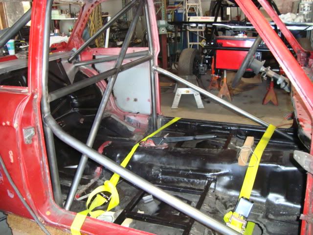

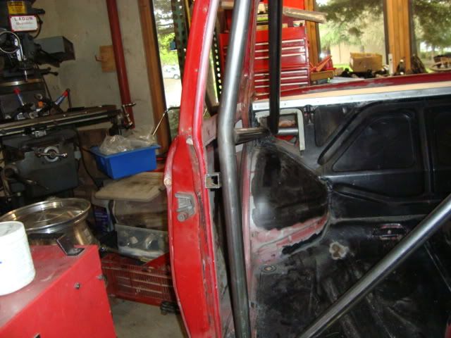

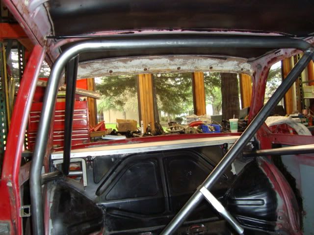

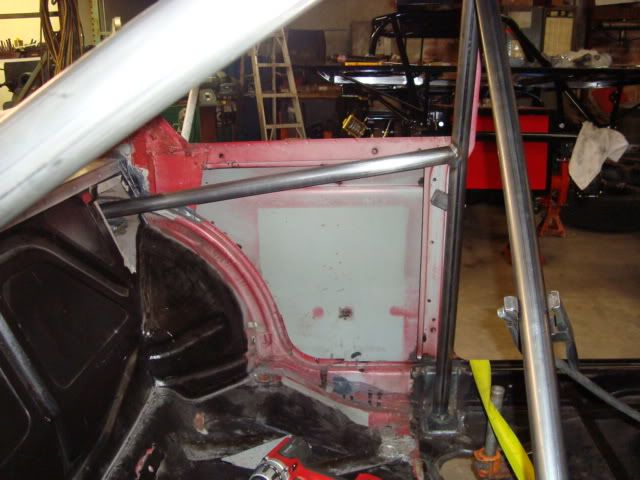

            Dad didnt go by the shop, Joe had apparently said yesterday he was going to email us pictures, and here they are...I can count 4 (edit-5)bars total that have yet to be welded in...
            I can't quite tell in the picture that shows the headliner bar that I left in it whether the bar was built a little high (whatever, headliner can stretch over) or if its flattened out (seems that way) and the bar built to its height, so the headliner might end up just touching or barely crowning over the top tube.
            We'll see how the seats fit, I was hoping the bar would be built just aft of the B pillar, but its right behind it. Probably won't be a problem though anyway. The only thing that might be close is the door bar that'll be going in at an angle - hopefully under where the trailing edge of the door arm rests are, but over the lower seat bolsters over their whole length of adjustment on the slider. We'll see.. I'd rather have to notch the arm rest than not be able to move the seat where I want it. But again, we'll see how that works out. He's got the dimensions of where the trailing edge of the arm rest point is, and one of the seats I'll be using in the shop too, so hopefully it'll be taken into account.

              Bar is done, and i have pics of it but there's a chance there may be a minor change/addition done to it so I'm going to leave out the pics till its resolved. Probably will go to check it out in person on Sunday.

                      Went to go check it out today actually to be sure I'd want to go through the trouble of getting the trailer up there tomorrow to bring it home.
                      Everything fits well, I have plenty of room from the inside of the forward down/door tubes to my side bolster on my seats, and with the headrest about an inch forward of the diagonal down tube in the main hoop, it feels like a good driving position.

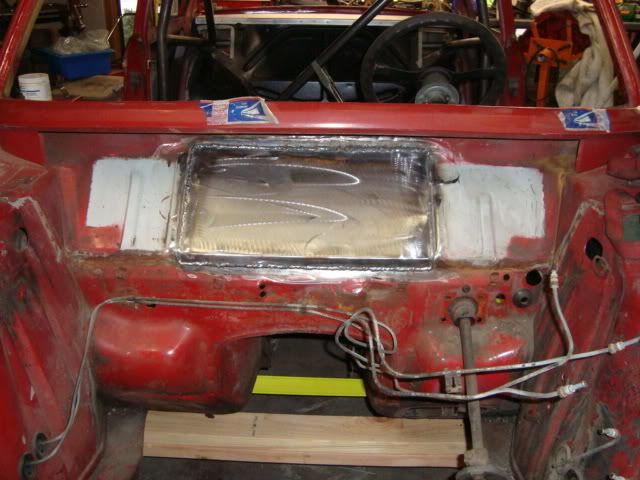

                              Shot of the heater box delete from the inside please?
                              • Justin B
                                Sikky Nar Nar
                                • Mar 2005
                                • 4273
                                #180

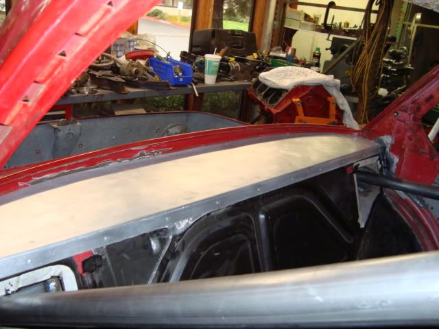

                                Sure. I'll have plenty more pictures to post tonight. Just checking up on the thread for now :) Got the car back, and went and raided the paint section at OSH. Primer and gloss black for the bar, black plasti-dip for my trim, and some cheap undercoating spray to cover up the aluminum parcel shelf and corner panels. I'll then pop rivet them back on, but as it is right now there's the chance of galvanic corrosion between the steel and aluminum. I'd rather that not happen...
