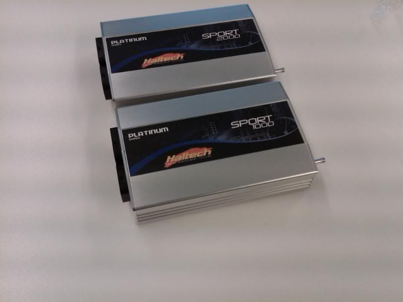

    another parcel arrived today the SP2000 is for the E30
    waiting on a wide band kit as well to come in a week or so when they have them in stock.

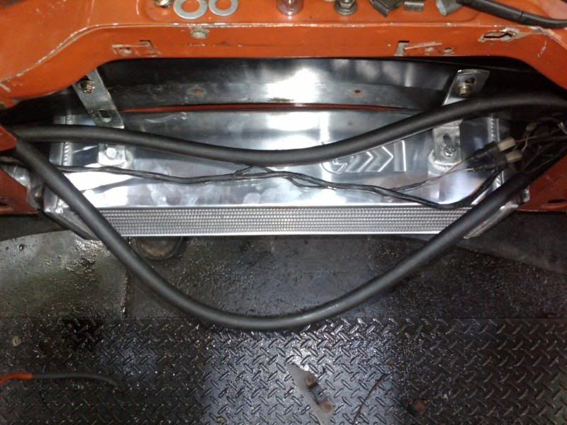

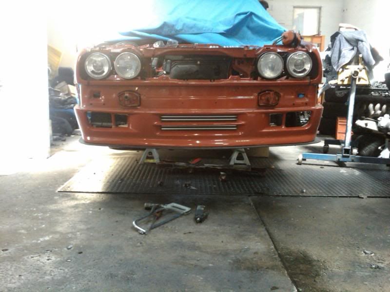

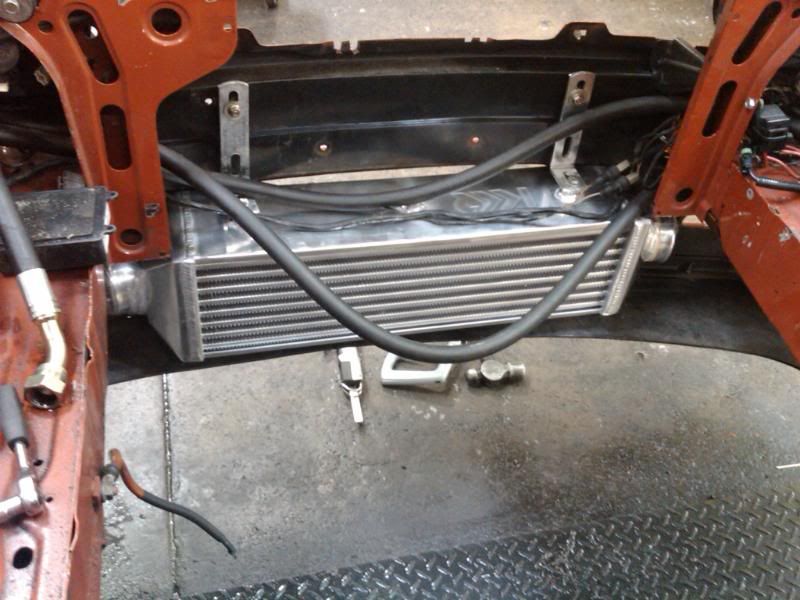

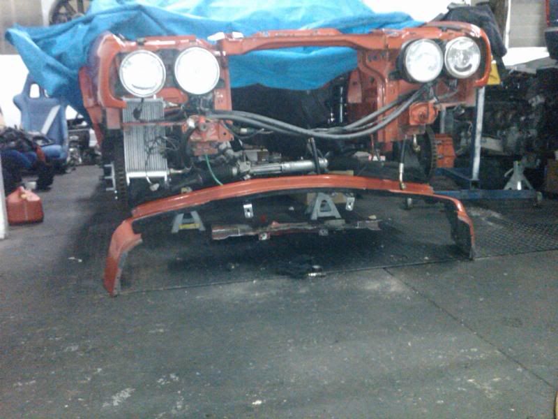

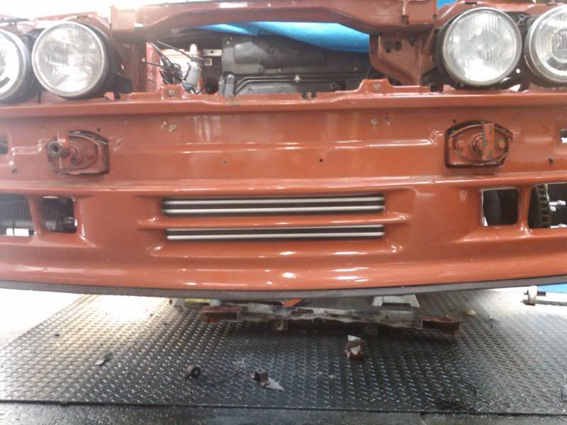

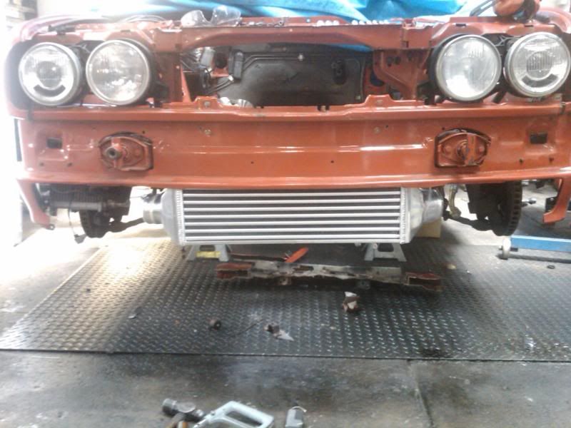

                  Small update. Mounted the intercooler yesterday. had to make a little room for it as its 130mm thick.
                  • lifeiskaos
                    • 1709
                    #99
                    holy shit that thing is wide. i love it! where'd you get it?
                    • tubby17s
                      • Nov 2007
                      • 85
                      #100
                      From a shop down here in aus. One of the best things about this intercooler is the end tanks point back at like 20 degrees giving you plenty of room near the brake ducts

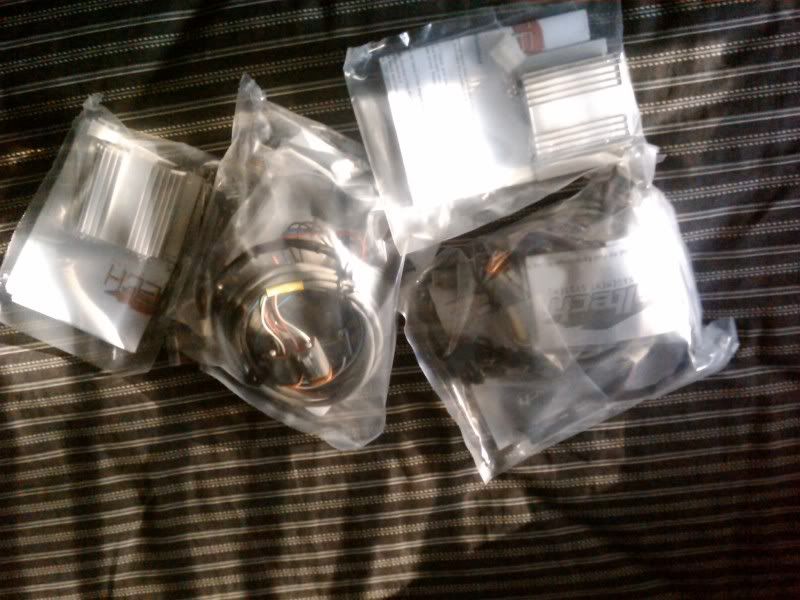

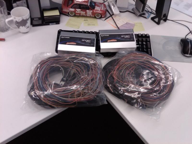

                              Recieved another 2 parcels today.
                              Wideband kits
                              Collector
                              • Iain
                                • Oct 2005
                                • 2815
                                #105
                                Wideband kits, mate?
                                Why multiple widebands?
