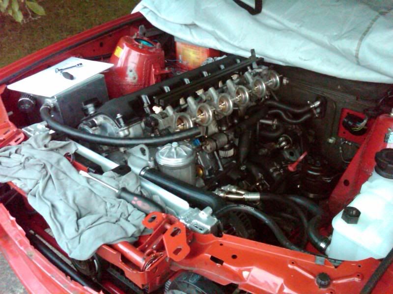

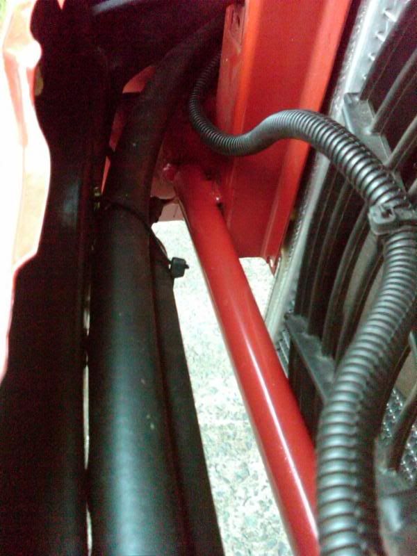

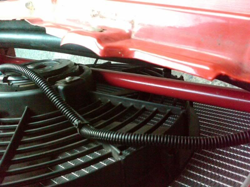

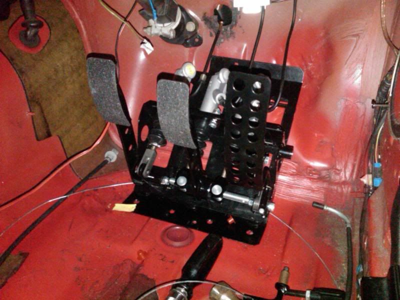

              stuffed it when installing the front brace and realised that i had put it in the way of where the electric fan goes.. grrrrr

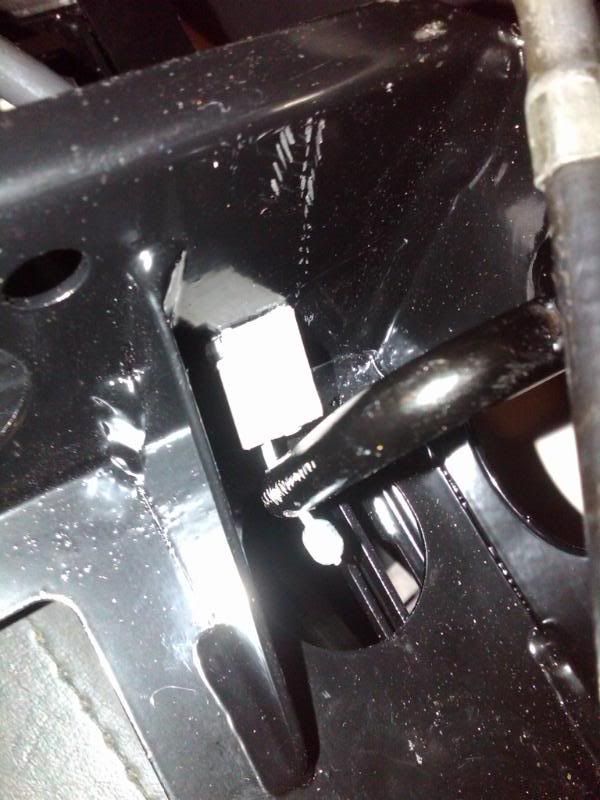

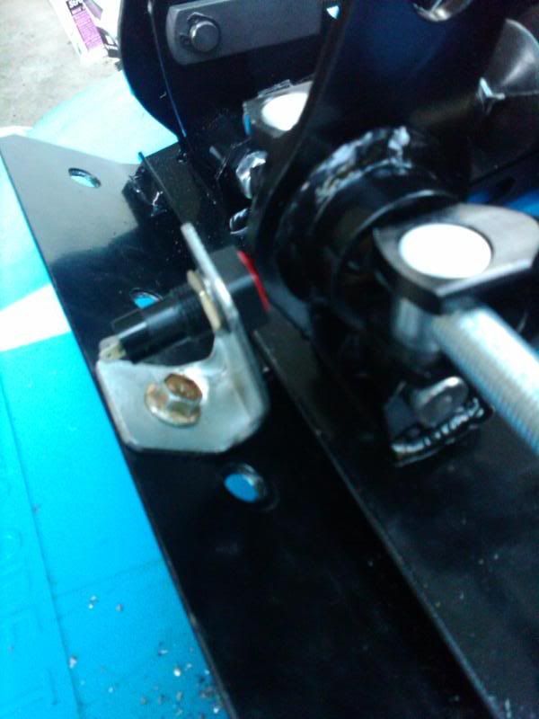

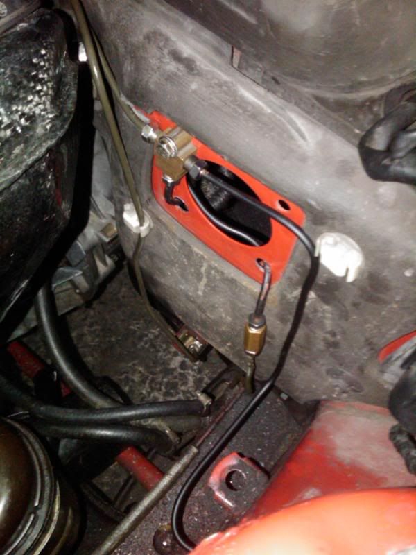

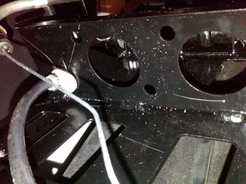

              started with the pedal box. bent up all the new lines
              brake light button

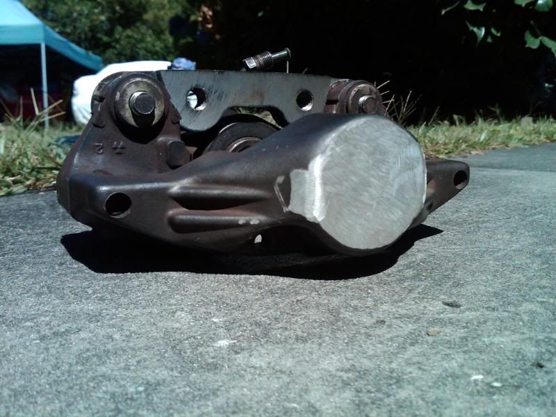

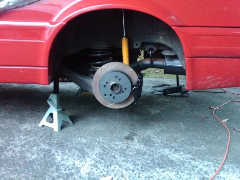

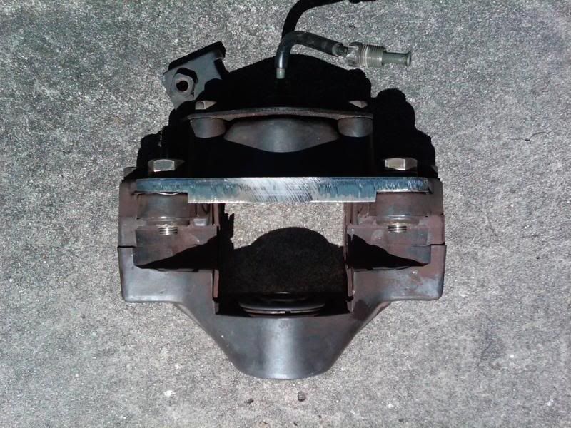

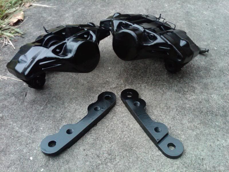

              Rear caliper bracket cut and trial fitted and nissan logo gone too

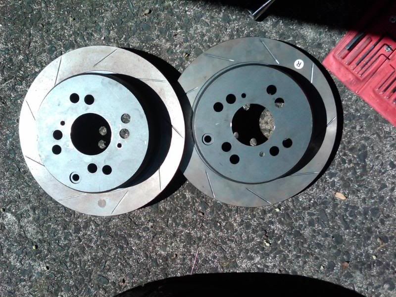

              discs

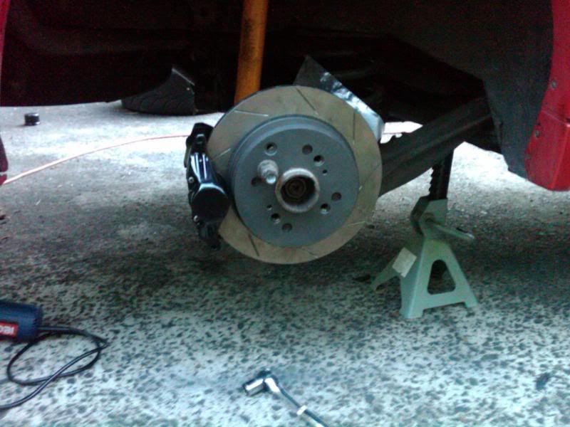

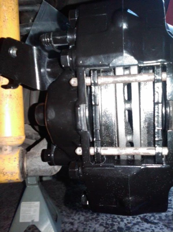

              rear calipers fitted with brand new high strength bolts

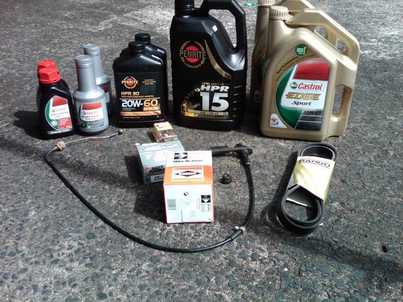

              some fluids for the car.
                What rotors/calieprs are those? Also what brand/model is that pedal box and how much goes?

                    It is an OBP and is a SHIT pedal box. i should have stayed with my tilton, which i will probably change over to later on down the track as its just sitting on top of my fridge. It was supplied with no way of attaching the accelerator cable, dosnt mount to the floor as advertised which they now admit. there was no brake light swtich mount as advertised blah blah blah. the list goes on.
                    The calipers are skyline R32 GTR calipers with Supra MA61 discs
                          Do the rotors have a drum for parking brakes?

                            Thanks
                            Yes they do have a rear handbrake drum
