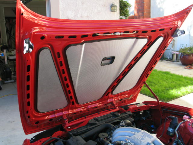

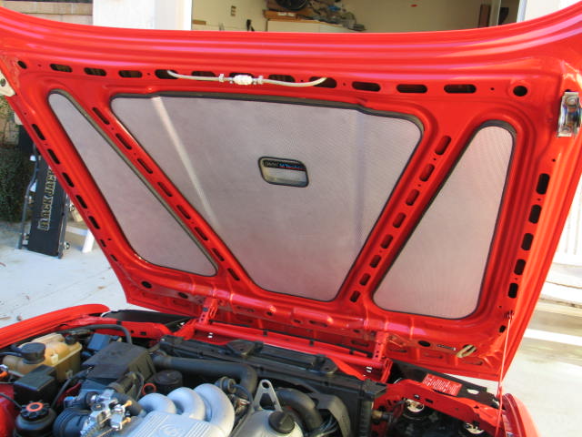

            Andrew,
            This is textured aluminum sheet (cut & bent to foam shape)over OEM foam insulation. Yes it does have "peel & stick" on the foam, but it needs additional adhesive & goes over the old glue just great, so don't wast your time trying to remove it. Result is quite & deflects heat. You'll spend @ $150 in materials & a lot of time shaping & bending. If you like the look, pm me for a list of locations for materials.

              Good to know! But I prefer the look of the foam itself. I'll stop right now with trying to get the residue off anymore (I trust you know what you're talking about :) ). What do you recommend for using to help adhere the foam to the hood?

                This stuff looks awesome.
