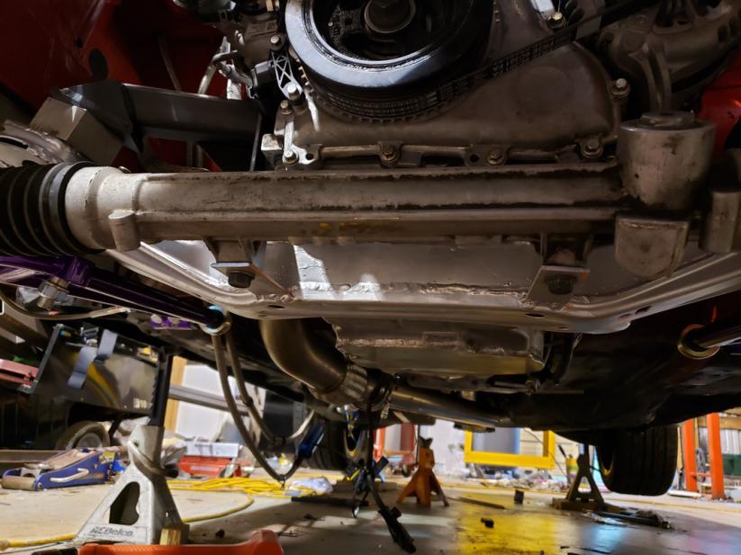

      this z4 steering rack combined with slr wide angle kit gives me an quick 2.5 turns lock to lock and thats with the wheels getting like 60 plus degrees of steering angle. excited to see how sensitive she is to steering inputs now.

      once again very very tight. had to trim alternator stud and cut down steering u joint shaft. notice the solid motor mount in the background

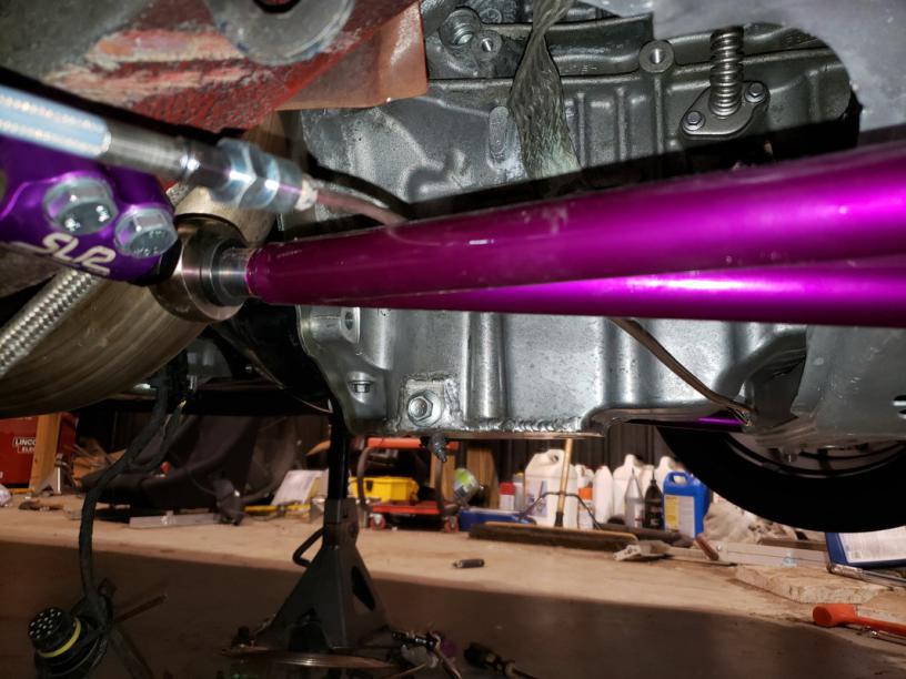

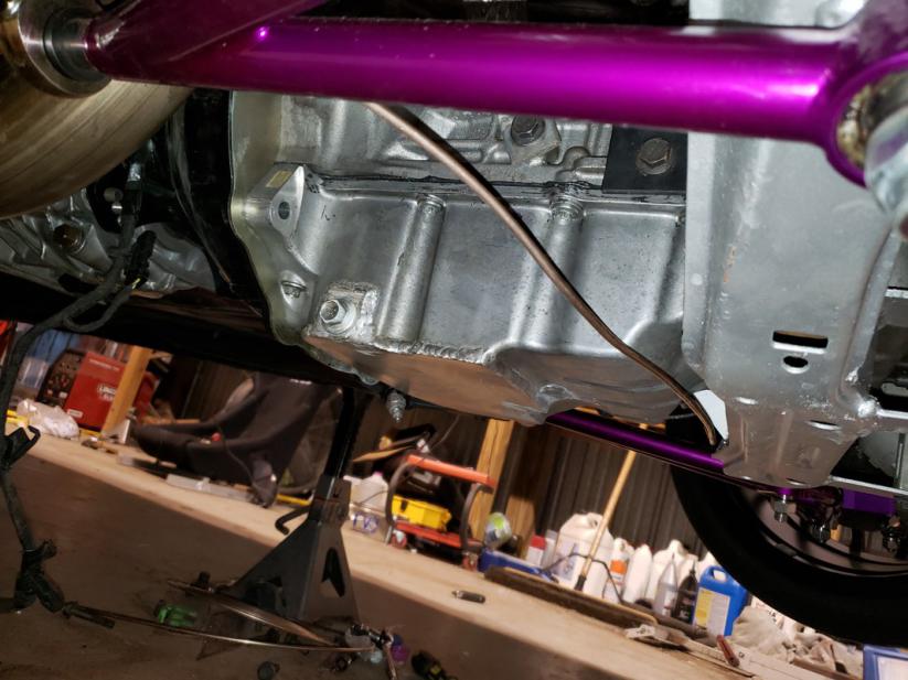

        pics of the shortened oil pan, im very satisfied how this came out aswell. the oil pan is now level with the front subframe and the bellhousing and now the exhaust is the lowest point on the car

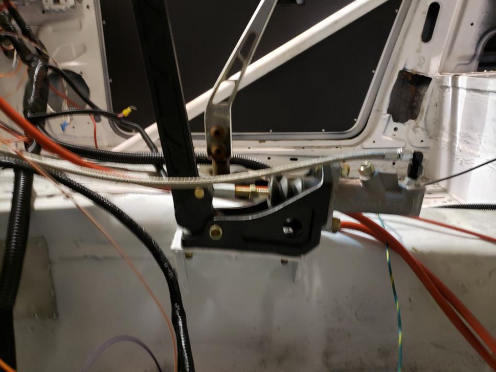

          hydro setup

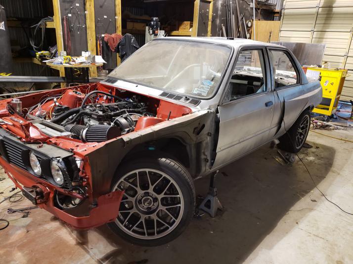

            Frankenstein's monster(i earned that name from the local car guys) as she sits right now:

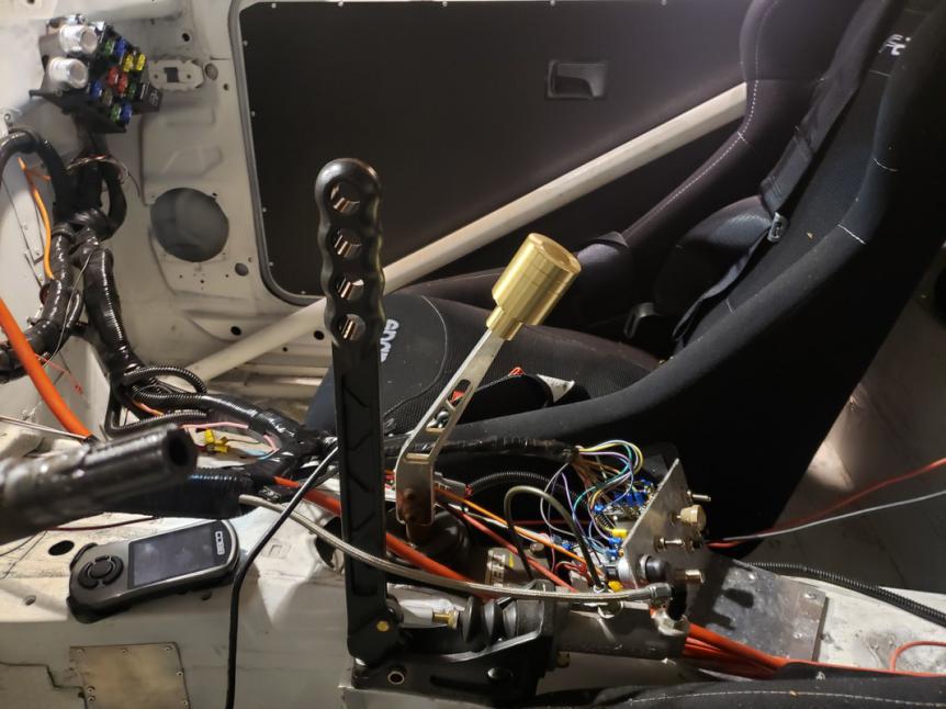

                                Made a custom shift knob out of brass for the car
