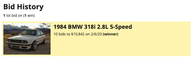

    I bought an E30 that was previously owned by two members of the r3v community (2man & CYN RNS) off of Bring a Trailer and this will be its build thread! I figured it would be fitting since it is getting a new motor and no longer will be the aluminum monster : ). The other thread that Simon (2man) has created for his build will still be updated periodically! Please check out my write up of purchasing this car and then going to Vegas to pick it up and attempt to drive it back to the East Coast:
    https://www.r3vlimited.com/board/for...ial-24v/page69
    Click image for larger version  Name:	Screen Shot 2020-05-14 at 2.28.53 AM.png Views:	0 Size:	50.1 KB ID:	9925457
