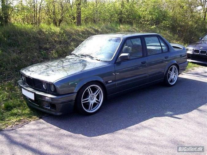

    This is my 3rd E30. Started with a delpin grey 1986 320i back in 2006. Owned it for about a year, when I got an offer I couldn't refuse. So, sold it, made some money and moved on to another project. A 4-door 325i M50 where I retrofitted an M-tech 2 kit, steering wheel, 4 x power windows, OBC, electric sun roof, new paint etc. A ton of work.. Unfurtunately, I had to sell the car to fund the deposit of an apartment. This was back in 2009.
    In the mean time, I finished my education (software engineer), got two kids, had several other BMW's (E46, E61 and G21). And then in 2017/2018 I couldn't resist the urge to get back in an E30, so I searched for almost a year to find the right 2 door facelift version.
    Since I'm living in Denmark (small country, cold climate, government hate cars etc.), it's not so easy to find a good example. In the end I bought a 318iS (really wanted a 325i, but what ever...). I knew there were some rust issues, but I thought it looked decent, so I figured it was repairable...
    The car had a repaint and actually looked pretty good except some bubbling in the rear arches, but as I started to dig into it, I immediately knew that the rust was just too much for me to handle (never welded before). The previous owner/or workshop did a horrible job on the previous rust repairs.

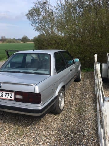

    My first E30 - the car that started this crazyness.. German import - mint condition rust wise. Should never have sold it. Houndstooth sports interior.
    Click image for larger version  Name:	IMG_0581.JPG Views:	2 Size:	75.0 KB ID:	9955379
    My second E30. M50B25 engine, M-tech 2, E36 front sports seats, E36 M3/Hargte exhaust etc. Major project too. I have an old thread on R3v somewhere.
    Click image for larger version  Name:	36188210_10156379869473490_1705893557509816320_n.jpg Views:	2 Size:	58.8 KB ID:	9955380 Click image for larger version  Name:	36268066_10156382202488490_7931218073447563264_n.jpg Views:	2 Size:	28.3 KB ID:	9955381 Click image for larger version  Name:	36269149_10156379870023490_2553027422299619328_n.jpg Views:	2 Size:	51.7 KB ID:	9955382

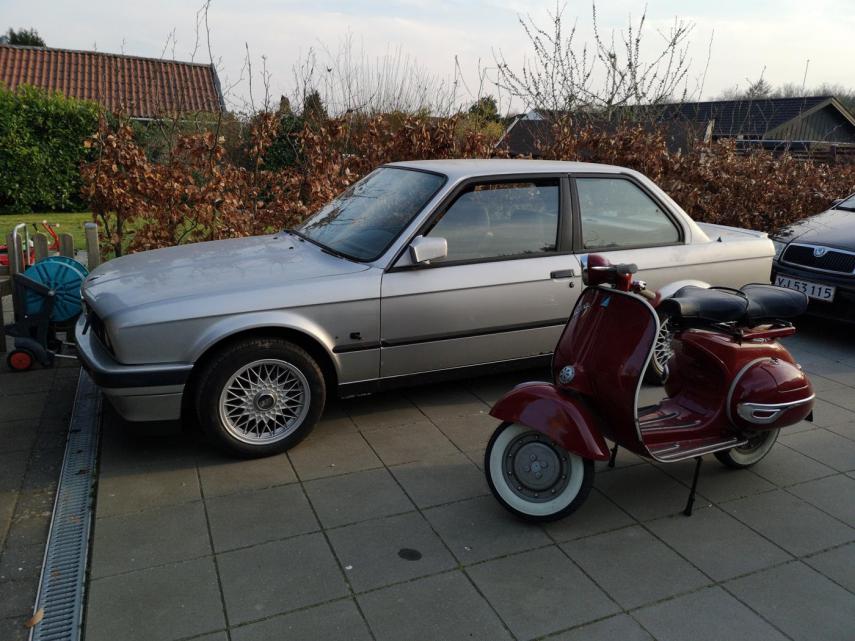

    My third E30. Pictures from the sales add. I sold the wheel, bought some 15" Euroweaves instead. Also removed that ugly paint from the rear taillights.

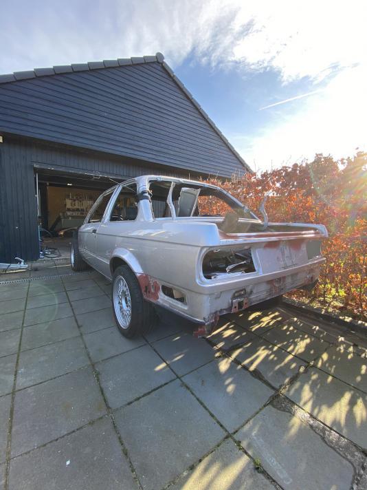

    The car is build in january 1990, but registered in 1991. It come with almost no extras. Only extra is pop-out rear windows. Black headliner is standard on the danish 318iS. This means, no power windows, no central locking, no ABS, no sun-roof, no rear speakers, no power steering, comfort seats, no A/C - NOTHING!

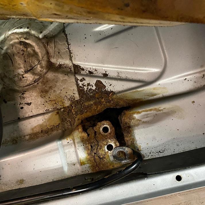

    Rust
    Click image for larger version  Name:	image_155785.jpg Views:	3 Size:	84.6 KB ID:	9955385
    Click image for larger version  Name:	IMG_1810 (1).JPG Views:	0 Size:	51.0 KB ID:	9955387

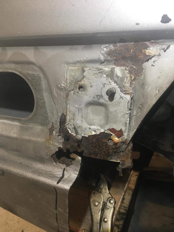

    This is just some of it. I have rust in all rear arches, inner arches, tailpanel, plates in the engine bay (underneath the washer fluid reservoir) etc.
    I'm sure that in the US, most sane people would've scraped the shell and found another. But, that's not so easy, as all E30's in Denmark are either rusted to death or crazy expensive (due to our tax system).

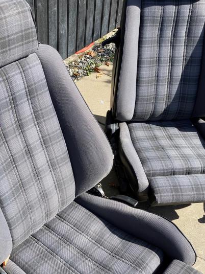

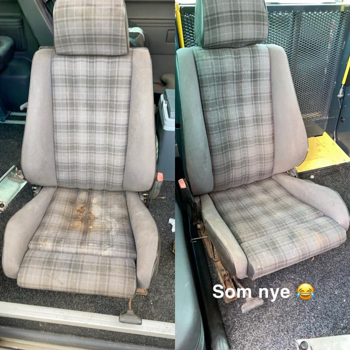

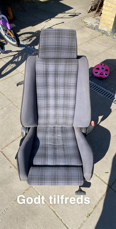

      One day I stumbled across these seats at the other end of the country and knew I had to buy them. They never come up for sale in Denmark:
      Click image for larger version  Name:	6E58CA15-CBFF-44B1-936F-E05D0A7BF82E.jpg Views:	0 Size:	92.3 KB ID:	9955398
      They were so filthy and torn apart, but I knew they had potential. After a lot of searching i finally found the bottom part of the seat in UK, so I could restore my torn up passenger seat:
      Click image for larger version  Name:	IMG_1006.JPG Views:	0 Size:	56.0 KB ID:	9955399

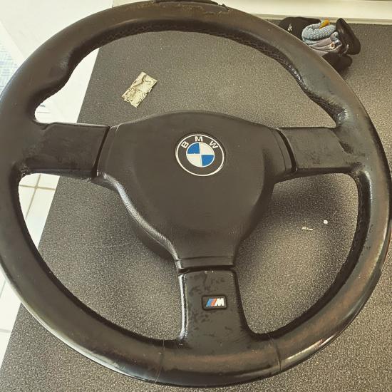

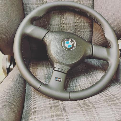

      I also found this 370 mm M-tech 2 steering wheel in a bad condition, but super cheap (like 63$ dollars). I sent it off to Germany to get some new leather:
      Click image for larger version  Name:	rat.jpg Views:	0 Size:	57.1 KB ID:	9955400
      Before (leather is torn up)
      Click image for larger version  Name:	rat_efter.jpg Views:	0 Size:	51.3 KB ID:	9955401
      After

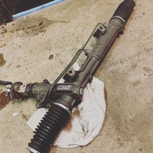

        E46 steering rack

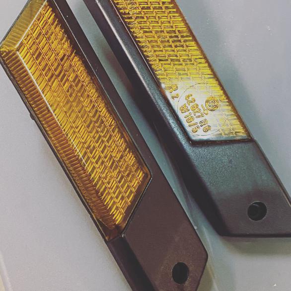

        OEM sidemarkers

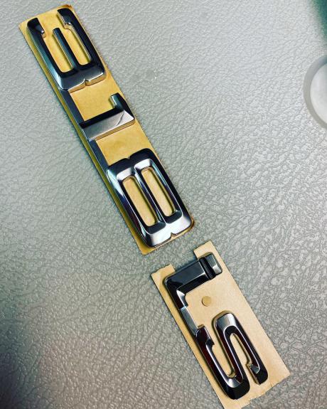

        New badge

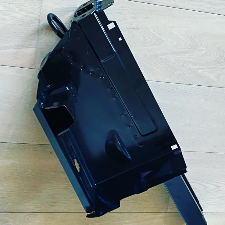

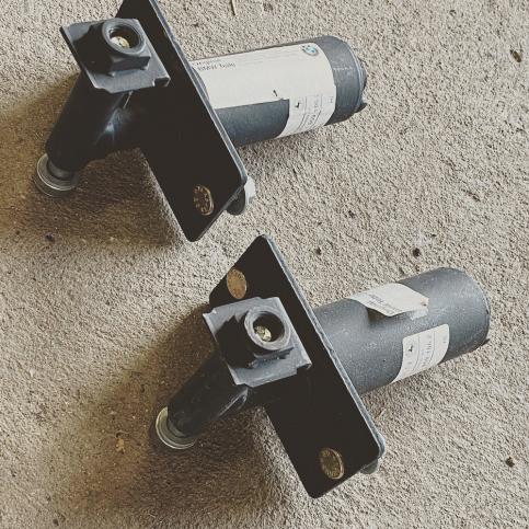

        Rear bumper shocks (NOS). My car had a trailer hook.
        Complete new rear battery pocket! (NLA).

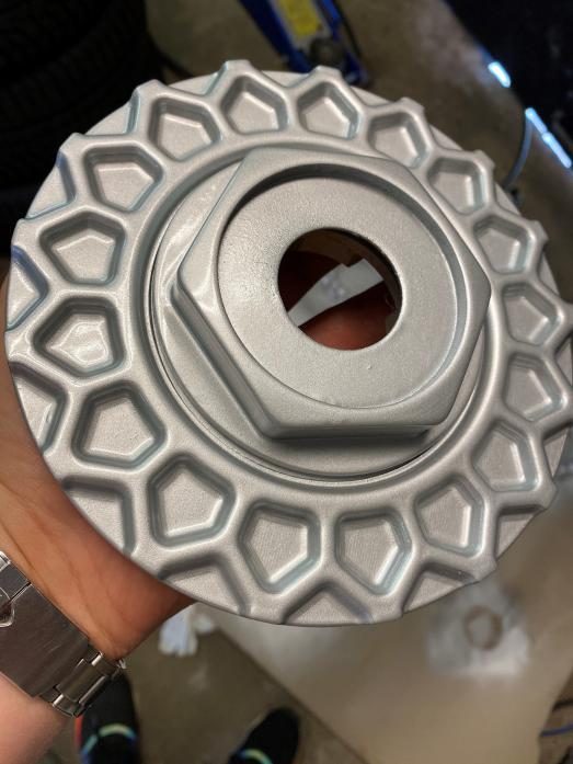

          On facebook I found a guy who creates custom 3D printed centers, so I obviously needed that in my life.
          Click image for larger version  Name:	IMG_1578.png Views:	0 Size:	122.7 KB ID:	9955410
          Stock center caps
          Click image for larger version  Name:	IMG_1577.png Views:	0 Size:	113.7 KB ID:	9955411
          Custom 3D printed center caps

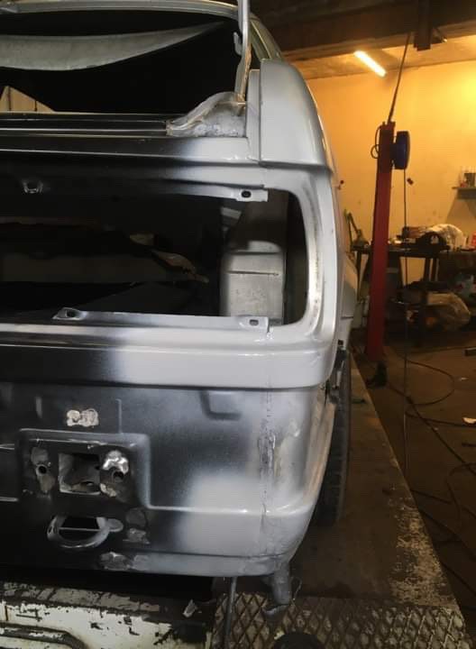

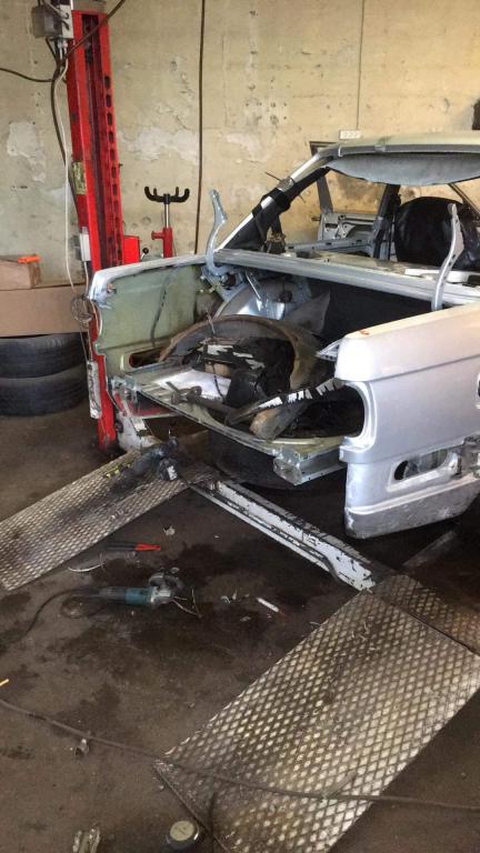

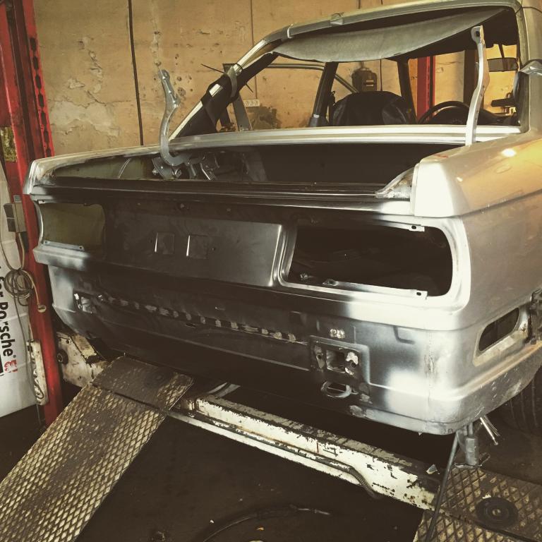

            So, I sent the car to the body guy who started of with ripping off the tailpanel. It had a bad repar in the past (overlaying metals and rust in between). Also some minor holes around the number plate lights.
            His recommendation was to change the whole panel, so he did:
            Off came the ass..
            New shiny ass..
            He also put in the new battery pocket and tow hook.
            Then corona came and all progress stopped.

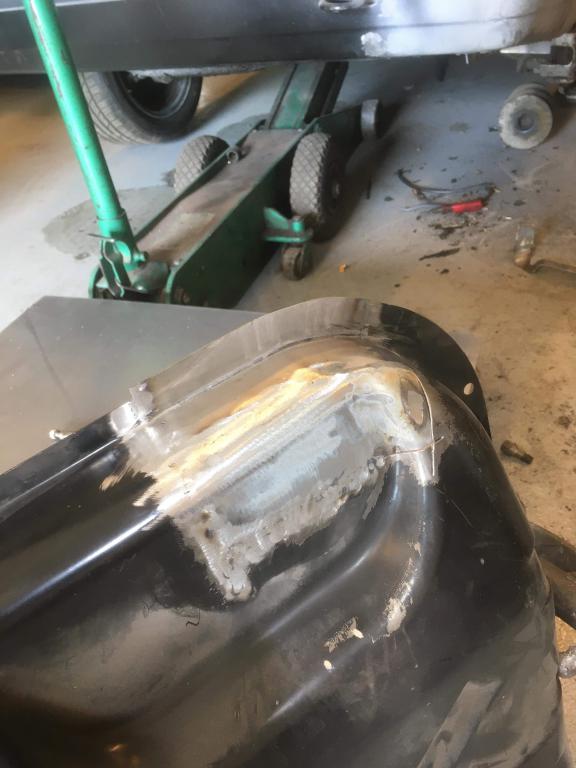

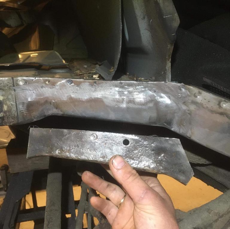

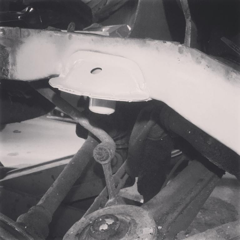

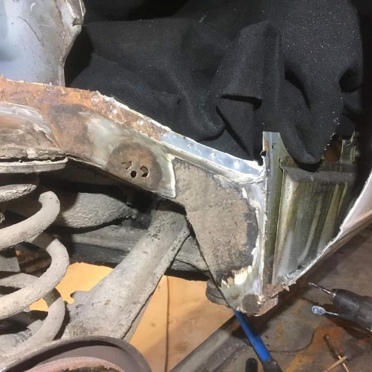

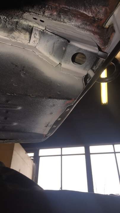

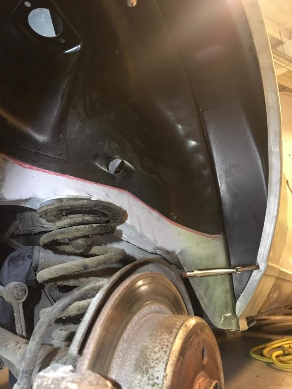

              After a few months of zero progress work, he ripped out the right inner arches as they were really bad. I managed to source both the inner and outer arches. They were new, but with some cut outs.
              He then noticed that the frame rail was rusted, so he took care of that and a new spring pad mount was fitted.
              I hate you rust!!!
              Fixed frame rail.
              Frame rail done. Sorry for the black/white instagram filter.

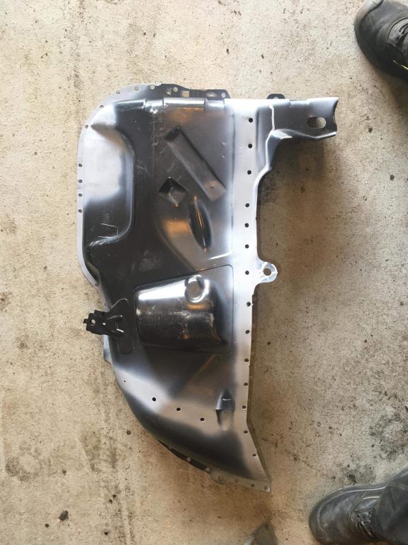

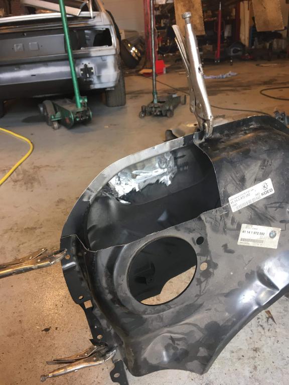

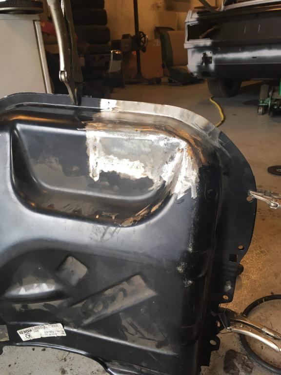

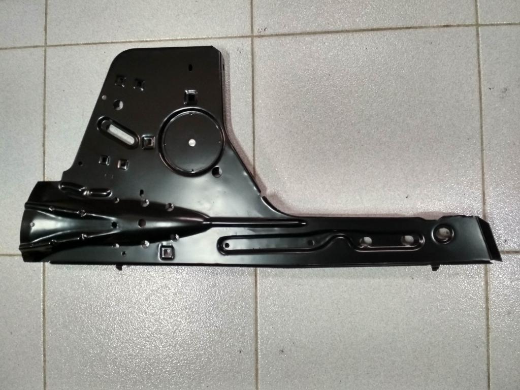

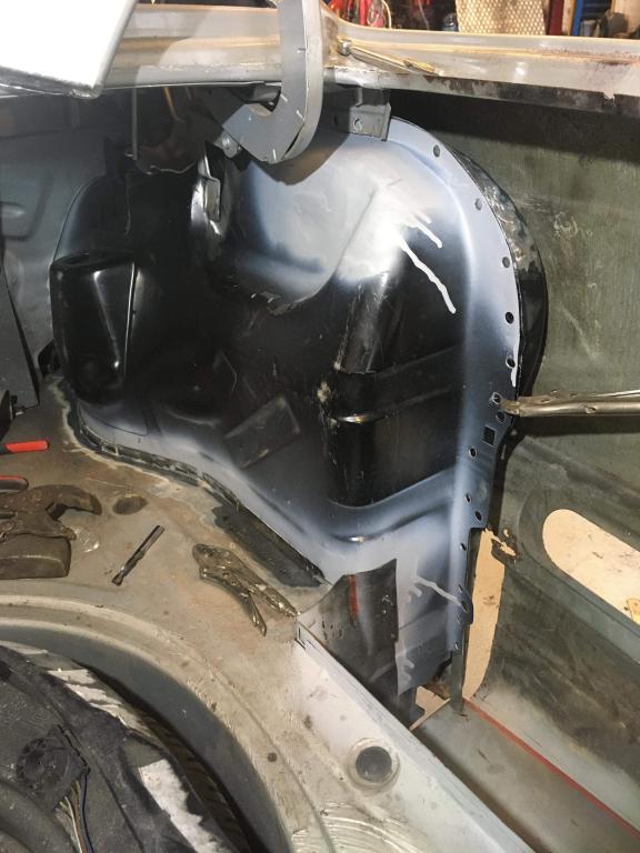

                So, after fixing the frame rail, the lip on the trunk floor, he continued to fix the inner arches that I bought.
                Like i said, they had some cutouts, but still brand new and never fitted.
                I think they came out pretty good. Def. better than what I had before. Also considering they are NLA - this was the best I could get.

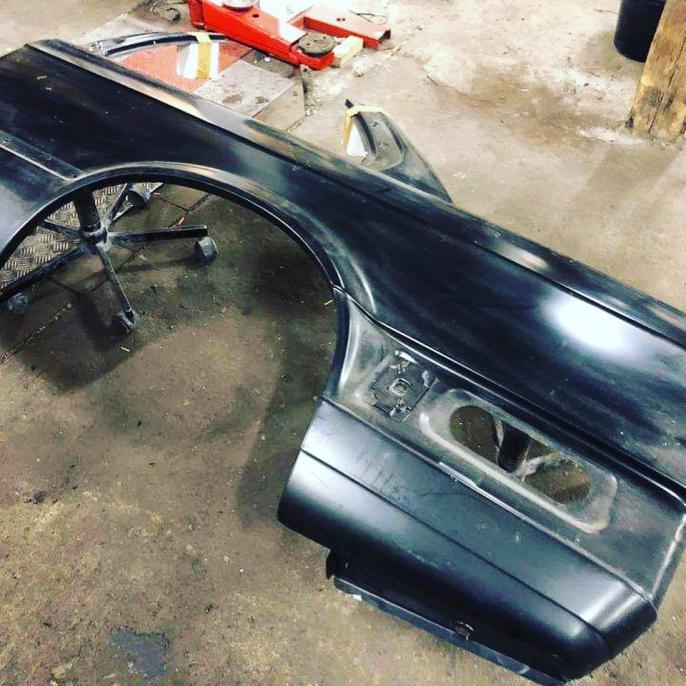

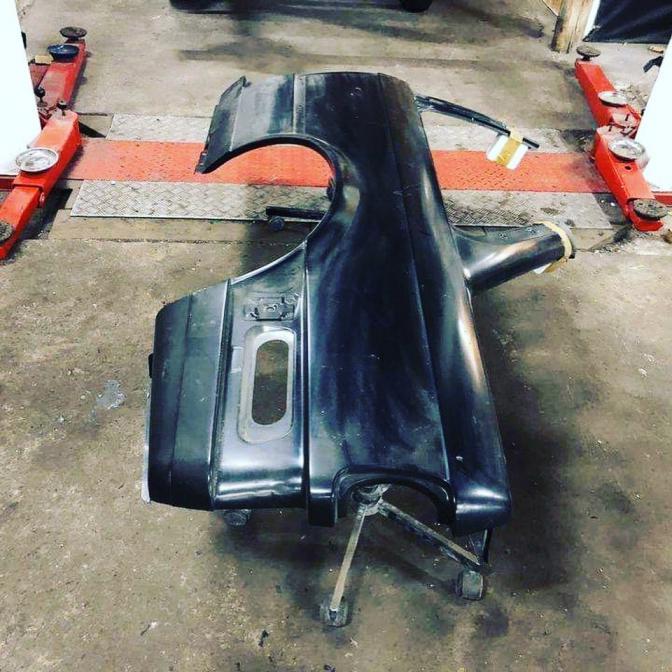

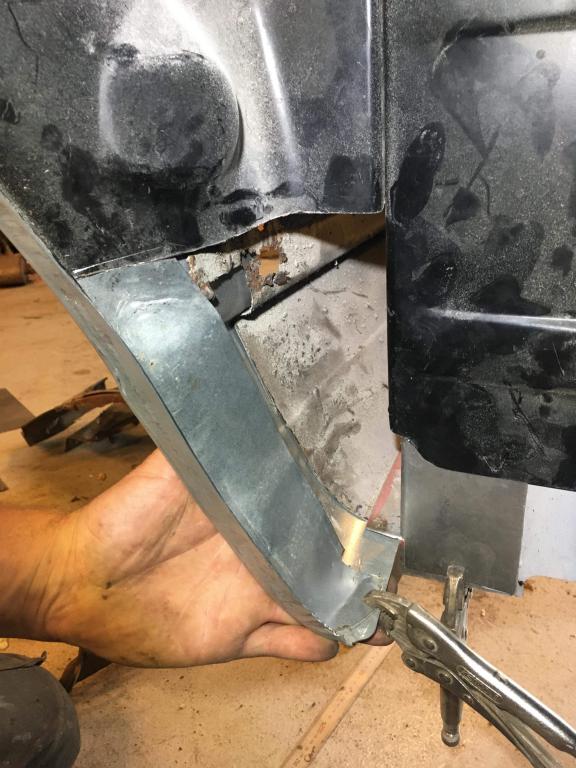

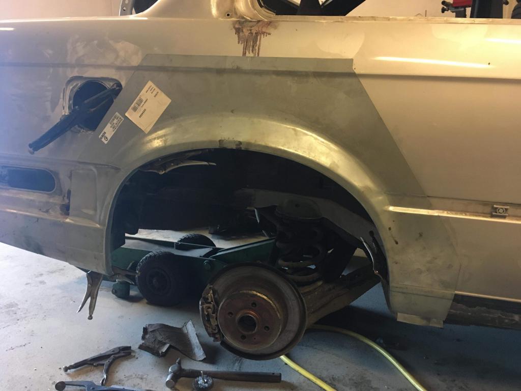

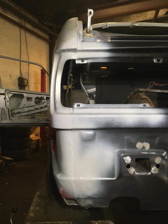

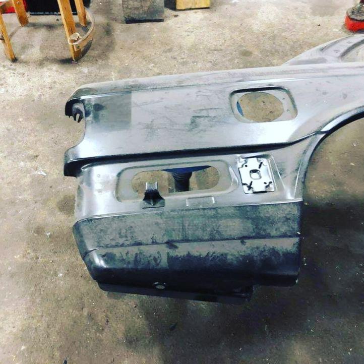

                    This is almost where were are at today. The inner arch is welded in, the outer inner arch is not. Why you might ask?
                    Well.. The plan was to just fit new outer arches like this:
                    Click image for larger version  Name:	IMG_1854.JPG Views:	0 Size:	69.0 KB ID:	9955436

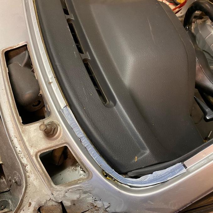

                    Then he discovered rust around the fuel cap area, some rust where the rear pop out window is, rust at the jackpoint in the side panel AND also some bad rust where the bumper mounts are. The inital plan was just to fix all the different areas, BUT then I stumbled upon these babies on facebook:
                    Click image for larger version  Name:	6C331685-D2B6-425A-B2D1-6EA3327802CD.jpg Views:	0 Size:	80.2 KB ID:	9955437
                    Click image for larger version  Name:	D724B8FC-09F7-4BD2-A874-068186C3C914.jpg Views:	0 Size:	81.4 KB ID:	9955438
                    Click image for larger version  Name:	E434F44C-B121-4C49-96EF-CD149C7A36A2.jpg Views:	0 Size:	79.6 KB ID:	9955439
                    And i figured - why not do it properly instead of all those patches 8-)
                    Right now, I'm waiting for the body guy to finish some other work and then he will continue with replacing the outer panel and get rid of all those bad areas. After that, he will repeat the same process on the left side of the car :-/
                    Goodbye money......

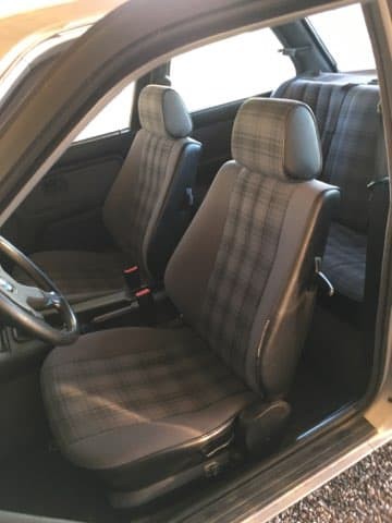

                        The seats all cleaned up and done.

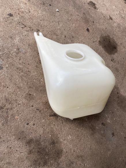

                        The NLA fluid reservoir all cleaned up and ready to go. New cap installed from a Mercedes.

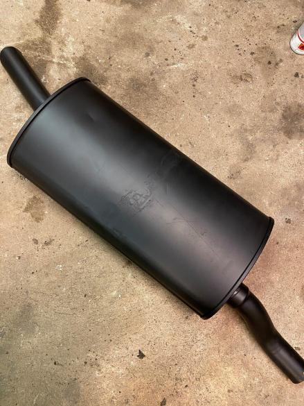

                        A used muffler that I cleaned up and repainted.

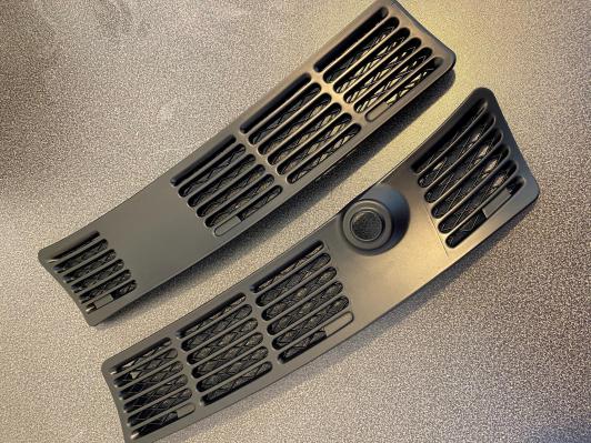

                          Covers were faded and just ugly, so gave them a quick paint.

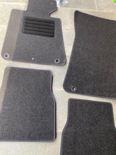

                          Some new oem floor mats just waiting. Probably gonna wait a while....
