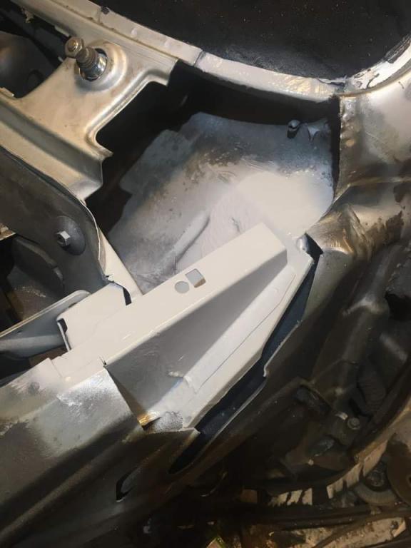

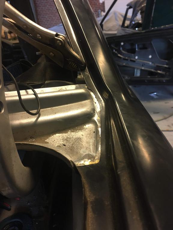

            So, the body guy has been working on getting everything ligned up and fitting well. The inner arch is sitting good and ready to be welded in after that the outer quarter panel should be fitted for good. He also fitted the new door and got i fitting pretty good!
            I think all the gaps etc. looks spot on.

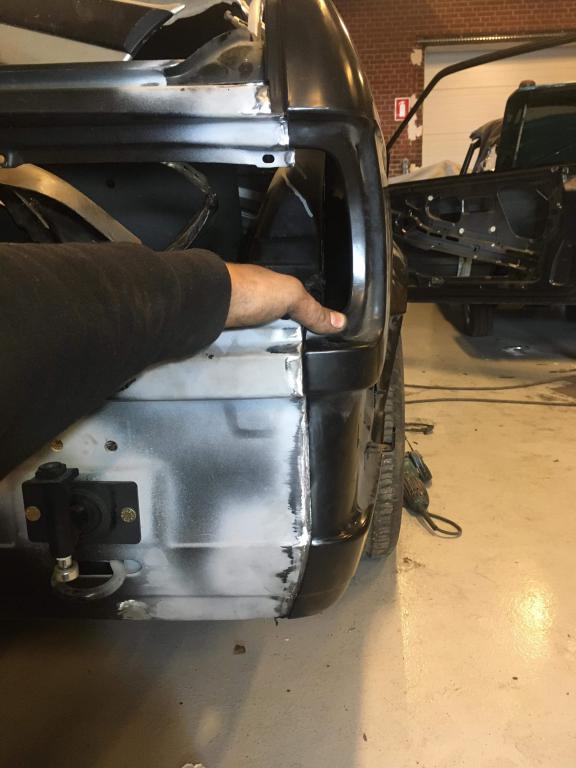

              #36
              Inner arch fits well within the fuel cap area.

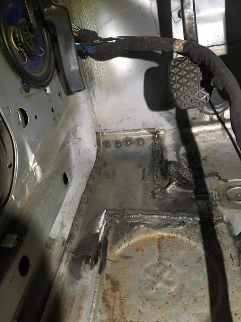

              The all new battery box, inner arch and flooring in place.

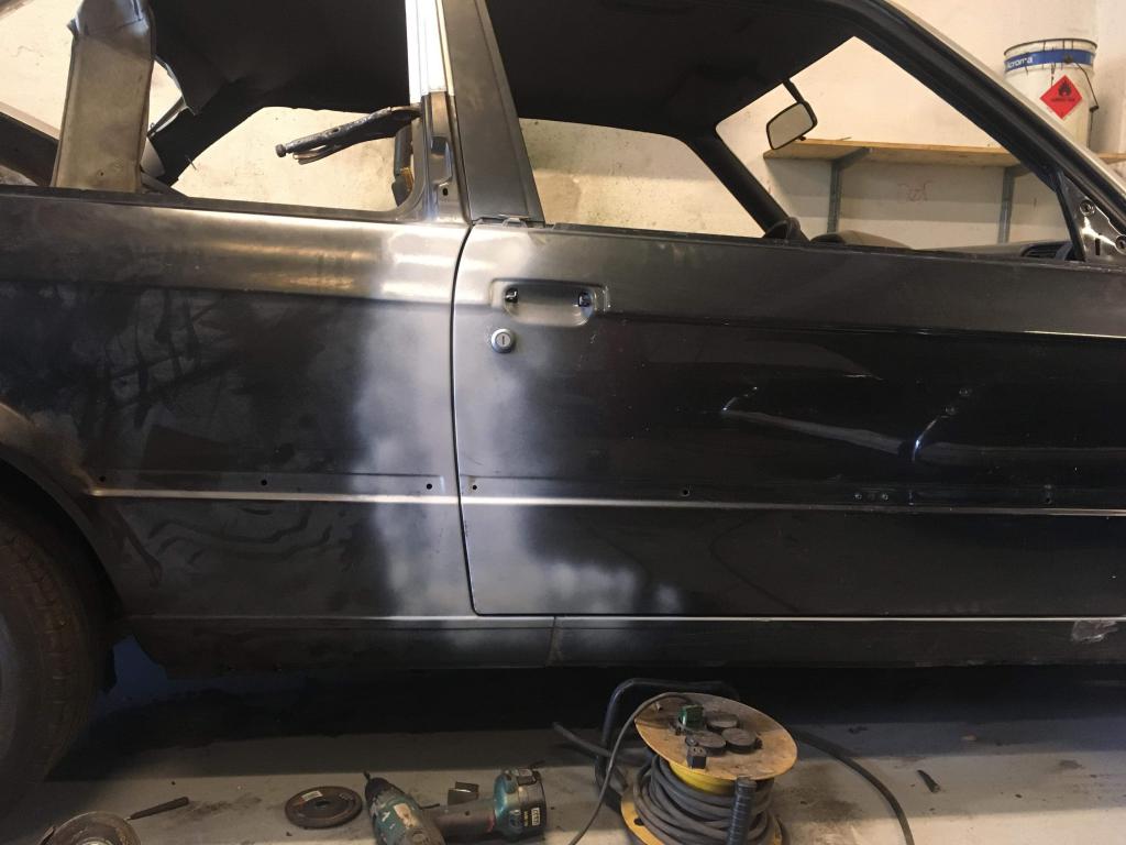

              Door/quarter panel fitment. Looks good to me. What do you guys think?

                Panel fit looks great all around. That door gap can be a real pain at the top corner where it meets the door (at the B-pillar)....amazing how many pieces come together in the lower battery tray area. Your body guy is doing great work.

                  Thanks! Yeah, it's funny how "complicated" such a small area is :-)

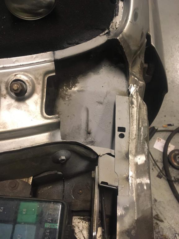

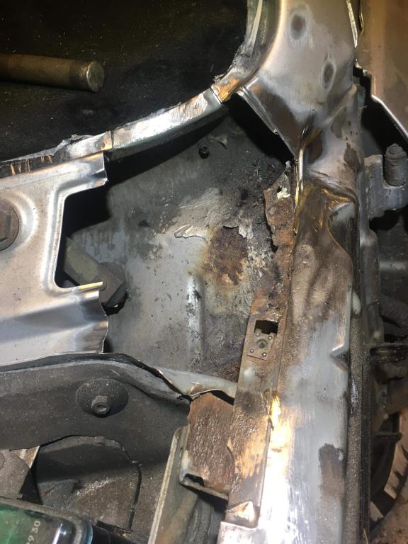

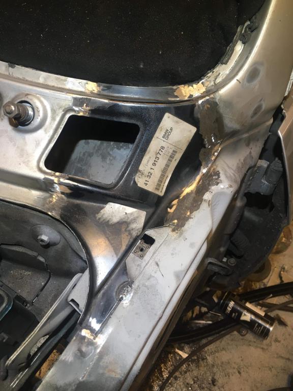

                            #43
                            I haven't updated this thread for a while. It's pretty time consuming to do, which is why I tend to update my instragram profile instead. Anyways, I'll try to bring it back to life.
                            So, since my last post, the body guy removed the left quarter and discovered a pretty shitty inner arch. I already knew this and hence bought another inner arch. Unfurtunately, this is kind of rusty as well.
                            Right now I'm trying my best to source a new/better, but they are REALLY hard to find. SO, if anyone in here has somethinh laying around, please let me know!
                            So, in the mean time, while waiting for better parts, the body guys has been to work on other areas. The "jack point" and flooring was gone, so they fabricated some new pieces for that area:
                            As you can see, the inner part was fixed as well as the flooring. They tried their best to replicate the OEM look. Think it looks decent. Needs a bit of grinding etc. still obviously.
                            Here's the outer part. Still needs some work and also the 'box' needs to be welded on too. As you can see the outer panel also needs fixing.
                            Other than the flooring they also worked on the windshield area. This was worse that it appeared at first. They had to cut a 'window' to be able to fix it properly and then close that window again.

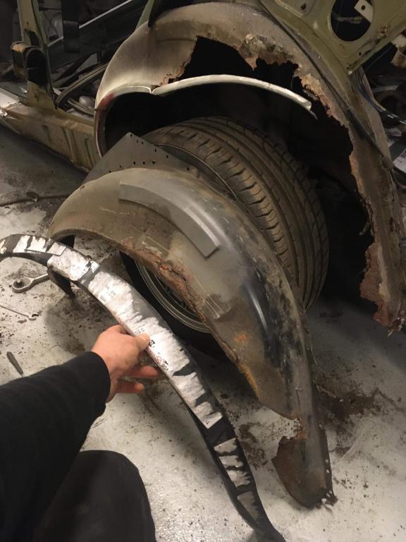

                                #45
                                Outer left quarter removed.. Luckily it only seems to be the inner arch thats fucked up. Rest looks okay.
                                As you can see - my own is toast. My other used arch is also pretty bad and the repair piece isn't covering it all. Bummer..
