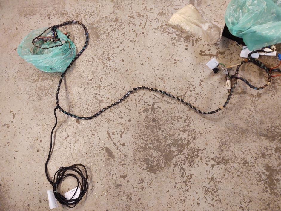

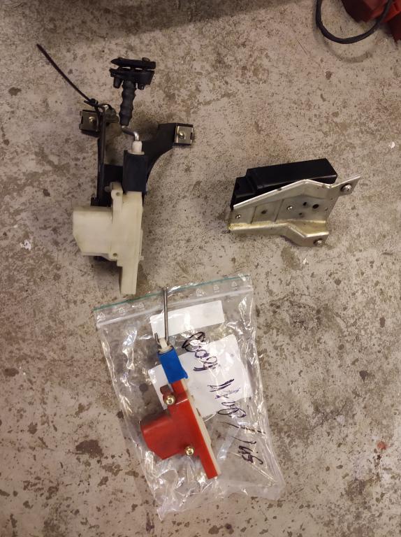

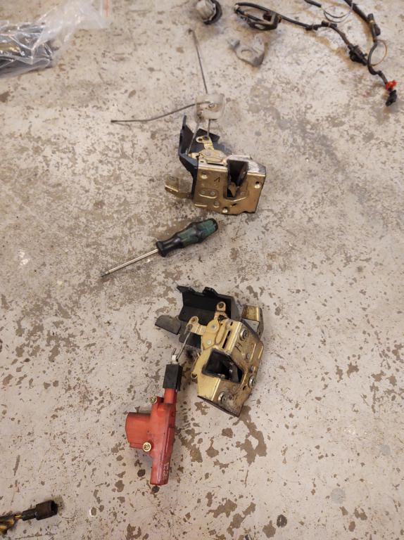

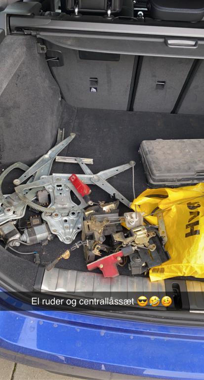

                    With the said.. I just got some pictures this morning of the wiring and other stuff needed to convert to power windows and central locking:

                    This should be fun :-D

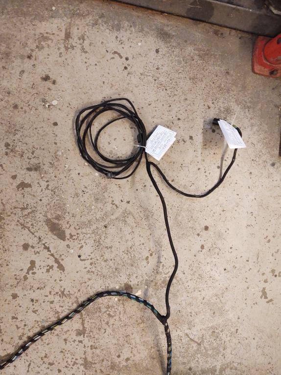

                      Not the most exciting update, but the wiring, power regulators, buttons, central locking relay, motors etc. has arrived. The wiring loom is from a 4-door, but that shouldn't be a problem.
                      I got extra locks for central locking, but it turns out that the locks, that came with the car, was already prepped for central locking, so that was a nice surprice.

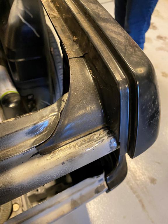

                      I visited the body shop and took some pictures the other day, thought I would show them to you. Personally I've had a hard time finding pictures of the joint between tail panel and quarter panel:
                      This is how i looks before fitting and welding.
