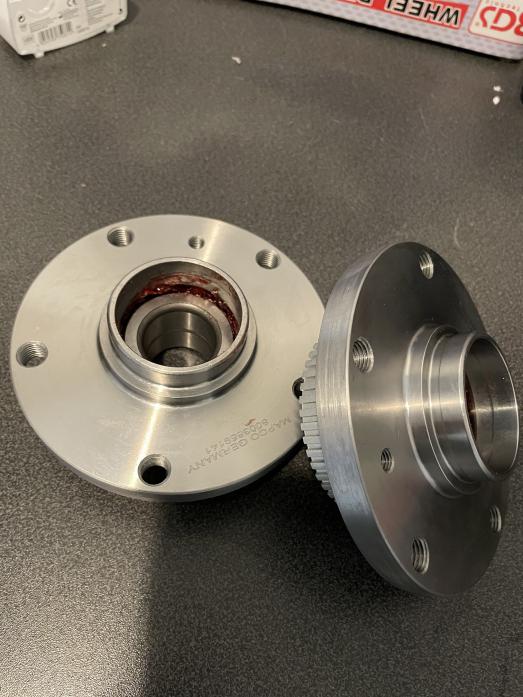

                      Got some pretty cool hubs a few days ago. These, supposedly, fits the std. E30 strut housing, but with 5x120 PCD instead. This means I'll keep the stock geometry.
                      Now, the real issue with this is basically the brakes. I have a few different setups that *should* work, but haven't tested it personally (..yet).
                      Click image for larger version  Name:	IMG_0461.JPG Views:	0 Size:	57.4 KB ID:	9969687
                      Based on my "research" the following options should work:
                      Options:
                      1.
                      E30 M3 brake discs (280x25mm) with Ford Focus mk 2 brake calipers (The 278 mm disc version for smaller petrol engines like the 1.6). Requires a spacer from 79 -> 66 mm to center the disc on the hub.
                      2. VW Golf 4 1.8T brake discs (288x25mm) re-drilled to 5x120 PCD and drilled 65 -> 66 mm center with Ford Mondeo mk 3 brake calipers. Might require a small spacer to prevent the wheel from touching the caliper dependent on the wheels offset.
                      3. VW 312x25mm mm brake discs re-drilled to 5x120 PCD and drilled 65 -> 66 mm center with Ford Focus ST 225 brake calipers. Might require a small spacer to prevent the wheel from touching the caliper dependent on the wheels offset.
                      Calipers should all bolt up to the std. E30 front strut housing with some minor adjustments to the strut housing. The front strut "ears/holes" for the brake caliper shold be opened op a tiny bit, like 0.5 - 1 mm to fit the calipers.
                      Please note, that I haven't tried anything of the above! Just put this information together from talking to people running with above configurations on std. 4 lug hubs. But, since the 5x120 hub keeps the dimensions of the E30 hub, I think it should work.
                      I'm going with option 1 as it should clear my wheels and look "OEM". I don't want to attract too much attention when going to inspections.

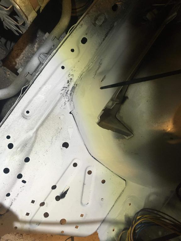

                        #56

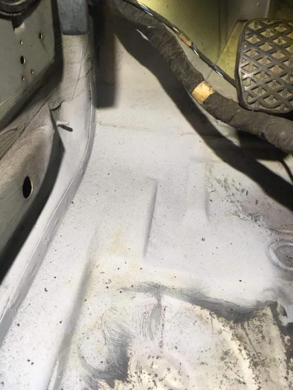

                        So, yesterday the flooring in the drivers side was completed. Really happy with the result!

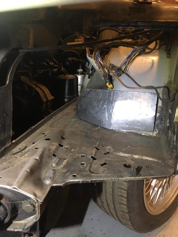

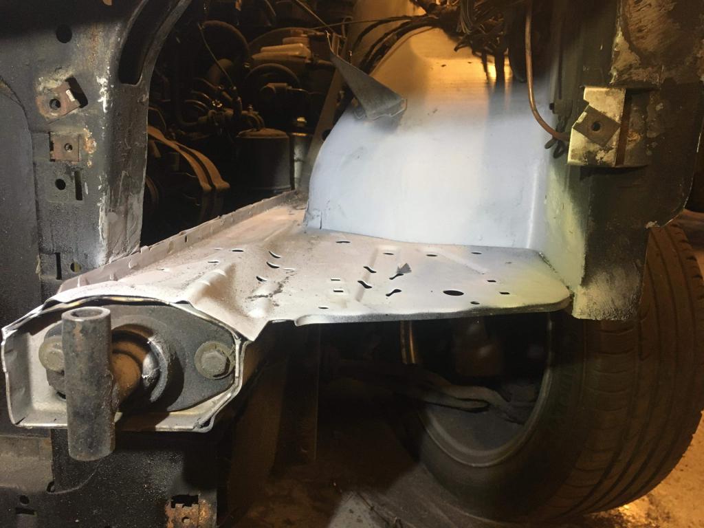

                        Work has now begun in the engine bay/wheel housing. Some very poor metal work has been done to that area in the past, so that will be cut out and replaced:

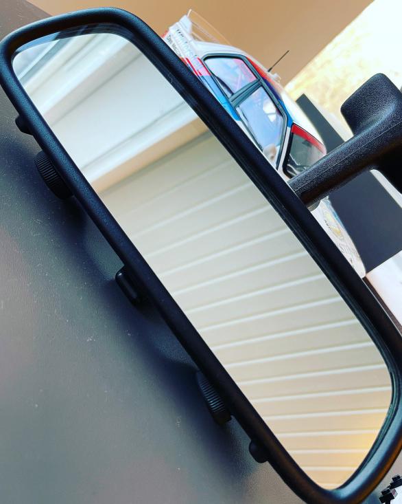

                          I also, finally, got my hands on a m-tech 2 rear mirror with map lighthing. I've been back and forth with the seller for two years before he finally went and picked it up at his garage. Got it for a fair price and it looks to be in good condition.

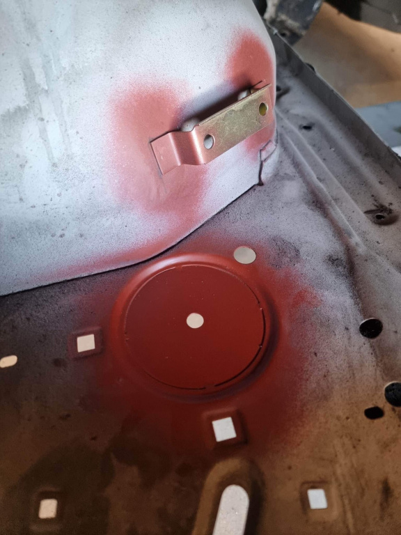

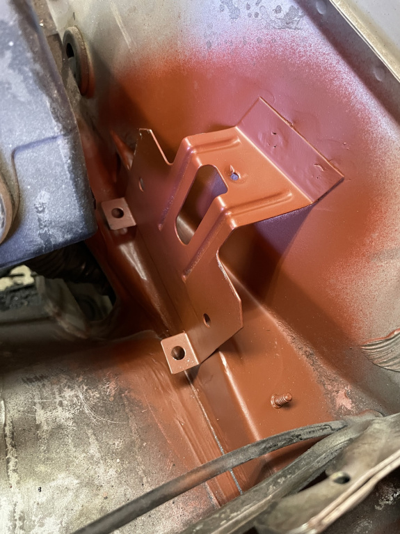

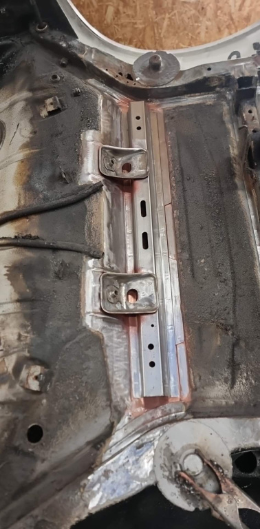

                          Rust in the left side of the engine bay is now done! I think it came out really nice.
                          Still a bit of grinding and seam sealing left, but no big deal.

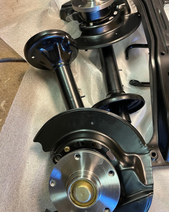

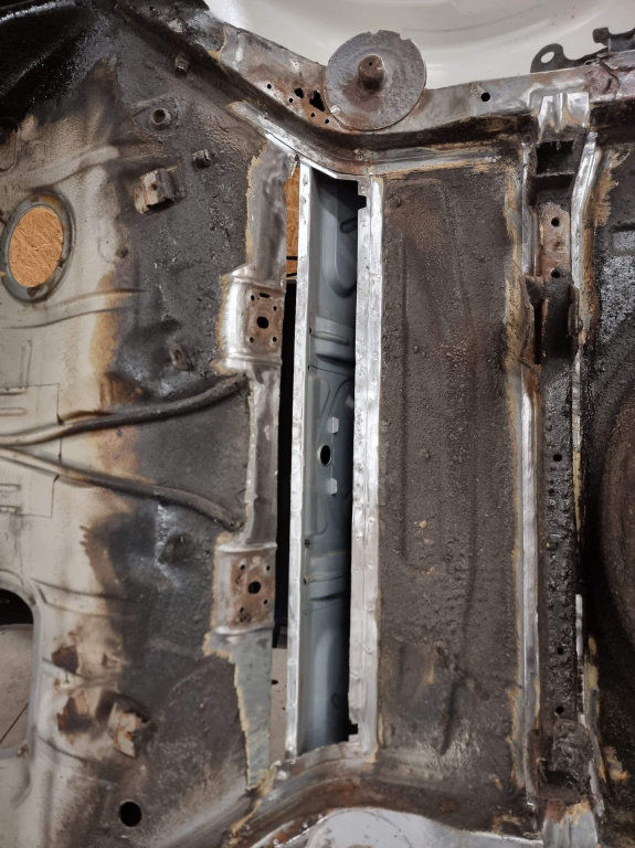

                            So, I just realized that I haven't updated this thread for ages. That doesn't mean that nothing has happened though!
                            I lost my patience with the first body guy and hence found another. He is an absolute BMW E30 freak himself, and I think he has done an excellent job so far!
                            To sum up the last two years:
                            - More rust fixed
                            - Bought/pieced together a complete OEM M-Tech 2 kit with clips, drilling templates, etc.
                            - Bought 7 OZ Vegas in 8x16 and 9x16 (5x120).

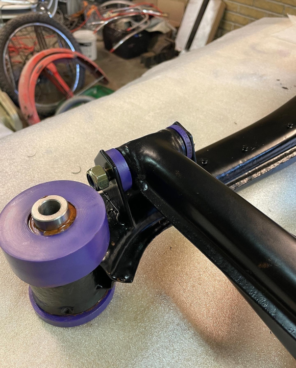

                            - Blasted and powder-coated most of the suspension components in satin black.
                            - Got the car up on a rotisserie

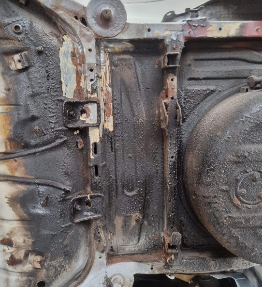

                            - Cleaned the complete underside (nightmare..! Took me 6 months of late nights).
                            - The front support got replaced too due to rust
                            Unfortunately, the car had some more rust revealed after cleaning it and that's basically where I'm at right now. However, its minor areas. Mainly around the spare wheel well.
                            Images are not in the correct order - that would just be too time-consuming :-D
                            Enjoy!

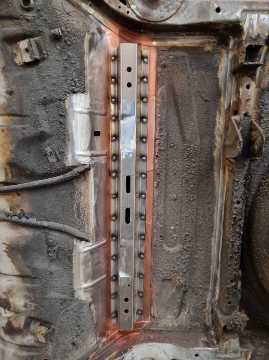

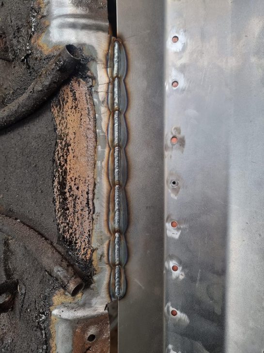

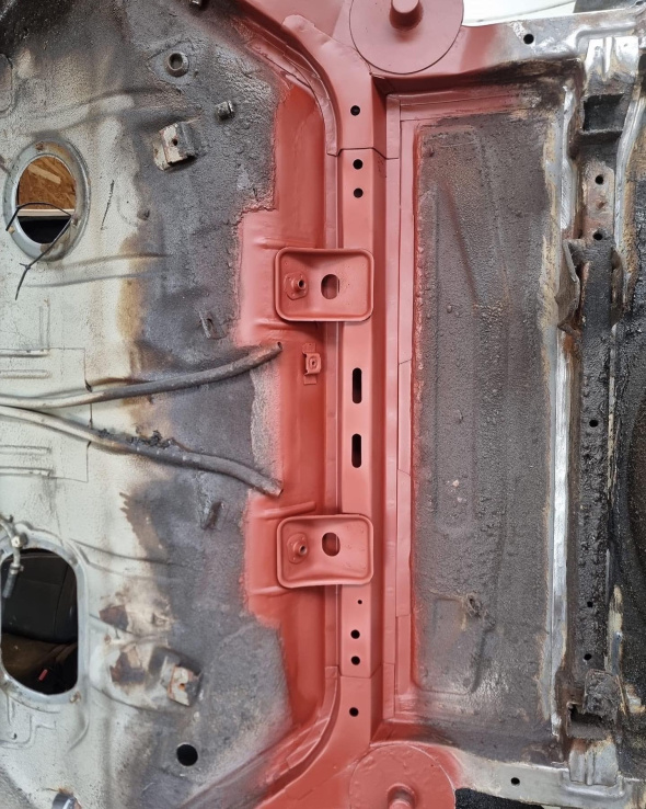

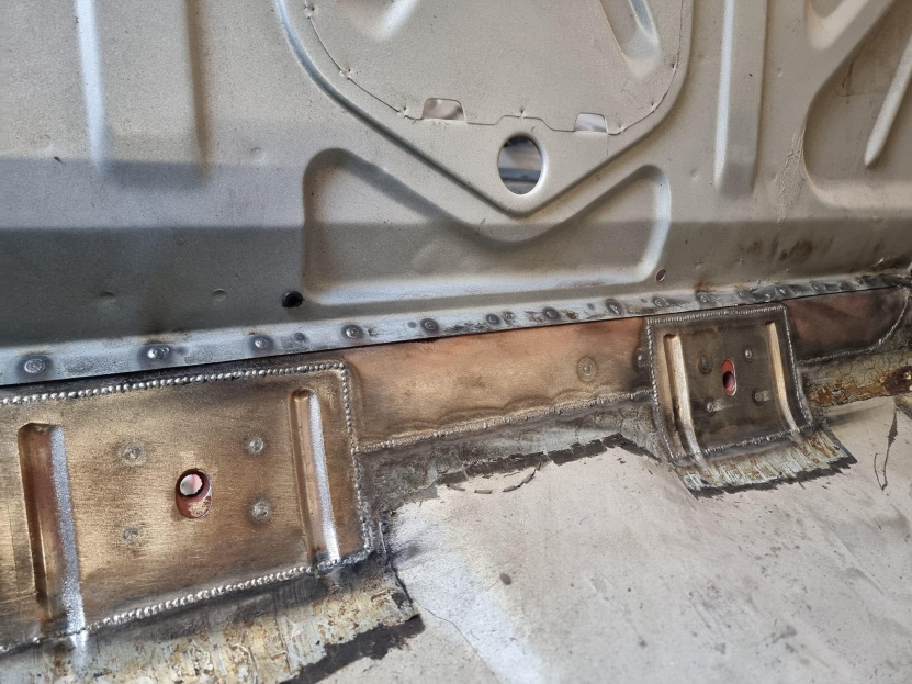

                              The car had some serious rust in the rear, but luckily the body guy nailed it. Think he did an awesome job here.
                              He also fixed the frame wails and spring perch.
