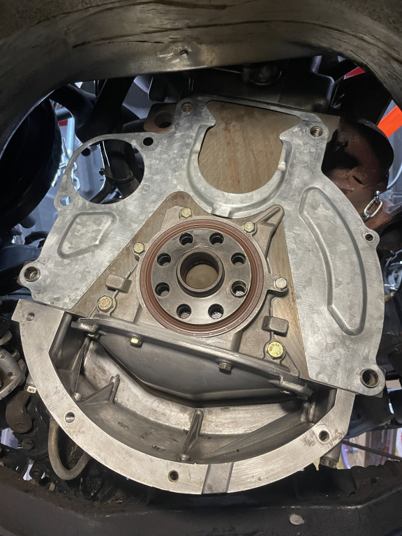

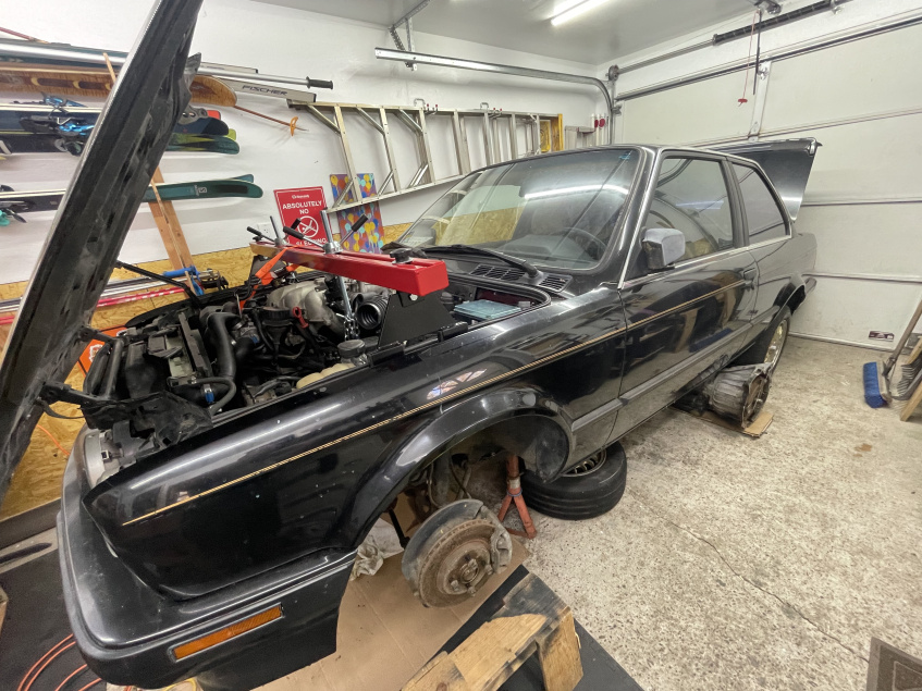

                Well I haven’t updated this in awhile as I haven’t done much work to the car, since I moved. I couldn’t get the car registered yet because it had a massive oil leak. Figured I would address it when I eventually did my manual swap. So…’ I FINALLY got started on the manual swap. I have been doing a little bit at a time at night. I just finished resealing the pan and a new rear main seal.
                All the automatic crap has been removed and now I’m about to get the manual transmission I have been storing for 3 years. Slow moving project that I wish I had more time for but it’s slowing getting there. Having the manual swap out of the way will be the biggest thing. Hopefully get it registered then address smaller projects I have plans for.

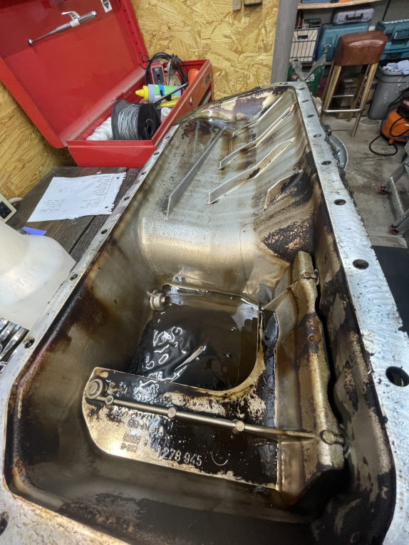

                  Some pictures of the pan full of sludge, cleaned the HELL out of it and a ton of gunk off the engine block. Ended up dropping the sub frame a little bit and lifted the engine 3-4 inches. Made removing the oil pan super easy.

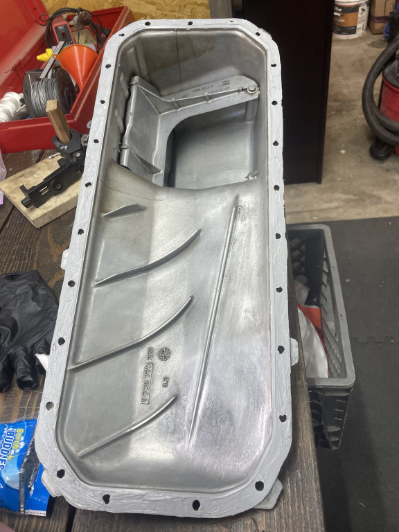

                    That pan looks brand new!
                    How did you get it so clean? Parts washer?

                      I just scrubbed it with dollar store degreaser, these dollar store scrubs (work great on thick engine grime), and 0000 steel wool.
