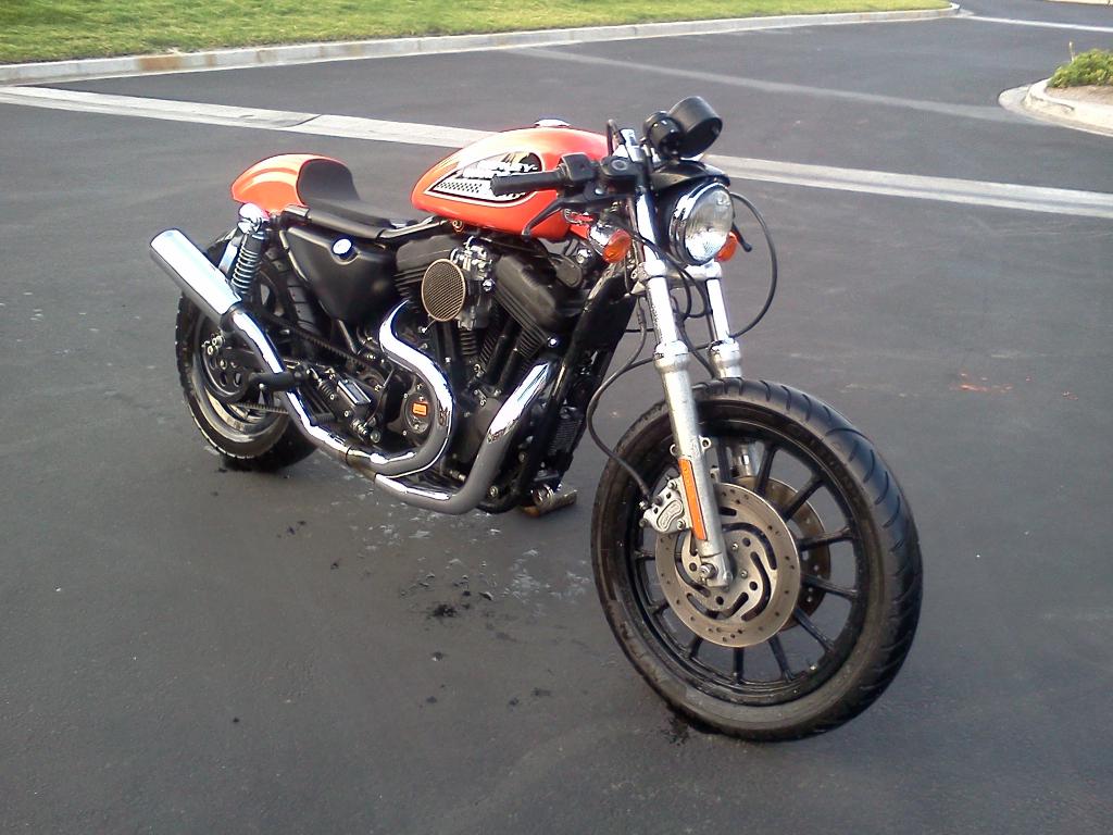

                        Picked up my canvas today!! '99 Sportster 883.
                          Yummy..
                          I could chop about 60lbs off it as it sits..!
                          Wake that little motor up..
                          Best bang for the buck: A hot set of Andrews Cams
                          DynoJet jet kit for a "1200" trust me!
                          DynoJet Plastic CV slide "ThunderSlide"
                          Find a nice 2-1 exhaust...
                          Should Net you over a 20% gain in HP
                          And if you got any cash left find a nice
                          Screaming Eagle IGN advanc & Rev Limit Kit
                          6800rpm
                          This will change the whole attitude of the motor! :twisted:
                          ( Oh Shit Edit! I have a Tuned CV carb with thunderslide and two extra jet kits if interested )
