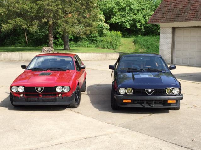

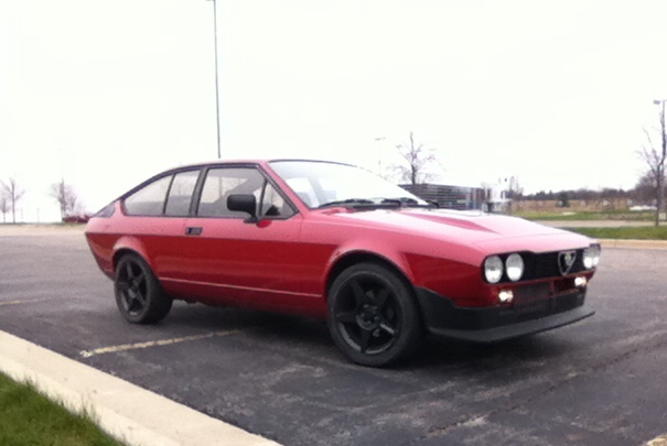

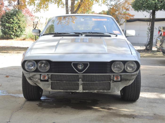

    Whoodathunk that car could look like this?! Quite a rescue, good work.
    Pics!
    These are cool without all the plastic on them.

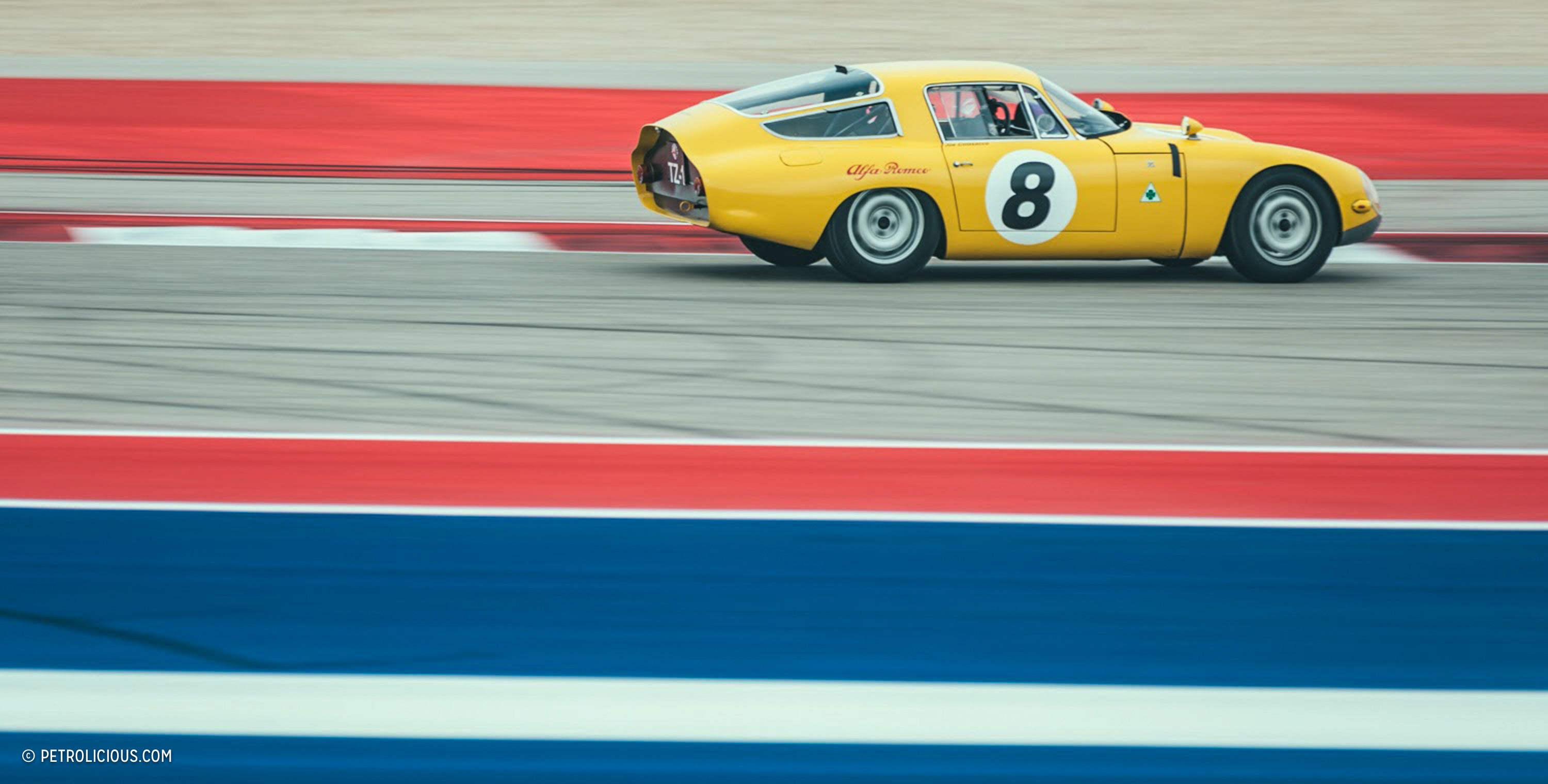

                Petrolicious feature on a vintage racing TZ. I've been scolded recently by an Alfa guy from Europe that there is no "TZ1." There is a "TZ" (Giulia Tubolare Zagato - Giulia based, tube chassis, shape designed by Zagato), and the later "TZ2."
                Whatever...here it is...
                Our photographer Will Mederski spotted this stunning TZ1 screaming around COTA a few weeks back. Normally we need a change of pants any time we even get near one of these things, but this one was special. It wasn't a garage queen or a back of the packer. It was being driven properly by somebody who was deeply passionat
