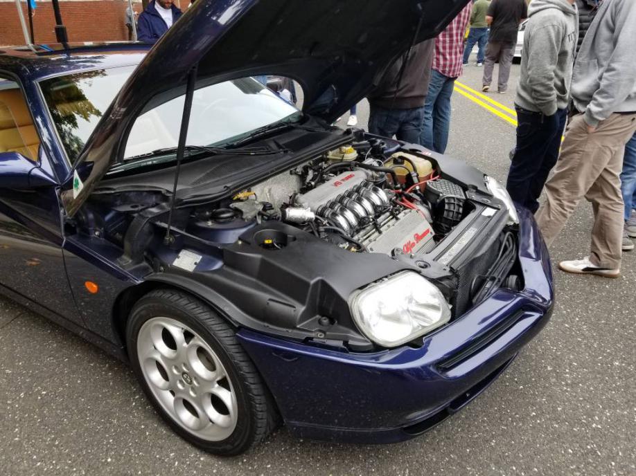

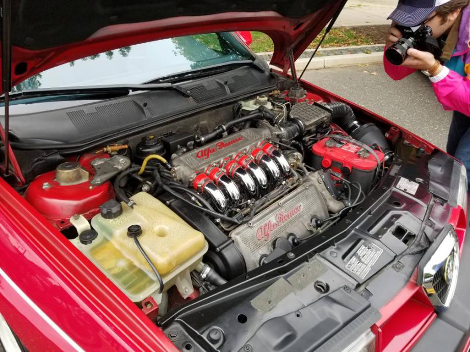

    From RADwood Philly yesteday Click image for larger version
ID:	7198025Click image for larger version
ID:	7198026Click image for larger version
ID:	7198027Click image for larger version

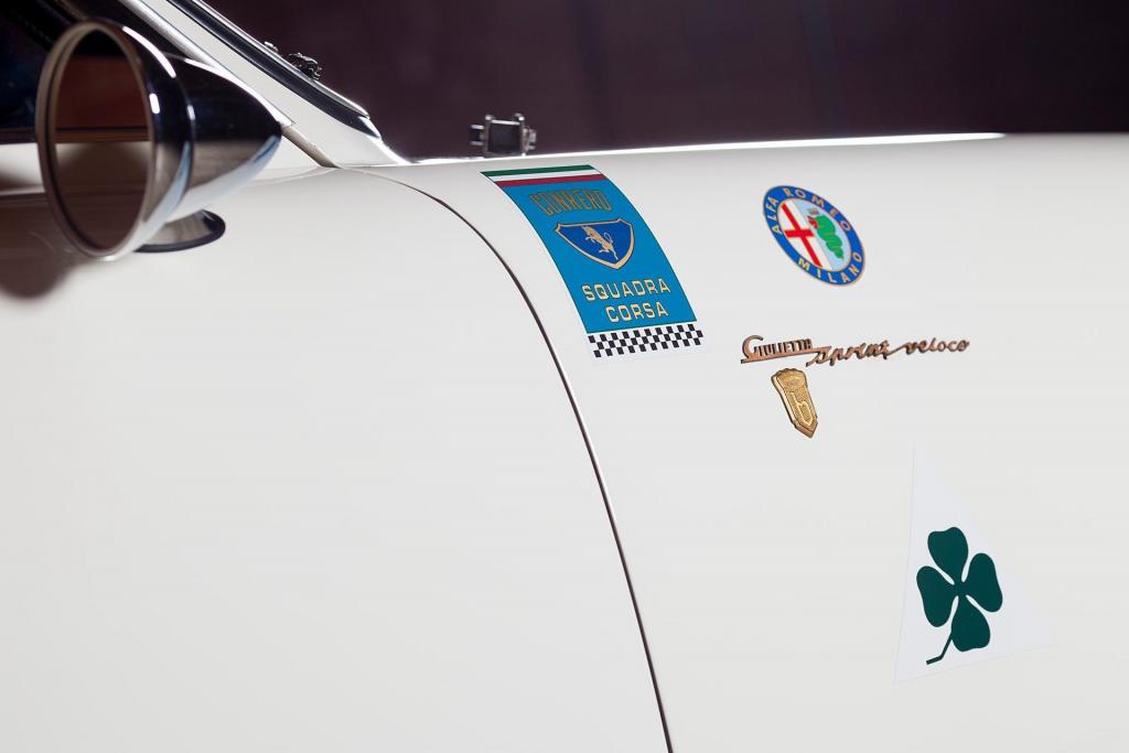

        1959 Giulietta Sprint Veloce.
        I like the way this car sits.

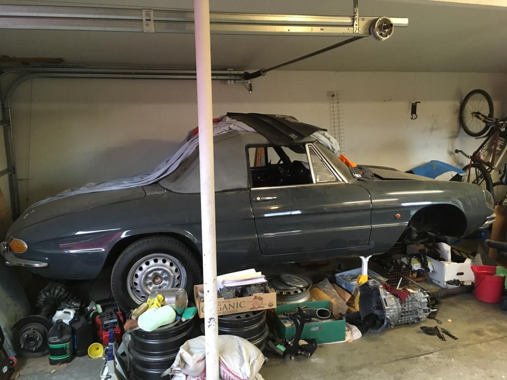

            My current status hasn't changed much.
            (Note new rear axle sitting on the floor, yellow springs, no front suspension, Webers in a cardboard box, as well as an E30 transmission waiting it's turn)

              damn kids and family taking up all your car time!

                And now it's getting cold out there!
                Every time I get thinking I can start again, one of the other cars f's up and I'm under it trying to learn how to fix it. Thank gawd for forums and helpful people who know what they're doing!

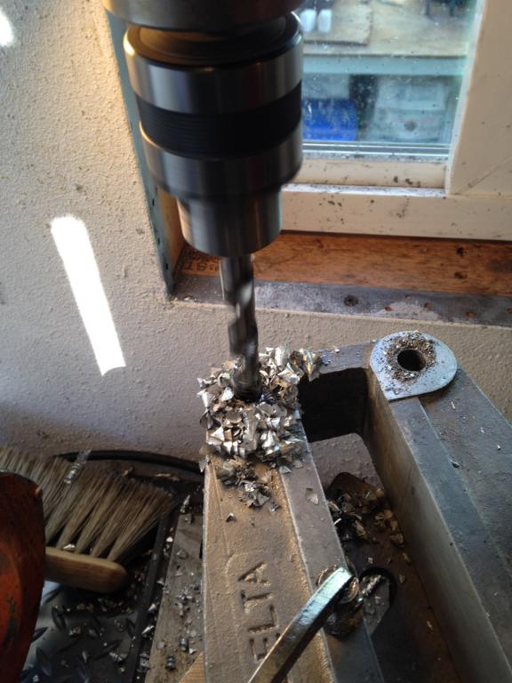

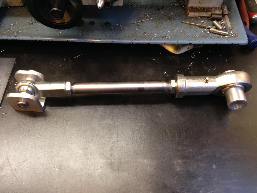

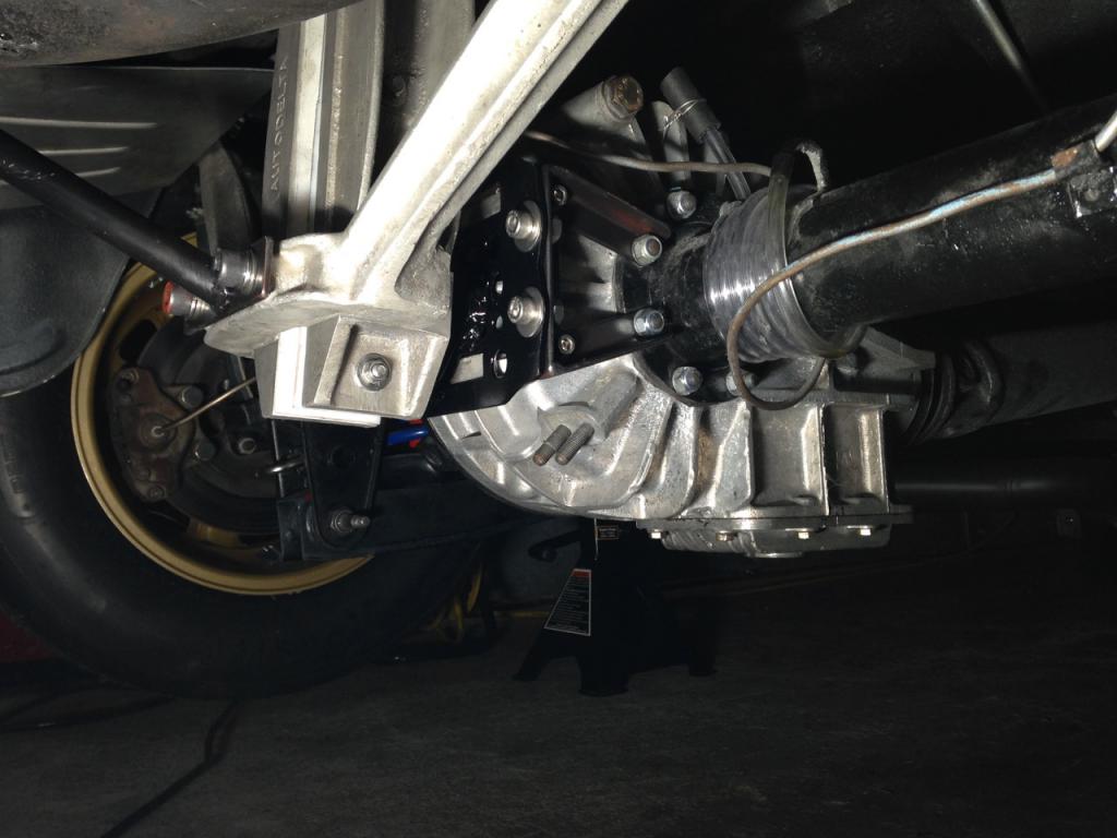

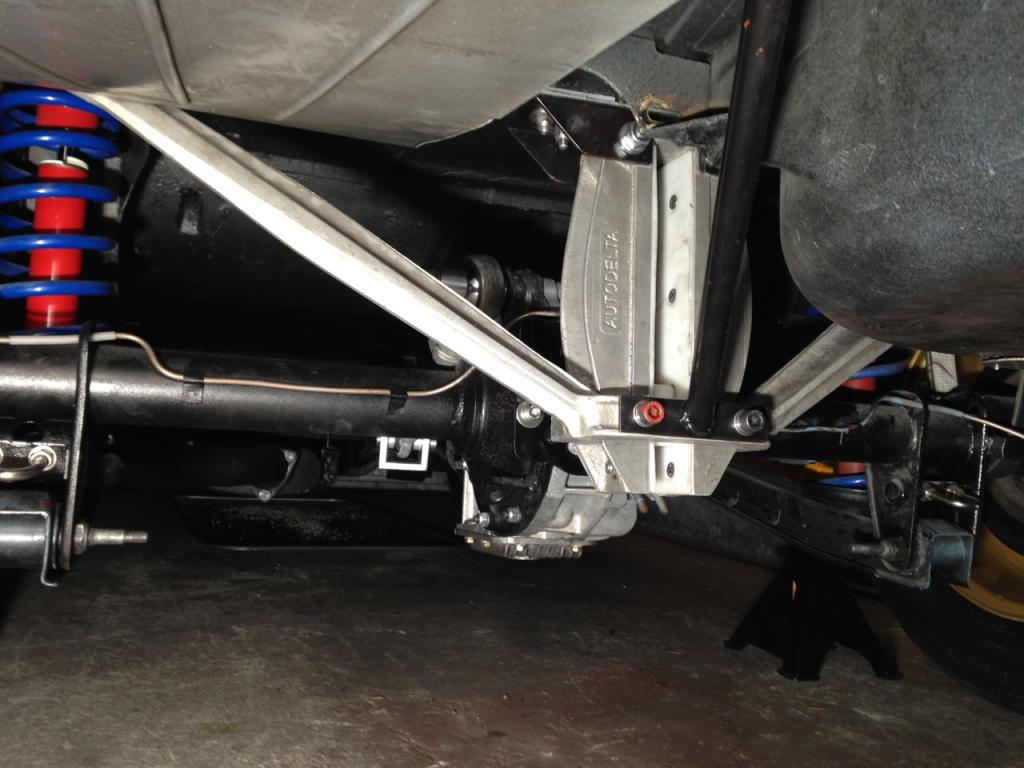

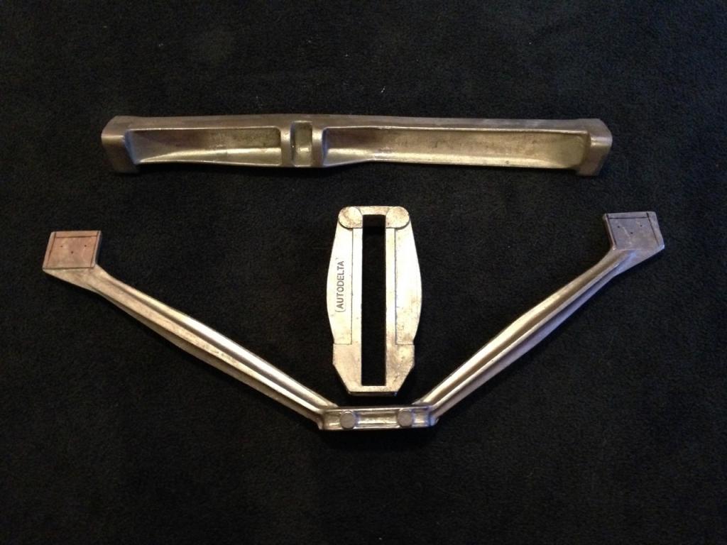

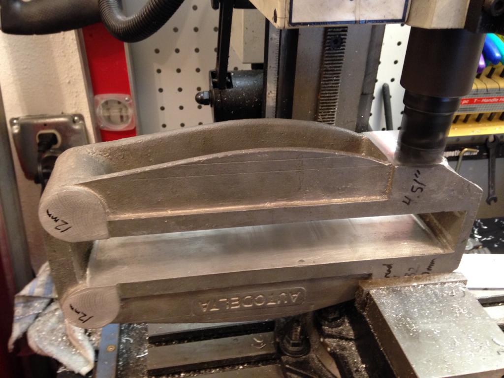

                          Some details of the modified sliding block I installed in my race car a few years ago. I fabricated the bracket to mount the sliding block's peg on the diff housing. I also made a titanium trailing arm for the diff that mounts directly to a reinforced rear bulkhead.

                            A real Autodelta sliding block. I don't even want to know what that set you back. Nice setup.

                              No, not an original. I got lucky and bought a good casting of an original. Then I took it to a foundry in Seattle to get it heat-treated. Had to face it, drill it for bolt holes, etc. Lots of nerve-wracking work, many hours spent. Never had to use the trunnion bar since I mounted the trailing arm directly to the rear bulkhead.
