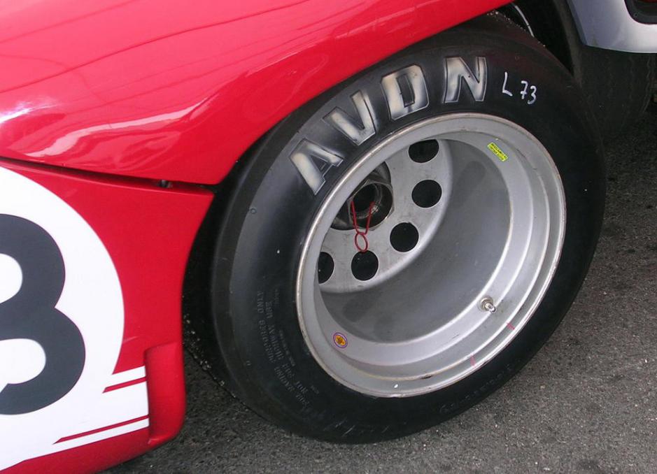

    ^^^ I like those. Are those the metric wheels that you can only put a specific metric Michelin on?

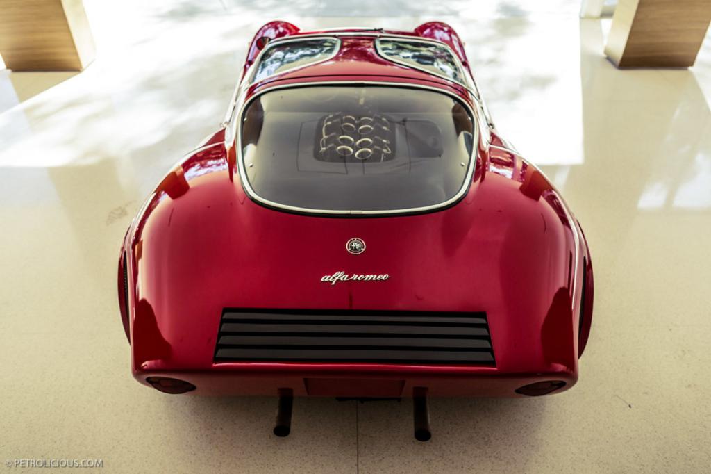

            #2075
Name:	Alfa Tipo 33.jpg

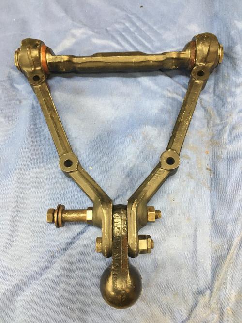

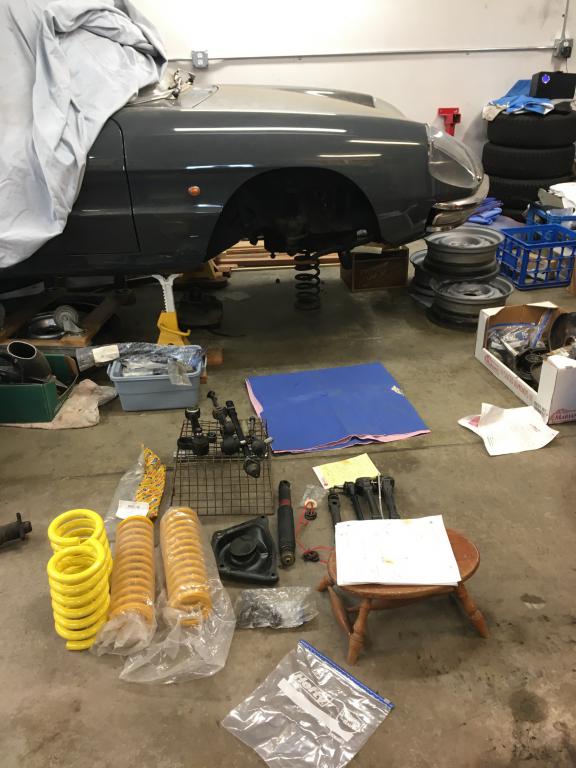

                                Actual reassembly work has begun in my now bright garage. Fun to be out there working on something besides dailies. It's like reconstructing a crime scene, figuring out all the boxes of parts, figuring out what's cleaned and painted so far, which are the missing bushings, and wondering what those E30 parts are doing under there. I'm wire brushing, degreasing, priming, and painting parts and the cross member. Just chassis black, no powder coating for this car. I have new rebuilt calipers, but decided the new old stock (20 YEARS old) brake hoses should be replaced.
                                I'm excited.
                                . Click image for larger version
                                One done, one not.

                                Adjustable upper arms.

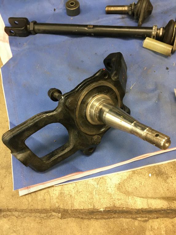

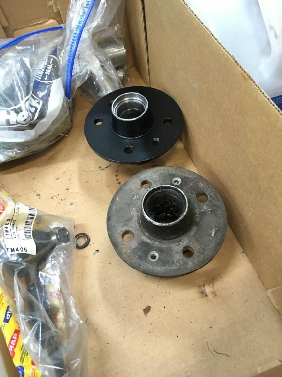

                                Later model 70's 2-liter uprights hold bigger Ate calipers. I had a Speedi-Sleeve pressed on over a good groove in the oil seal surface.
