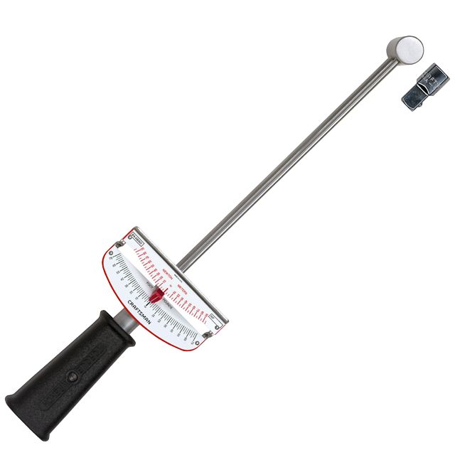

                              Sort of OT....which do you prefer/find most accurate?
                              A) Beam type.
                              B) Click type.
                              C) Electronic.
                              I was always told the beam type was used to calibrate the click and electronic types....buttt, the click is preferred, especially for automotive apps, as long as it's calibrated properly.
                              Thoughts?
                              Recommendations?
