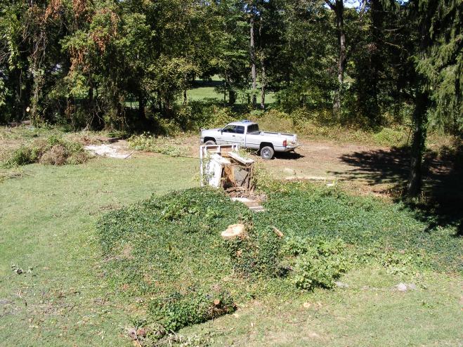

          We've been doing a bunch of land clearing. I had to take down about six trees to make room for the garage and the driveway. My brother and i have spent the last three weekends removing trees and brush, and we have had a massive bonfire going every weekend. The guy doing the grade works will be dropping of equipment tonight and grading this weekend. I should be ready for the builder by next weekend. Theres a lot of work that has been done you cant see in the pic.

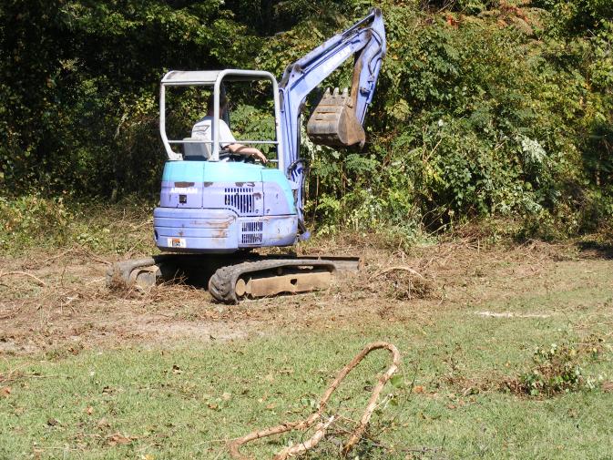

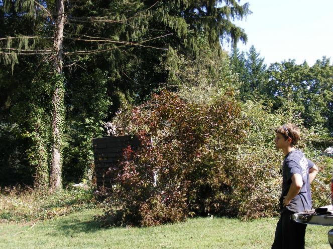

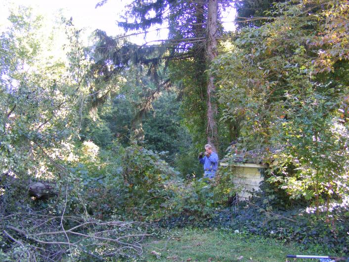

            Here's a couple more pics of us clearing the trees and the brush from the side of my yard where the garage is going. We used my fathers mini excavator to do a lot of the work. I'm hoping the rain holds off long enough to get the rest done this weekend. If all goes well this weekend i'll have the material for the building dropped off next week, and the builder will be in shortly after that.

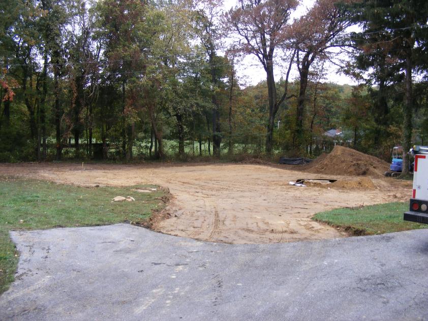

              Site is ready for the building. Stone is being delivered for a temporary driveway for the construction workers. Building materials should be dropped by the end of the week. Hopefully construction will start by next monday.

                        i'll try to get on there later and create a thread. I've been so busy between work and trying to get my yard prepped for this building, I haven't had much time to do anything. My e30 has been down for two months now. I've been gathering parts for a rebuild, but i don't think i'll be able to put it together until my garage is up. Here is a pic of the entry to my driveway, the cleared area in the back is for the building (40x50) and the front portion is going to be the new driveway/basketball/bicycle area.

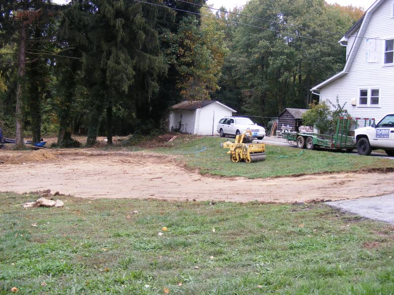

                              I got some crush and run (driveway base/stone). Two triaxles showed up this morning, got some work to do grading it out for the construction driveway. I'll try to post a pic later.
