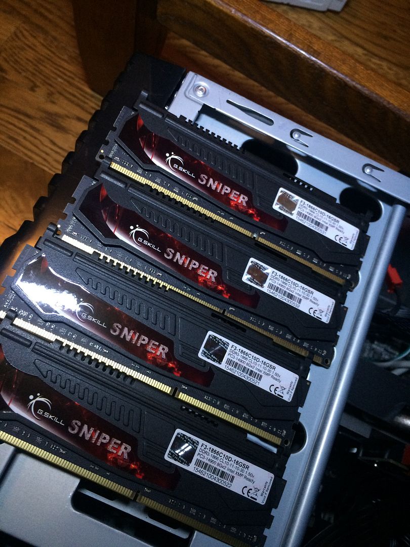

            Originally posted by Wschnitz
            You can probably make it quiet just by getting some decent "noctua" or "be quiet" fans instead of the stock ones.
            the 32GB problem is probably your motherboard config, go into bios and check it out. Might not be set up for 32gb.
            Also rip FX 6300. Save your pennies for the 8350.
            I figured out two of my fans are only 3 pin, so they run full bore from boot up! I'm thinking about buying a new silent style case with some noctua fans.
            I tested all 4 of the 8gb sticks and they all boot up and are recognized, so I don't think any are bad, but once I put the 3rd (and 4th for that matter) stick in, the BIOS only recognizes 16gb, and windows shows whatever ram amount is plugged in, but says only 16gb is in use. Not sure why it's doing this.
              Did they come in two separate packs or one big pack?
              If you are getting 16gb it could be that you have configuration wrong. Sticks come in pairs usually from what I remember, which means they have to be in their respective DIMM slots.
              So one pair in the 1 and 3 slot, another in the 2 and 4 slot.
              The other thing It could be is your BIOS isnt updated to latest version.
                i returned like 6 sets of ram before i sheepishly learned this.
                          Two separate packages, but identical sticks.
                          I have a feeling that my BIOS isn't in complete agreement with the ram, but it's still all a foreign language to me, not too sure what to change. I'm learning though!
                          The BIOS version is the most current, checked that already. Would the procurement method of this win 7 ultimate cause these problems?

                            #658
                            No OS shouldnt matter as long as it supports 32gb+
                            Try doing the paired slots thing, put the two that end in 0521 and 0522 in 2 and 4, and the 0532 0531 in 1 and 3.
                            Could be your ram slots are dead but I doubt it, after doing the above try one ram stick in each slot and see if you run into an issue.
