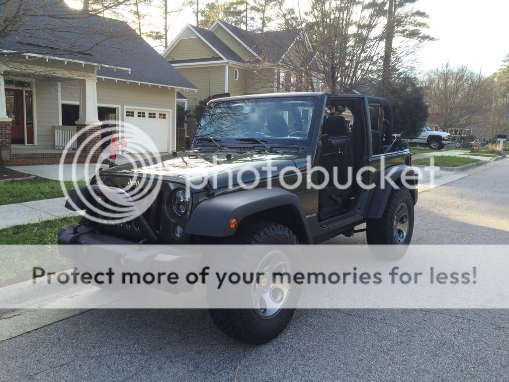

    Gave my Rubi the semi yearly wash

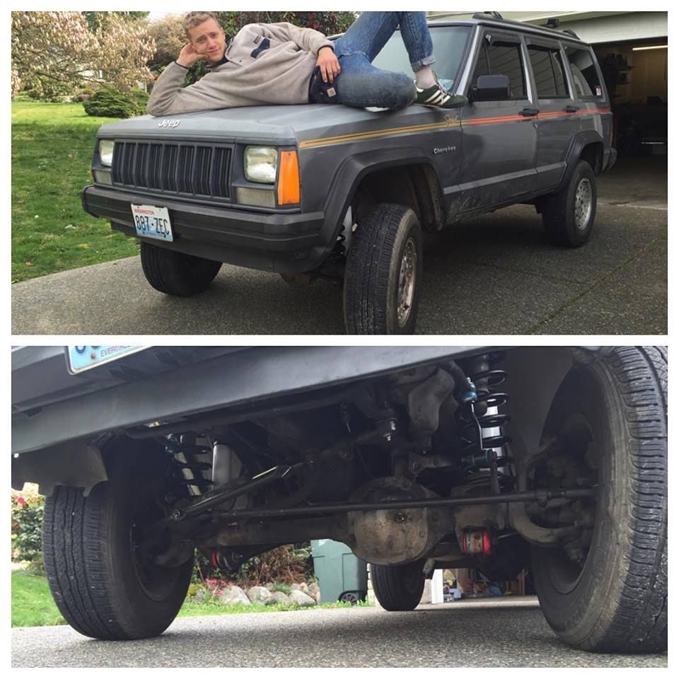

                    My little brothers first car. '91 XJ Sport with the L6 and an auto trans.
                    We started with new gaskets for the valve cover, oil pan, and rear main seal. Did all the filters and an oil change and fixed the little electrical thing on the trans that turns on the reverse lights. We also wired up some LED revers lights that can be turned off, on, or just on when in revers.
                    Then we did a 3" Quadratec lift with some Energy Suspension bushings front and back and all new steering components. Next up is a set of 31x10.5 tires. Hes also working on a new headliner by himself.

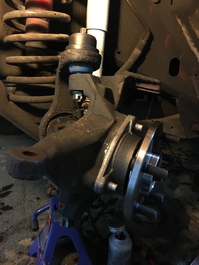

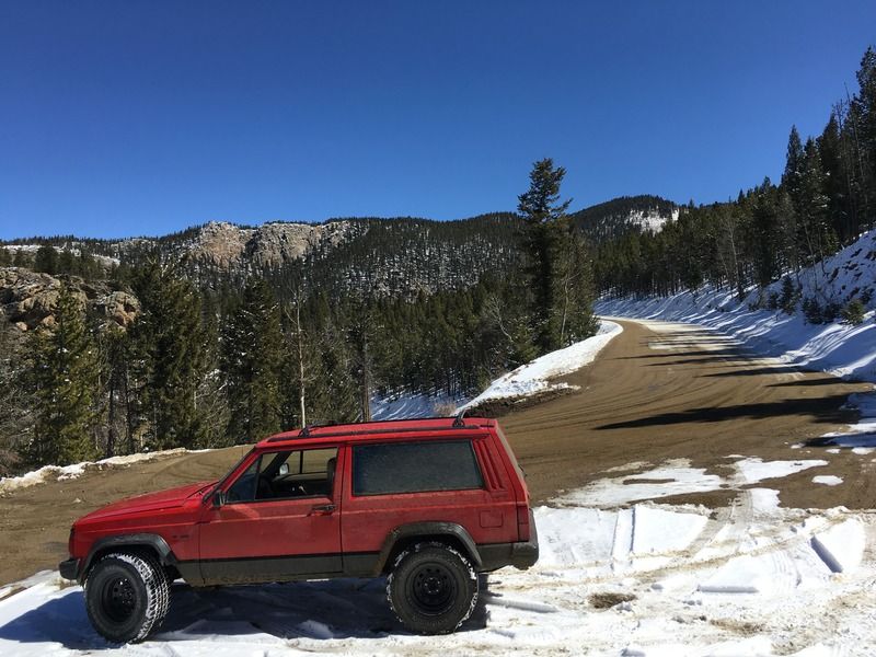

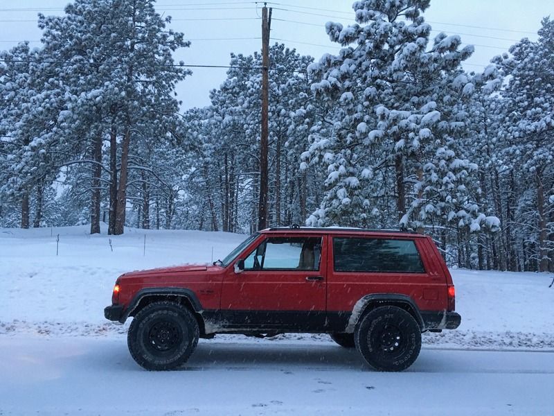

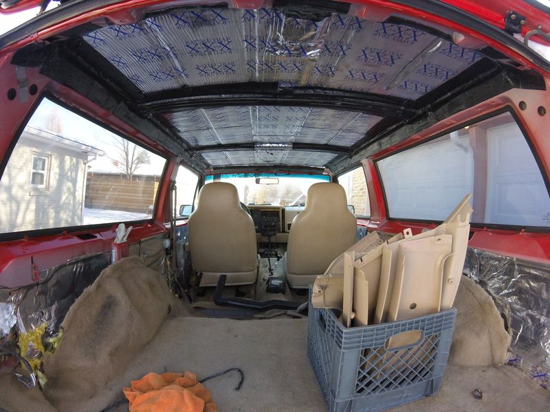

                                Picked up this a few months back for a project. Now has taken daily duties since my CRV was stolen.
                                95, I6, AW4, NP231. So far it's a beast I'm starting to really the thing.
                                All stock aside from 31's, rolled fenders and trimmed factory flares. Done quite a bit of maintenance on it and it's driving much better. All new ball joints, wheel bearings and tie rods going on this weekend.
                                PO had done some work and replaced the cooling system with a 3 row alum radiator and a couple crappy e-fans run off a probe thermostat. Was still getting pretty warm in traffic so I went to a junk yard and picked up two factory e-fans with shrouds. Have one installed and it's noticeably much better. He also installed sound deadening floor to ceiling and filled the rear quarters with expandable foam which has been seriously annoying to re-fit the rear panels. Otherwise is a really solid truck, 0 rust and minimal body flaws. I'll probably keep it for awhile.
