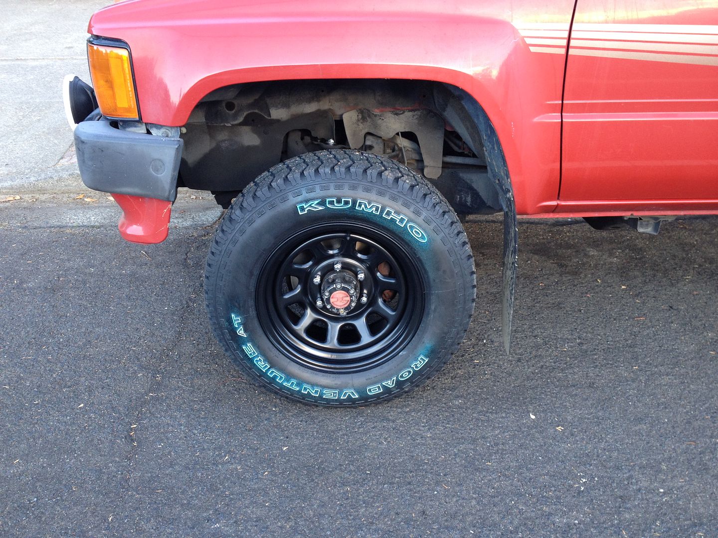

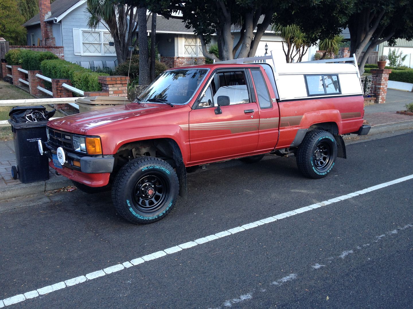

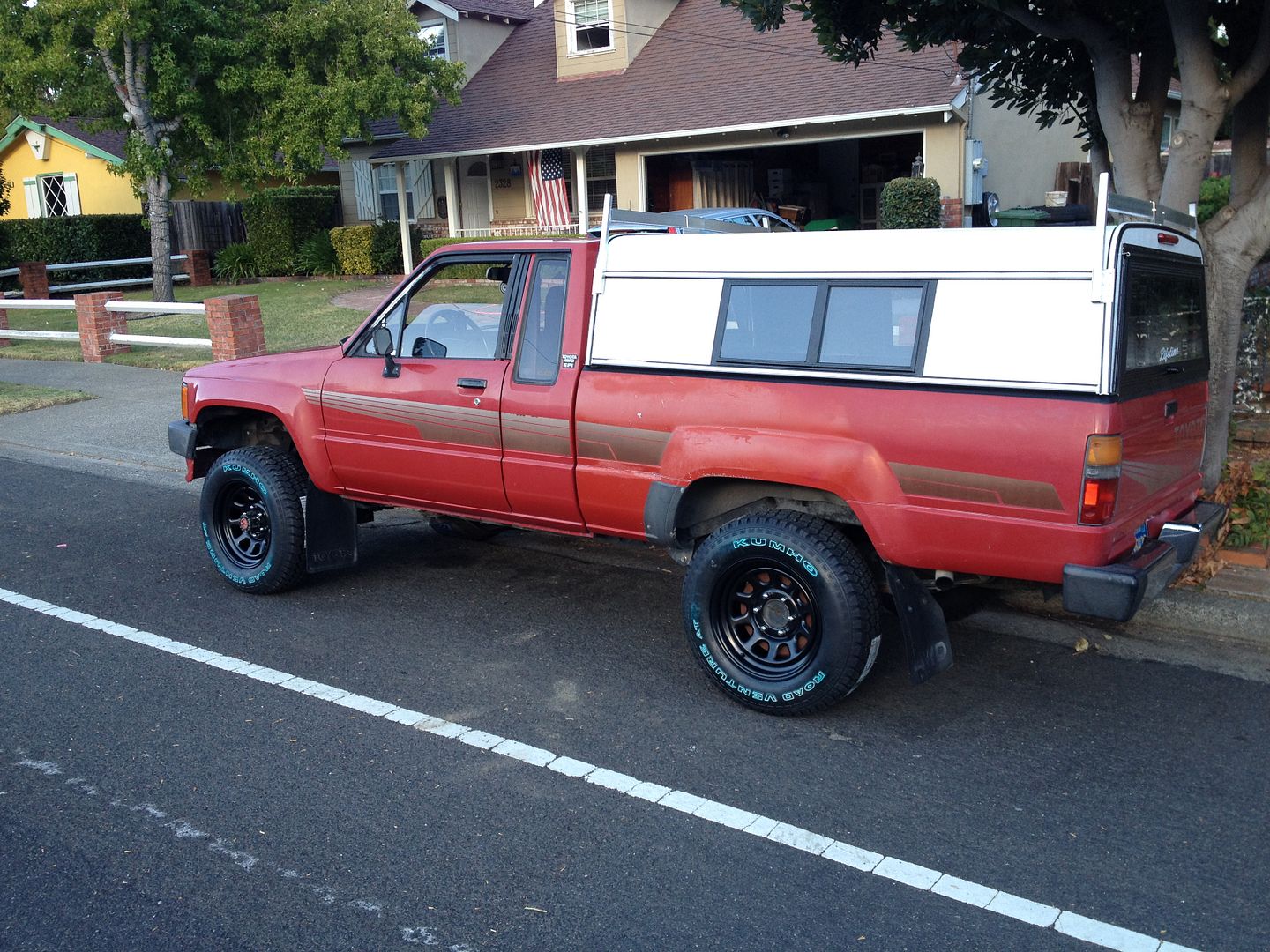

              Got my new wheels and tires a day early :)
              Not so happy about the lettering. I thought the letters would be white so I had them mounted facing out. Instead they were a weird turquoise and the paint is everywhere. I am going to have to clean that up some how.

                  Supposedly it scrubs off and is just a protective coating.
                  • Rede30eS
                    • Jun 2008
                    • 110
                    #69
                    Yes, scrub your tires gents. The blue stuff comes right off. Actually the tire shop should have washed it off for you.

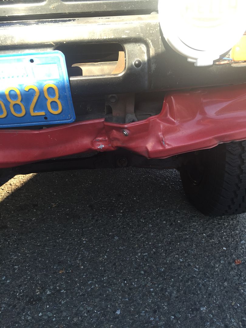

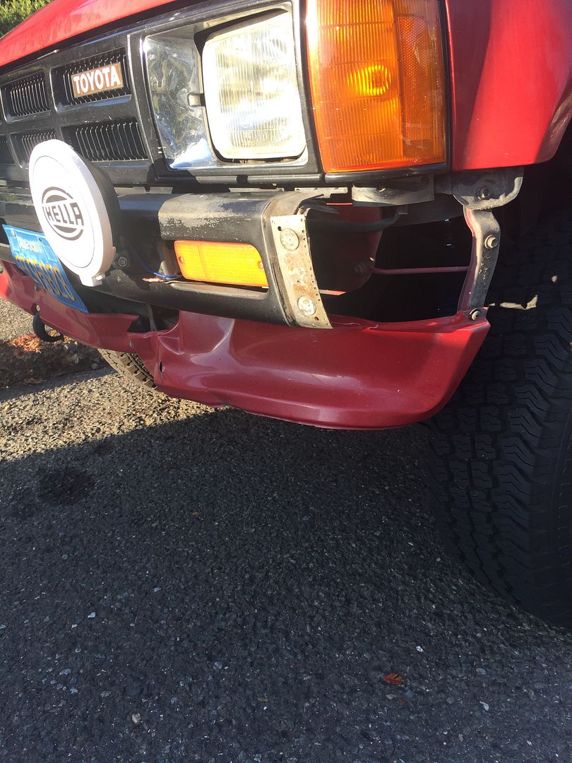

                              Bad day for the truck! It got in a fight with a Chevy's ball hitch and got hit in the face. Well really the Chevy got brake checked, which meant I got brake checked and even though I had a good car length between us I still slid into him.
                              No real bad damage I cant fix.

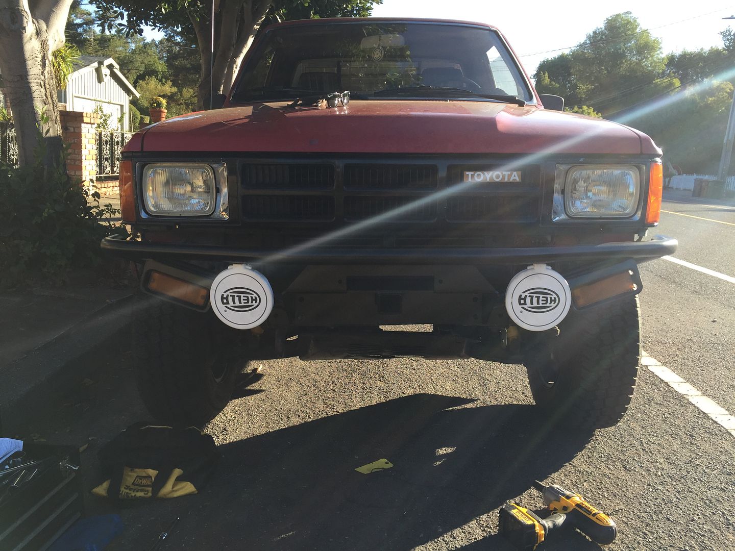

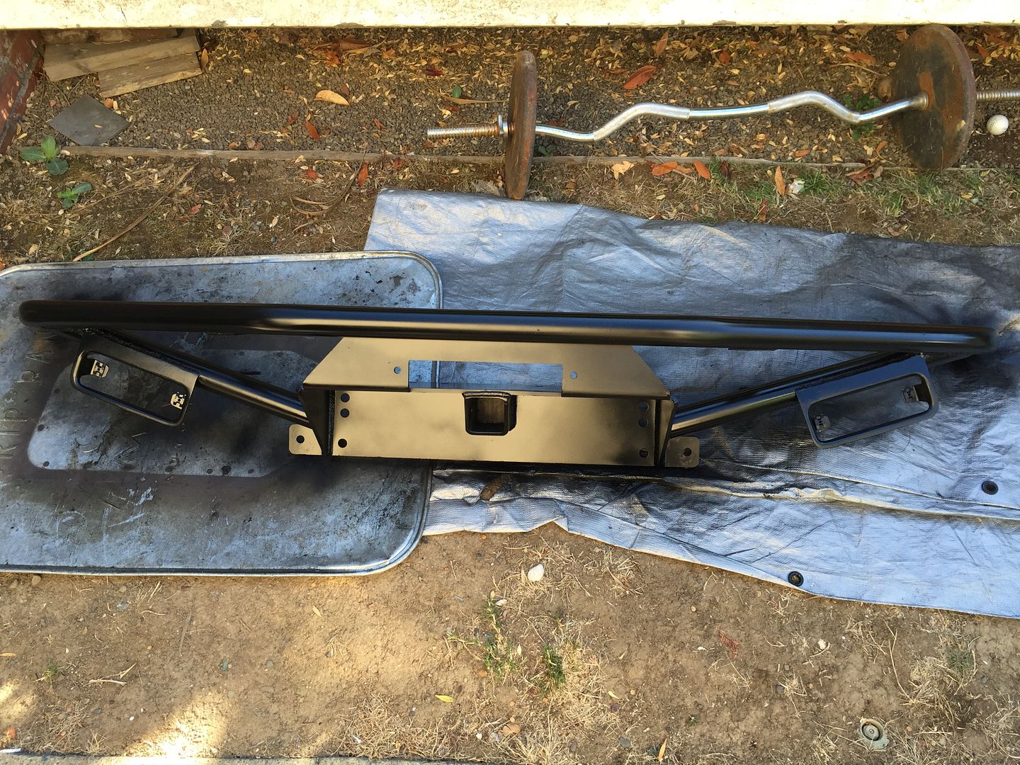

                                I did some wor on the new bumper today. I like it.

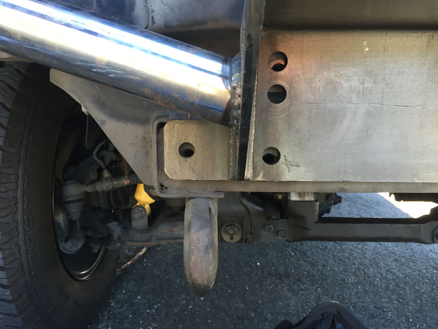

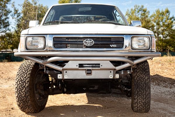

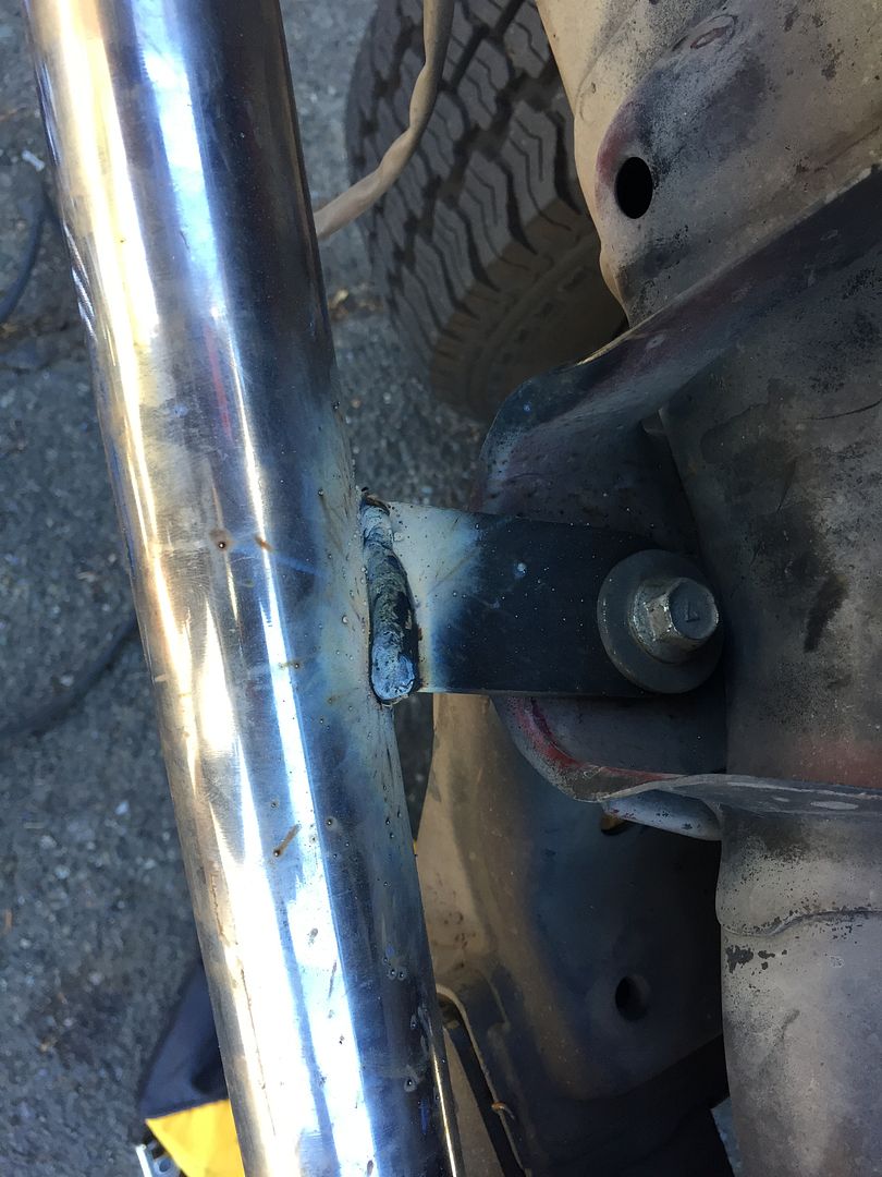

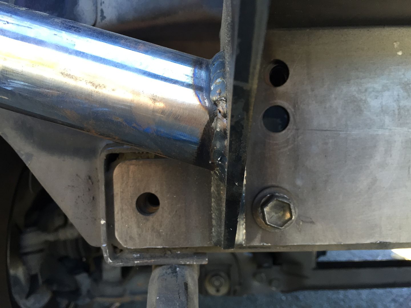

                                Its a Trail-Gear bumper. All the welds are really nice, but the mounting hole locations are a bit off. I dont know if its my truck or their work. Some of the holes line up fine, but others are off by a lot. The two tabs that stuck off of the back and mounted to two point above where the old bumper used to be were so off I had to cut them off and weld them back on again. This got all the holes a lot closer, but I still have to take my die grinder to a few of them to get the bolts to fit through correctly.

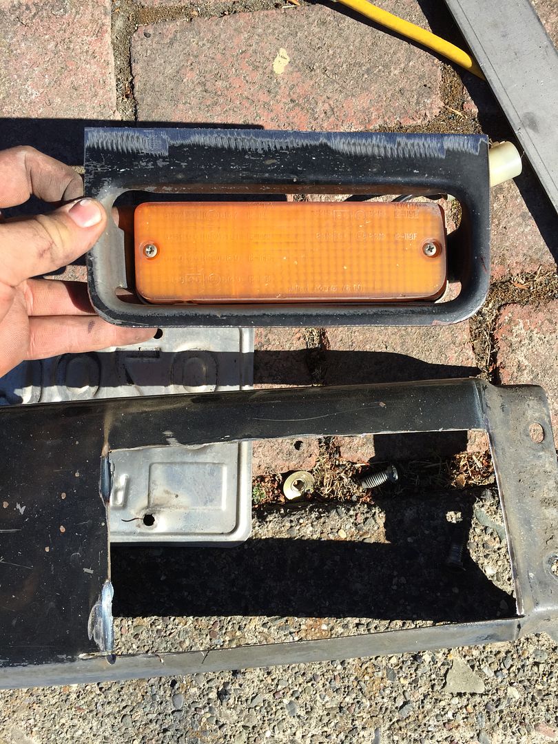

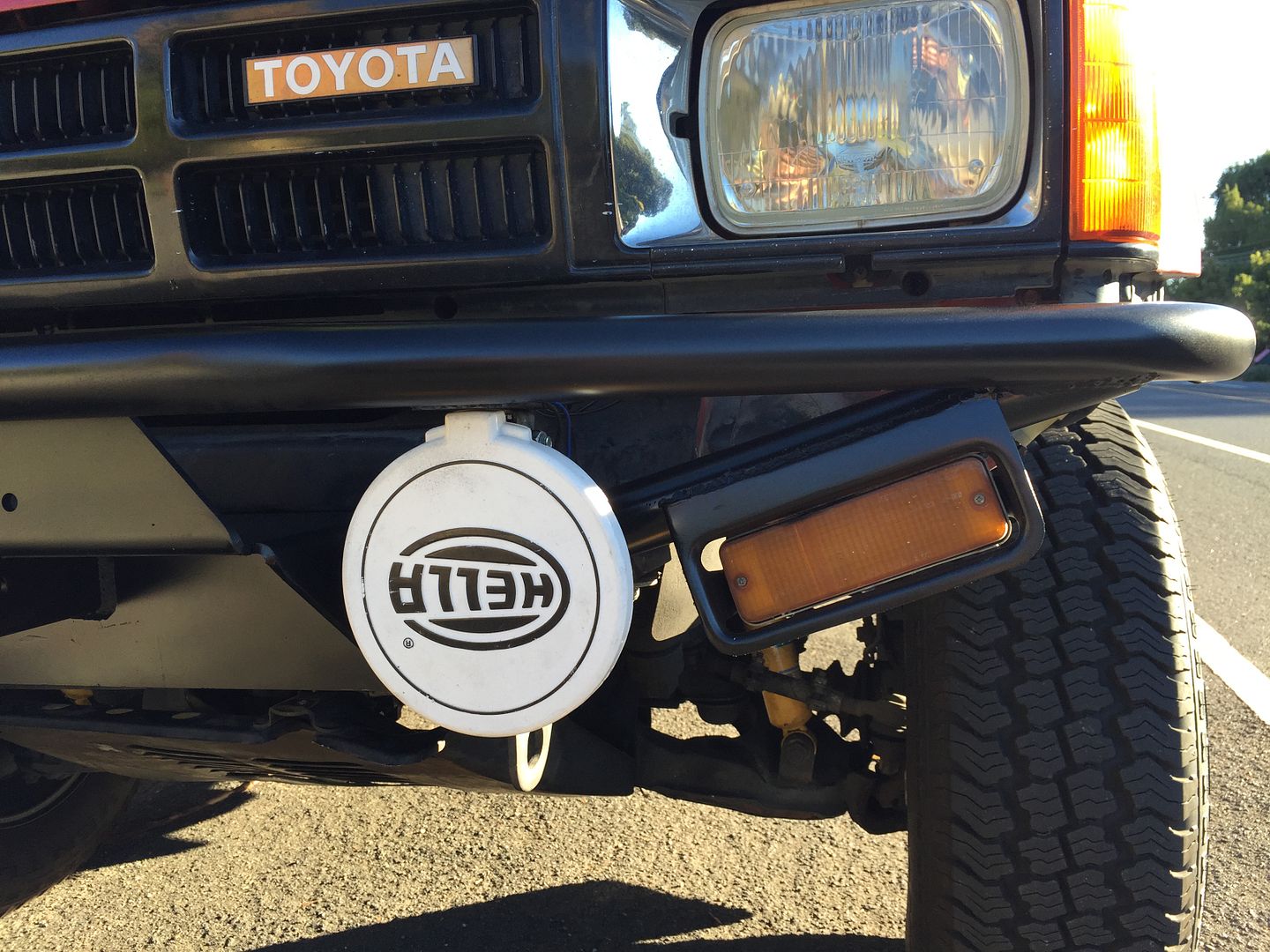

                                I cut the mounting locations for the turn signals out of the bumper, modified them a bit, and welded them to the bumper. I also added mounting tabs for the fog lights. I think it turned out well.

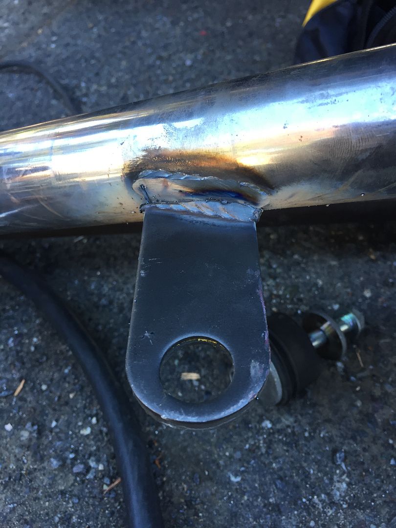

                                These are the tabs I had to cut off and relocate.
                                Here you can kind of see where they used to be. They moved up about 3/8" Id say. Excuse the messy welds I only had flux care around because my friend left my tank on and all the gas leaked out. Not happy about that.
                                This was before I relocated those tabs.
                                This was after. Definitely closer.

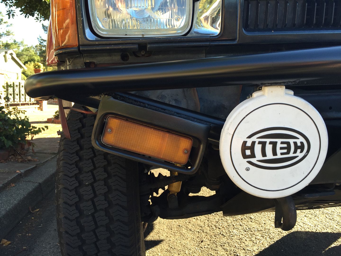

                                Here are the turn indicator brackets I made out of the original bumper.
                                And mounted.
