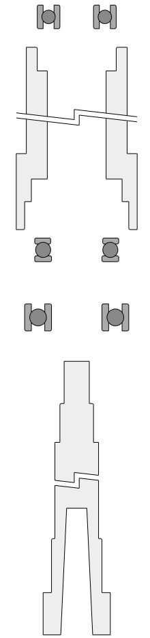

    Here is a quick diagram of the assembly I am describing. Things are to-scale in the dimensions that count.

          The diagram is not 100% accurate either. The bore for the 6204 in the quill is actually ~2mm deeper than the bearing's thickness. This makes it easy to deal with the axial thermal expansion/contraction if I cool/heat things for assembly.
