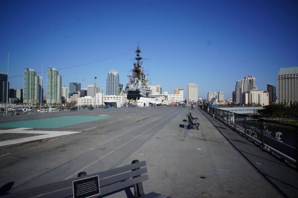

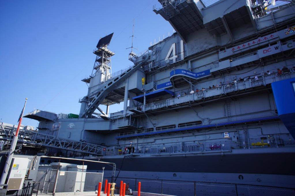

Originally posted by Herr Faust Schinken View Postive been to the midway it pretty impressive
